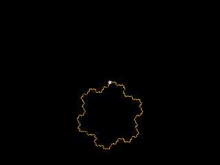

I've been toying around with fractals again.  My latest investigation is the
Gosper Island.  I had been thinking of using the fractal as a tile, but I'm
having trouble locating the center.

The problem is that as epsilon gets smaller, the fractal seems to rotate about
the origin, and I'm not sure why.  I don't have the time to dig through the
calculations, but I suspect that it has to do with where the recursion stops.
If anyone can help, I'd appreciate it.
A.D.B.
