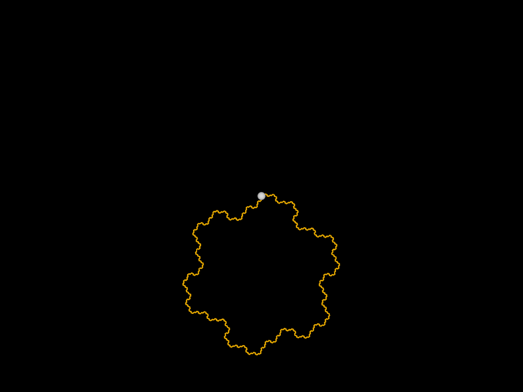

I've been toying around with fractals again.  My latest investigation is the
Gosper Island.  I had been thinking of using the fractal as a tile, but I'm
having trouble locating the center.
I'm using my logo macros to generate the fractal.  The file is included below.
#macro triline2(len, epsilon)
#if(len < epsilon)
    fd(len)
#else
    lt(acos(5 * sqrt(7) / 14))
    triline2(len/sqrt(7), epsilon)
    rt(60)
    lt(60)
    rt(acos(5 * sqrt(7) / 14))
#end
#end
// Gosper fractal can tile the plane
#macro Gosper(len, epsilon)
#local a = 0;
#while(a < 6)
    lt(60)
#local a = a + 1;
#end
#end
init()
Gosper(2, 0.01)
The problem is that as epsilon gets smaller, the fractal seems to rotate about
the origin, and I'm not sure why.  I don't have the time to dig through the
calculations, but I suspect that it has to do with where the recursion stops.
If anyone can help, I'd appreciate it.
A.D.B.
P.S: as a side note, it might be neat to have some of these fractals like the
Koch flake and the Gosper island available as patterns in a later version...

Download 'koch.png' (21 KB)
Preview of image 'koch.png'
