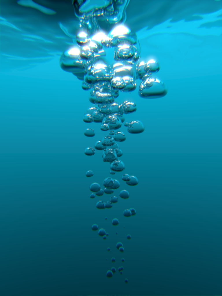

High! :-)
This is just a quick test of an idea I had for underwater air bubbles.
There's a point set of 4D vectors containing bubble positions and sizes. For
each
bubble there is a blob. For each blob all other points are tested, and if
another
bubble comes close to the current bubble, a blob is subtracted from it. A
duplicate blob is also subtracted from underneath each bubble. Parse times
aren't
so horrible for low-count point sets (<250), and the render times aren't bad at
all.
The first part of the basic idea came from someone from these newsgroups, but I
can't remember who it was :(
The initial render (/the/ render) took less than 50 seconds with max_trace_level
set at 10. In-POV post-processing luminous bloom and chromatic aberration
effects
were applied. Textured fog was also used.
The arrangement of the bubbles was the hardest part, as there needs to be a
logical progression of large->small bubbles.
There's more that can be done, such as having the larger bubbles capsizing into
numerous smaller ones below, but I'm not quite sure how to script that yet...
~Sam
Download 'underwater-air-bubbles.jpg' (125 KB)
Preview of image 'underwater-air-bubbles.jpg'
From: Trevor G Quayle
Subject: Re: Underwater air bubbles
Date: 23 Mar 2011 21:55:01
Message: <web.4d8aa421c2e3e880b05ef170@news.povray.org>
"Samuel Benge" <stb### [at] hotmailcom> wrote:
> High! :-)
> each
> another
> aren't
> all.
> effects
> ~Sam
This looks very nice.  You were able to get that bubbles rushing to the surface
look, as opposed to suspended air bubbles that basic spheres look like.
-tgq
From: Jim Holsenback
Date: 23 Mar 2011 22:52:34
Message: <4d8ab1f2@news.povray.org>
agreed ... a cleaver solution that's very natural looking.
From: nemesis
Date: 23 Mar 2011 23:10:00
Message: <web.4d8ab548c2e3e8804f17b3b30@news.povray.org>
awesome!
something triggered inside you recently, huh?  non-stop stream of new ideas...
Date: 24 Mar 2011 04:11:58
Message: <4d8afcce$1@news.povray.org>
"Jim Holsenback" <jho### [at] povrayorg> schreef in bericht
news:4d8ab1f2@news.povray.org...
>> surface
I join the crowd.

From: stbenge
Date: 24 Mar 2011 14:18:36
Message: <4d8b8afc@news.povray.org>
Thanks. It's getting there...
