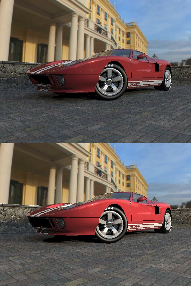

I have been doing some more development with my HDR lightdome system.  To speed
up parsing, the current system 'pixelizes' the HDR to do the calculations
according to the user setting, rather than sampling every pixel.  (e.g for a
setting of 200, it would pixelize it into 400x200).  However, this meant that
small, localized light sources could get missed, so the only choice was to
increase the pixelization level, which exponentially increases parse time.  I
have been experimenting with adding in a subsampling system with some good
results.
If first try to establish a general lighting profile of the base pixelization,
which is based on a power curve passing through 3 values: <0,0>, <0.5, A=total
average colour of the pixeled image>, <1, M=maximum sampled colour of the
image>.   From these I get the exponential power 'P' for the curve y=Mx^P, for a
general distribution curve.  Then I set a sub-sample threshold as a % of the
maximum value (e.g. x=0.9=90%).  For any pixel sample that is greater than the
corresponding colour (y), subsampling gets initiated.  Essentially the sampled
'pixel' is divided into 3x3 and the 8 new samples are taken in the immediate
vicinity (the 9th sample is the center which is already known).  If any of these
values is greater than the previously sampled value, then it is substituted in,
and that sub-pixel is then further sub-sampled in the same manner, and so on.  I
have added in two recursion limiters 1) variance value, if the previous sample
is within the variance of the new sample (eg. 0.99), thne recursion is
terminated. 2) number of recursions, if the recursion limit is reached, it is
terminated.
In the attached image, the HDR used for the lighting has a very bright but small
sun.    Based on manually checking, the maximum pixel value in the HDR is
~10,294.  For the top image, a pixel level of 200 is used, the maximum pixel
value found is 1,689 (~16% of the actual max).  In the bottom image, the
sub-sample threshold is set to 0.9, the susbsample variance is set to 0.99, and
the recursion limit is set to 5.  The parse (not including render) time for the
top image was 26.25s.  For the bottom image, the parse time was 28.75s.  To get
the equivalent pixelization level would mean setting the value at 48,600 instead
of 200, and parsing (if even possible) would be expected to take at least 60,000
times as long (3^5^2=59,049) or about 18 days!

The top image actually looks "better" because there is more contrast and
the colours are more vivid.
The bottom image looks slightly washed out - there seems to be too much
light. But it does look more like an actual photgraph compared to the top
image.

I may need to tweak the light levels, but the point is there is direct sunlight
in the HDR which should capture a noticeable shadow present in the second, but
not in the first.

ah ... thanks for pointing that out as I didn't pick that out right
away. maybe a difference image (like that used in radiosity tutorial)
might be helpful when trying to illustrate the effect of your technique.
nice subject material btw ... that's the GT40's (ferrari killer) younger
cousin correct, and at 150K+ per copy I'll just have to keep dreaming!

Thanks.  Yes, this is something I've thought about for a while and finally
decided to give adaptive subsampling a try.  It's likely not perfect, but it
looks like it may be helpful in a lot of cases.
Yes, 2005 Ford GT.  If I had $150k to throw around...
-tgq

"Trevor G Quayle" <Tin### [at] hotmailcom> wrote:
> I'll have a look at your HDR. Looks, good, nice and clean.  How did you make it?
>  Mirror ball or panoramic stitching?  It looks like you may not have quite the
> dynamic range to capture the sun level as it flattens out at about 5 stops.
> This is one of the most difficult things for creating HDR with direct sunlight,
> and I have found very few that have the true full dynamic level of the sun.  One
> thing I would suggest is to always take a photo at your fastest shutter speed as
> part of the bracketing to capture as high as you can.  I will also try with my
> dynamic range rebuilding option in my lighting which can recover or fake it
> fairly well at times.  Do you have any other HDRs available?  I always liek to
> find new ones that may have different interesting lighting effects.
The source images should have captured the range OK; I used +2 to -7 as the
exposure range (so 10 stops in total). I think there are two causes for it not
being as higher dynamic range as the dativ.at one: 1) it's right at sunset, so
there is less light from the sun than normal, and secondly, the source image is
quite small, so there a single pixel probably covers a larger area than the
actual sun, thus "diluting" its brightness a bit.
