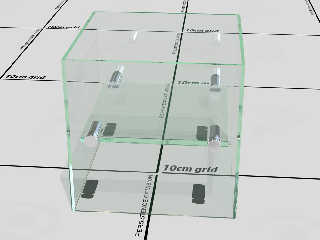

Just playing around with making a glass display case. Two simple macros to
create the glass panes and the fasteners.
Cheers,
Edouard.
Download 'glass_box_work.jpg' (109 KB)
Preview of image 'glass_box_work.jpg'

It looks like glass, to be sure. Did you use a surface normal for the pane-ends?
From: Edouard
Subject: Re: Glass case work
Date: 9 Feb 2011 22:35:00
Message: <web.4d535c94ff0562b5f028a4cf0@news.povray.org>
"Samuel Benge" <stb### [at] hotmailcom> wrote:
Yeah - each pane's edge is cut via CSG (actually with a double bevel), and I
apply an averaged normal to the difference object, so the cut is both rough (via
micro normals) and wavy (via a stretched bozo).
I'm using absorbing media to colour the glass, and I ended up using Robert
McGregor's dielectric macros from
http://news.povray.org/povray.binaries.images/thread/%3C4d524dfb%241%40news.povray.org%3E/
for the reflectance, etc.

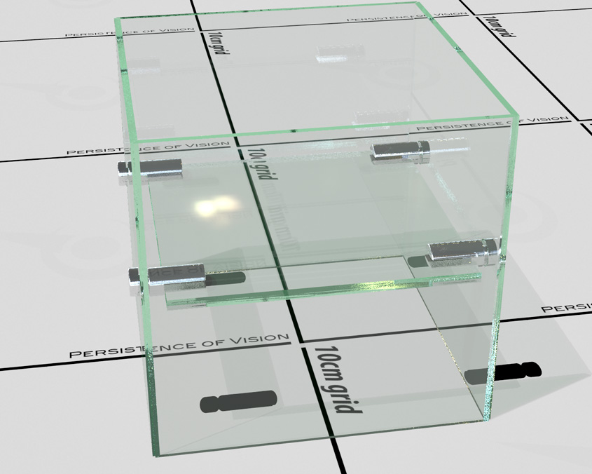

Attached is another angle.
Cheers,
Edouard.
Download 'glass_box_work2.jpg' (94 KB)
Preview of image 'glass_box_work2.jpg'

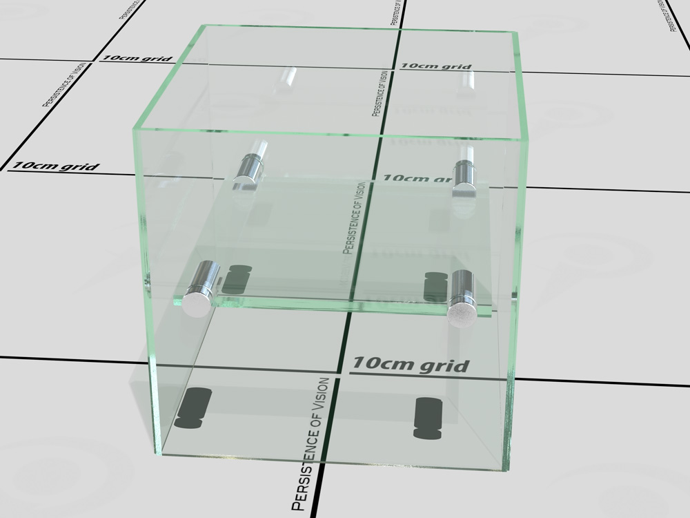

I am working on rendering a glass box and have met some problems. Would you mind
sharing your code with me? Thanks.
Date: 27 Oct 2012 14:57:13
Message: <508c2e89$1@news.povray.org>
> "sbakke" <nomail@nomail> wrote:
>>> Thank-you!
>>> Just an image map - the only trick is to make it high rez. The floor is a
>>> repeating 1024x1024 PNG.
>>> I'll try to post the POV file once I get it al cleaned up.
>>> Cheers,
>>> Edouard.
>> Thanks!
>> Steve
For the texture, it's normaly beter to start with a fully transparent
pigment like rgbt 1.
You absolutely need an interior statement. It have to set the ior for
your glass. Common glass have an ior around 1.5, but it can range from
presence of disolved materials will change it. Most gemms have ior in
the 1.7 to 2.5 range.
Adding some dispersion also help, but will increase the rendering time.
Use fade_color, fade_distance and fade_power 1 to provide any
colouration needed.
An interior block for a glass object can look like this:
interior{
ior 1.5  // Typical or default glass ior
dispersion 1.01 // Keep larger than but close to 1.
fade_color<0.7, 0.98, 0.8> // slightly greenish glass
fade_distance 1
// adjust as needed. Small increase the colour intensity.
fade_power 1 // The only realy realistic value in this case
A very important aspect is the reflectiveness of the glass. Your finish
should have:
finish{reflection{1 fresnel} conserve_energy}
This turn on the fresnel reflection going from almost zero to total
reflectiveness.
Also adding some relatively tight specular of phong highlight can
improve the aspect. It's often beter to use a specular or phong value in
the 0.5 to 0.7 range, but you are not limited to that range.
You can use both specular and phong.
If your box is made of several parts, you should use merge instead of
union to remove the internal surfaces.
You need to be carefull about coincident surfaces everywhere. They WILL
cause problem if you are not carefull.
In the global_settings{...} section, you need to increase
max_trace_level as the default of 5 is normaly conciderably to low.
From: clipka
Date: 27 Oct 2012 15:53:24
Message: <508c3bb4$1@news.povray.org>
Am 27.10.2012 20:58, schrieb Alain:
> colouration needed.
> interior{
> fade_distance 1
Actually, no - realistic fading for interiors is exponential rather than
linear; specify a fade_power value of 1000 or greater (1001 is often
used, but it doesn't really matter), POV-Ray will then enable
exponential fading.
> should have:
> reflectiveness.
Actually the specular or phong value range to use depends on the
tightness of the highlight (phong_size or roughness), unless you use the
new "albedo" keyword introduced in POV-Ray 3.7.
