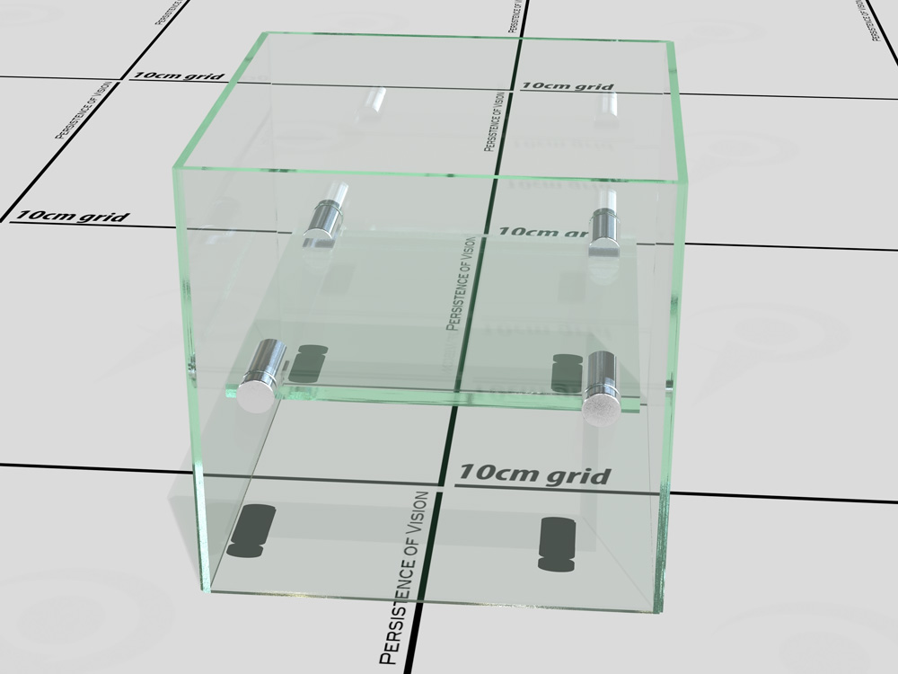

Just playing around with making a glass display case. Two simple macros to
create the glass panes and the fasteners.
Cheers,
Edouard.
Download 'glass_box_work.jpg' (109 KB)

From: Samuel Benge
Subject: Re: Glass case work
Date: 9 Feb 2011 22:15:01
Message: <web.4d535821ff0562b5312f6b340@news.povray.org>
It looks like glass, to be sure. Did you use a surface normal for the pane-ends?

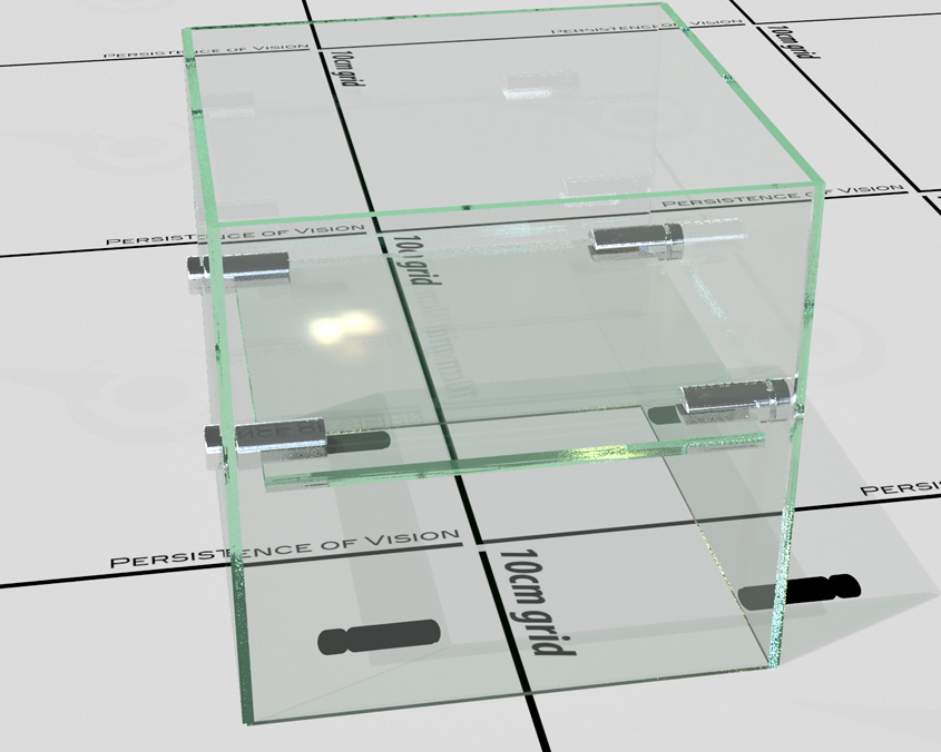

From: Edouard
Date: 9 Feb 2011 22:35:00
Message: <web.4d535c94ff0562b5f028a4cf0@news.povray.org>
Yeah - each pane's edge is cut via CSG (actually with a double bevel), and I
apply an averaged normal to the difference object, so the cut is both rough (via
micro normals) and wavy (via a stretched bozo).
I'm using absorbing media to colour the glass, and I ended up using Robert
McGregor's dielectric macros from
http://news.povray.org/povray.binaries.images/thread/%3C4d524dfb%241%40news.povray.org%3E/
for the reflectance, etc.
Attached is another angle.
Cheers,
Edouard.
Download 'glass_box_work2.jpg' (94 KB)
Preview of image 'glass_box_work2.jpg'
