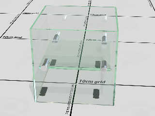

Just playing around with making a glass display case. Two simple macros to
create the glass panes and the fasteners.
Cheers,
Edouard.
Download 'glass_box_work.jpg' (109 KB)
Preview of image 'glass_box_work.jpg'

It looks like glass, to be sure. Did you use a surface normal for the pane-ends?

Yeah - each pane's edge is cut via CSG (actually with a double bevel), and I
apply an averaged normal to the difference object, so the cut is both rough (via
micro normals) and wavy (via a stretched bozo).
I'm using absorbing media to colour the glass, and I ended up using Robert
McGregor's dielectric macros from
http://news.povray.org/povray.binaries.images/thread/%3C4d524dfb%241%40news.povray.org%3E/
for the reflectance, etc.

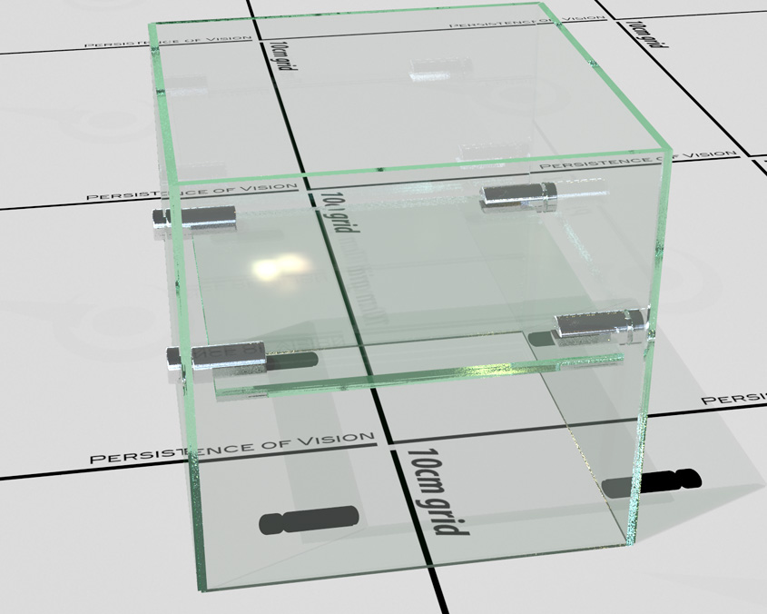

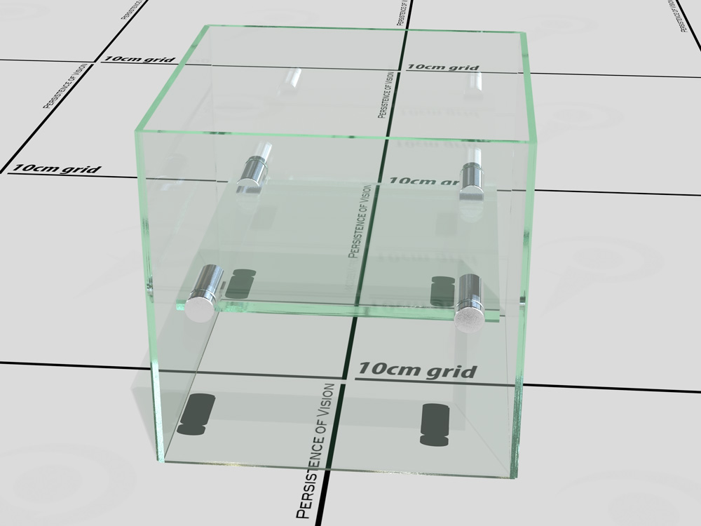

Attached is another angle.
Cheers,
Edouard.
Download 'glass_box_work2.jpg' (94 KB)
Preview of image 'glass_box_work2.jpg'

Impressive render! I'm slowly getting up to speed with POV-Ray and was wondering
how were you able to render the text so cleanly? Is that an image map? I've
tried both native text and image maps but usually end up with grainy/rough
edges.
Would you mind sharing your .pov file?

"sbakke" <nomail@nomail> wrote:
> Hi
> edges.
> Best Regards,
> Steve
Thank-you!
Just an image map - the only trick is to make it high rez. The floor is a
repeating 1024x1024 PNG.
I'll try to post the POV file once I get it al cleaned up.
Cheers,
Edouard.
