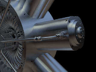

"H. Karsten" <h-karsten()web.de> wrote:
> And one more detailed
> Holger
This is beautiful & coming along quickly.  Just curious - are you modeling in
SDL or what approach are you taking?
Charles
From: Stephen
Subject: Re: Another point of view
Date: 9 Nov 2009 07:38:00
Message: <4af80d28$1@news.povray.org>
Charles C wrote:
> Stephen <mca### [at] aolDOTcom> wrote:
>> Yes there are but you would only use them for straight runs or ones with
>> you would use a compression fitting.
> I've seen it where pipe thread was used -and- the rotation/orientation mattered.
> Charles
I bet who ever did it had no intention of doing maintenance on it.
Cheapskate! ;)
Best Regards,
	Stephen
From: H  Karsten
Date: 9 Nov 2009 14:00:01
Message: <web.4af8659e234deab6da6353d60@news.povray.org>
> Charles
Thanks :)
I'm using Rhino, export this as pov-code in ten different levels, converting the
lowest detail one in to Raw (using basic) and than to obj, using Deep
Exploration. Than import this into 3DS-Max. Animating the part there and render
a (so called) "vue-file". It contains matrix-transform-data. My Pov-script take
now higher level geometry, using the matrix from MAX and do the rendering.
The matrix-vue-file from MAX is converted, using Basic.
Holger

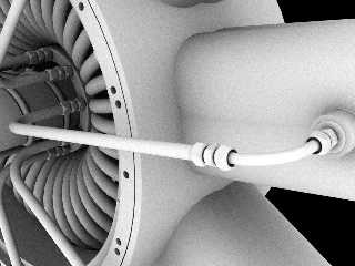

Hi people
Not very much things added today, just a few peaces, and the fillets.
These little rounding in all corners are *very* important for me. They are the
reason for me, to use a cad-program.
Take a closer look to all thing around you. You'll see, that there is not a
singe real corner. Everything is a little rounded. And if its just a little: the
"corner" will reflect the light different as an "artificial" one. Because of its
round shape, it reflects the light nearly always!
If you are interested in modeling with cad programs, you can use HeeksCAD.
Its free.
http://code.google.com/p/heekscad/issues/detail?id=193
You just have to convert the result to a mesh.
Compare the corners now with the rendering from before.
Holger :)

From: Robert McGregor
Date: 10 Nov 2009 18:20:00
Message: <web.4af9f470234deab64726e92b0@news.povray.org>
> Holger
Wow, what version of POV-Ray is this from? Or is this a preview from Rhino or
Max? It looks like a Monte Carlo ambient occlusion pass of some sort...
