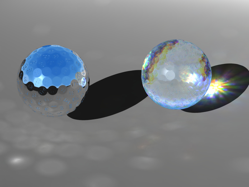

Seeking feedback. The render only took 4 days, 1.5 hours. The (plain) scene is
derived from the Photons_Radiosity.pov, with my own shape used - a sphere with
200 numbered equal sized circular flat faces. The left is quite reflective and
gives me pause to reconsider if a mirrorball can be adequately created in
POVRAY.
The right... I'd like to have one of those (in glass or plastic or whatever).
Download 'dcc_photons_radiosity.jpg' (192 KB)
Preview of image 'dcc_photons_radiosity.jpg'

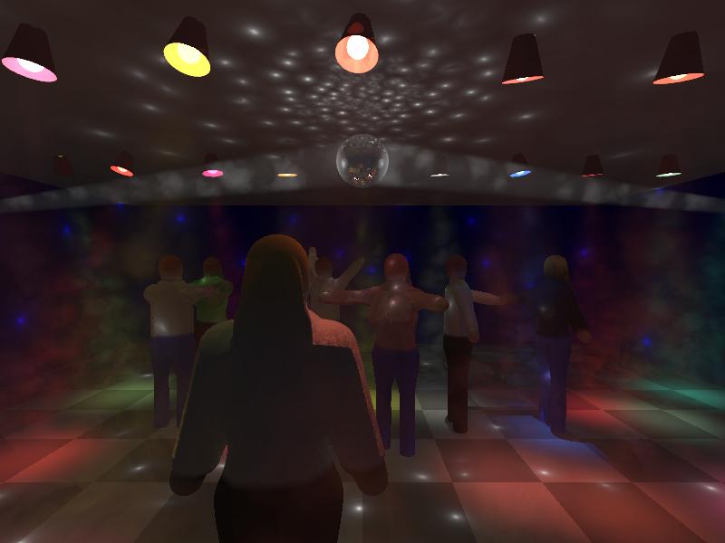

Actually that was one of the first things I tried with povray
when I discovered it about 3 years ago (see attachment, please
ignore the horribly disfigured blob humanoids).
If you expect to see strong photons from a mirrorball reflection
then the light which shines on the mirrorball must be a lot brighter
than the normal illumination of the target surface. This is so in
real life as well: hold such a thing into direct sunlight an you will
see a lot of spots anywhere the lighting is otherwise indirect. Or
shoot at it with a spotlight in an otherwise dark room.
But my mirror ball wasn't very sophisticated:
   sphere {0, 0.2 texture{T_Chrome_1E} normal {facets size 0.15}}
Download 'disco.jpg' (31 KB)
Preview of image 'disco.jpg'

You obviously have poor bounding. The bounding boxes for the sphere, all
200 facets and all 200 numbers are all pilled up and inflated to that of
the sphere. Each ray must be tested against each and every litle component.
Try without the numbers, or use bump_maps for them. It should be much
faster.
Considering the size of the numbers, faking it should be good enough.
The text object is relatively slow. Diferencing it from some object is
slower. Multiply that slowdown by 200, add photons, transparency,
reflection and dispersion, it's a perfect recipie for insane rendering
times.

Okay, I asked for feedback - I appreciate your taking the time to respond
Alain. I read the reference material. I was aware that text objects are
slow to render. The numbers are integral to my concept of the object,
even though they don't add much to this picture, which I saw as an
opportunity to assess how it might appear in that setting. In a simple
and more 'realistic' setting it might appear like this:
http://i34.tinypic.com/2ldvwqv.jpg
Of course, this is just one frame from an animation, but you see...
I'm happy to have insane rendering times if it gives me (or gets me
closer to) what I want.
As for the poor bounding, the object (a sphere with bits removed) is
bounded by a sphere of exactly the same size and location. Please
enlighten me as to how it could be better bounded?

I'd use an image pattern made after your numbers, and a bump map derived
from the image pattern.
To get beter bounding, you need to chop the sphere into many smaller
parts and reassemble the sphere from those parts. A single part may
consist of only a single facet, it's number and a bit of the surrounding
spherical shape.
This will work as long as the object remains opaque. If the object is
transparent, you'll see all the extra faces unless you use a merge, and
then, the bounding problem returns.
Another way, would be to create a mesh equivalent of the faces and the
numbers relief, make sure that it have an inside vector defined, and
difference that mesh from the sphere.
If you go the mesh way, you may as well model the whole thing as a
single mesh.
