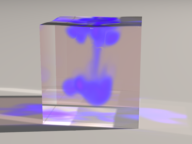

Hi, all.
Attached is a rendering image of ink drop dropped into a water tank.
I got the mesh(mesh2) for the water surface and the density(0~1.) of the ink(df3
file).
But I do not have good knowledge in the media rendering.
I am wondering if somebody can give me some suggestions on this or some other
media parameter examples and resources.
The ink can be black, dark blue, red or any other dark colors.
Any advices will be appreciated.
Thank you very much.
Paean
Download 'drops082.png' (201 KB)
Preview of image 'drops082.png'

Looking OK.
The default sampling is method 3. With that, the defaults are:
intervals 1 (you should leave it alone, increasing it will cause a huge
rendering slowdown, it may produce artefacts)
samples 3 (MINIMUM value! Increase as needed)
There is NO second samples value. If you provide one, it will be totaly
ignored.
"samples 100" is way faster than "intervals 10 samples 10".

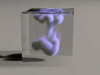

From: scott
Subject: Re: ink diffusion rendering for suggestions.
Date: 16 Oct 2009 11:00:39
Message: <4ad88a97@news.povray.org>
> other
I had a bit of a tinker with your code, and looked at those videos you
posted.
IMO the ink in those videos is a little unrealistic, as the under side of
the ink is too dark (it would be getting lit from the plane below the tank).
Or maybe I just can't figure out how to copy that effect in POV :-)
Anyway, I'm no expert, but the adjusted media block I came up is below.  I
also turned off photons and made the light a bit brighter.  (For test
renders you can reduce "samples" to 5 or so to speed up rendering)
Basically I got rid of the emission, and cranked up the scattering and
absorption.  I think it certainly looks more "3D" than before.
media {
                absorption 60*<1, 1, 1>
                intervals 1
                samples 20
                method 3
                scattering{ 4,<0.2,0.2,0.8>*50 }
                density{  density_file df3 densFileName
                              interpolate 2
                              scale <1,2,1>
                              translate <-0.5, -1.5, -0.5>
                    color_map {
                    [0.00 rgb 0.0] // density at the border of the media
                    [0.05 rgb 0.2]
                    [1.00 rgb 1.0] // densitiy at the center of the media*/
Download 'phot_met_glass.jpg' (43 KB)

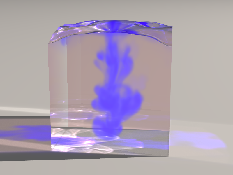

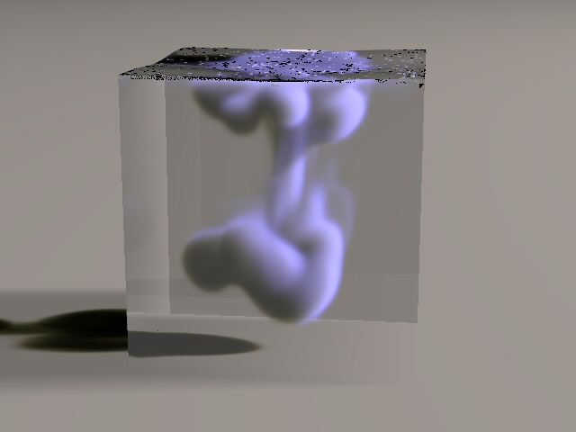

From: Paean
Date: 16 Oct 2009 13:20:01
Message: <web.4ad8aadcedf569a01524ae1d0@news.povray.org>
Hi, Scott,
Thank you very much for your help.
The results are indeed much better. However, i think it is some thick and gloom,
not so bright and wispy. I think the density_map need to be adjusted.
I am sorry for the vague expression since it is really hard to express my
thought very accurately. I am not a native English speaker.
I upload two new data files with higher resolution. They are much bigger, and I
have to upload them one by one. The usage of these data file is the same of the
previous ones.
There is some artifacts in the 2.30 mesh file, just ignore them.
And also, I upload two images from the two new data files and the previous pov
file expect  the samples modified to 20.  With the higher resolution data file,
the results seems better, while not good enough.
I am still learning and  working hard to improve the rendering.  Any suggestions
and help will be very appreciated.
Paean

Download 'drops_2.76.png' (223 KB)
Preview of image 'drops_2.76.png'
