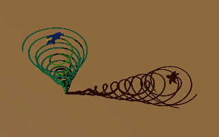

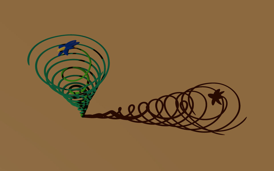

Not in the league of Mr Lipka's train engine, but an image I spent some time on
and a result with which I am happy. About a dozen CSG objects used in four
'object-functions' along with some standard POVRay functions stuffed in a single
isosurface (excepting the plane object).
Bill
Download 'objectpatchex12.jpg' (51 KB)
Preview of image 'objectpatchex12.jpg'
