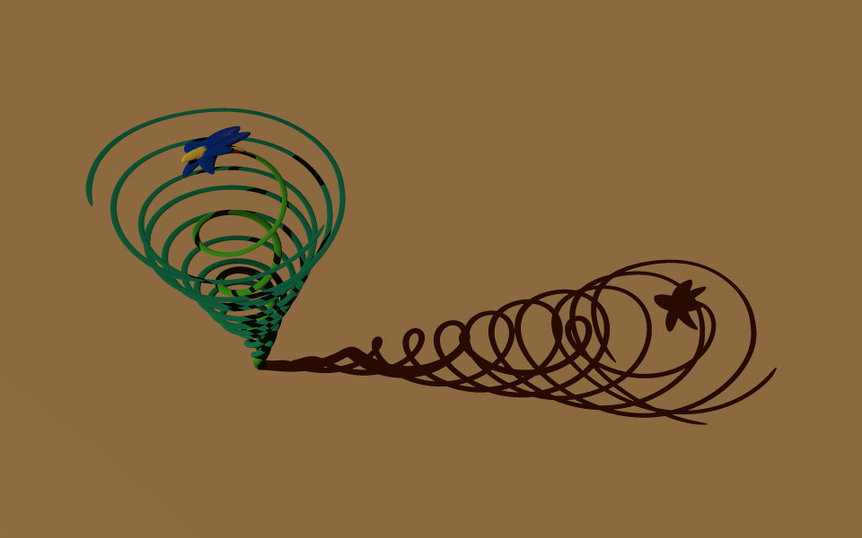

Not in the league of Mr Lipka's train engine, but an image I spent some time on
and a result with which I am happy. About a dozen CSG objects used in four
'object-functions' along with some standard POVRay functions stuffed in a single
isosurface (excepting the plane object).
Bill
Download 'objectpatchex12.jpg' (51 KB)
Preview of image 'objectpatchex12.jpg'

Even Mr Lipka is amazed about this "isosurfacizing" thing... I've toyed
multiple times with the idea of ditching my whole
beveled-thing-framework stuff and trying whether the same can be had
with the isosurfaces approach. The only thing that's holding me back is
that I guess I'd lose steam, figuratively speaking, if I tried to switch
engines while rolling on the track.
