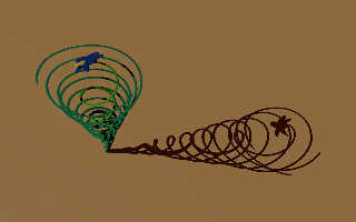

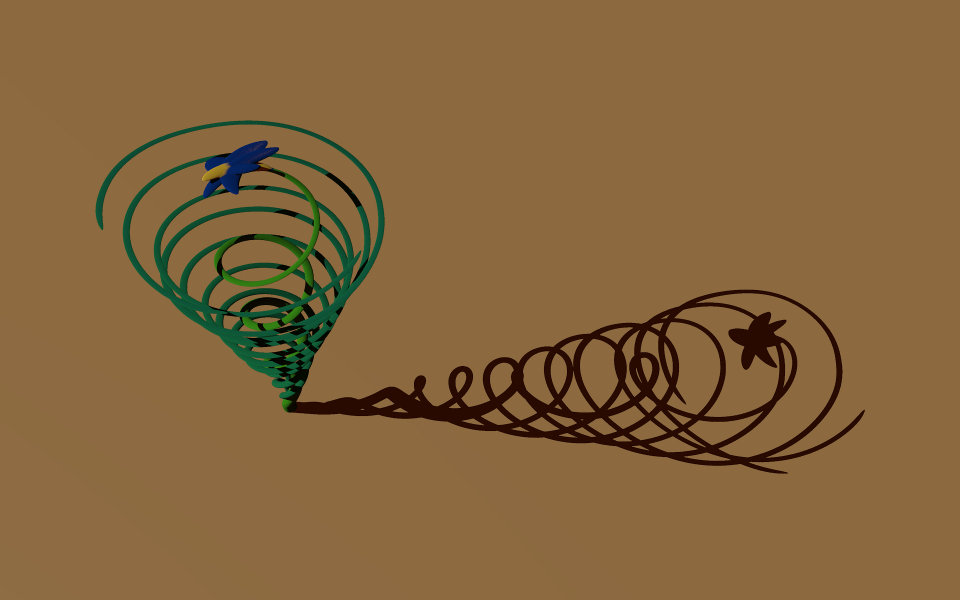

Not in the league of Mr Lipka's train engine, but an image I spent some time on
and a result with which I am happy. About a dozen CSG objects used in four
'object-functions' along with some standard POVRay functions stuffed in a single
isosurface (excepting the plane object).

Even Mr Lipka is amazed about this "isosurfacizing" thing... I've toyed
multiple times with the idea of ditching my whole
beveled-thing-framework stuff and trying whether the same can be had
with the isosurfaces approach. The only thing that's holding me back is
that I guess I'd lose steam, figuratively speaking, if I tried to switch
engines while rolling on the track.
