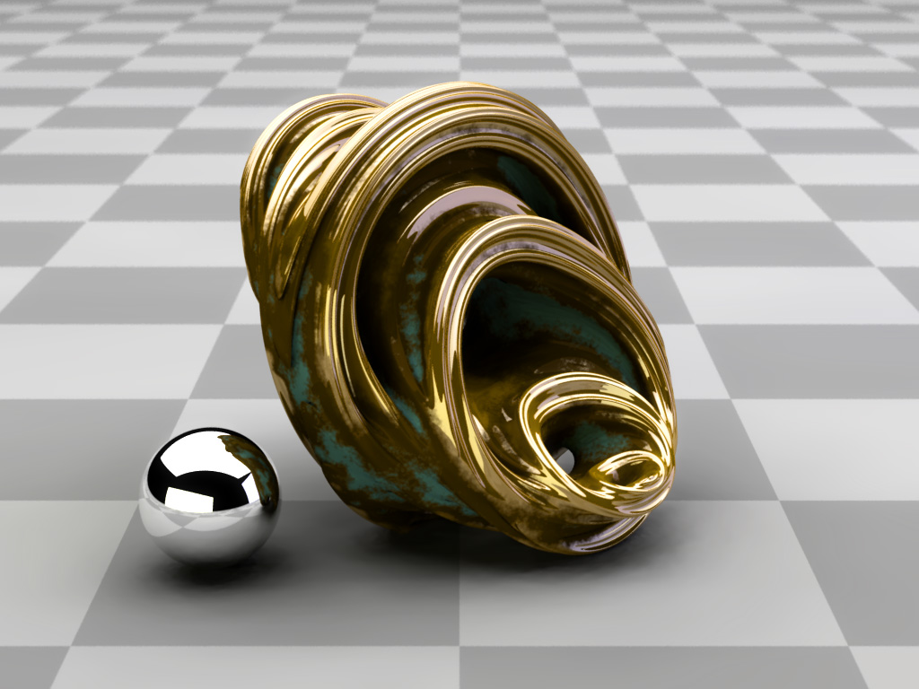

Hey all. Seeing the discussion about proximity patterns again, I thought I'd get
my macros in shape for a 0.9 posting (they aren't really ready to call 1.0 yet).
The basic idea is to run a macro on an object that does the proximity detection,
and then to save the results in a DF3 file. The parse time is long, but the
render time is very short, and since you now have the DF3 file on disc, future
renders don't require the initial parse step again.
Here's the test scene that's bundled with the macros.
Cheers,
Edouard.

From: Edouard
Subject: Re: DF3 Proximity Macros - test image
Date: 29 Aug 2009 05:30:00
Message: <web.4a98f42b546ccc6be45f5ea40@news.povray.org>
I've posted the source over on p.b.scene-files.
Cheers,
Edouard.

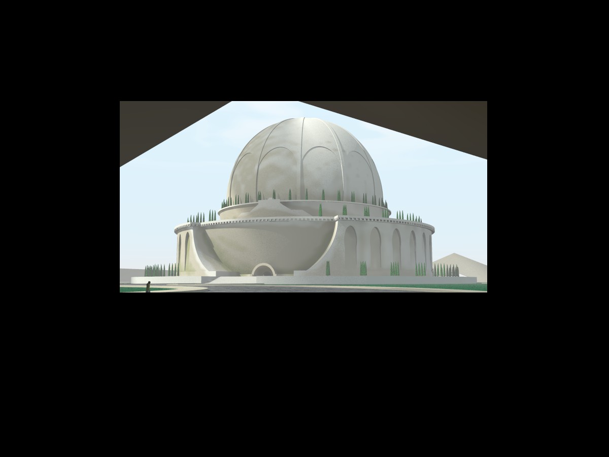

Hi Edouard!
I have tried your amcro with my cenotaph image. Works well and fast once the
df3 file is created. Three pigments are used as a map in this image.
One question though: My object being built in Moray, its orientation is with
the z-axis up and y-axis towards the far horizon away from the viewer. I
suppose your macro is not y-axis up sensitive, but I am not sure. The image
seems to show the three pigments with some kind of orientation along the
x-axis (left to right) while I expected a more down-up repartition of the
pigments. I have not yet tried to calculate the df3 file with building
rotated towards y up, and then rotate it back. What do you suggest to do?

From: Edouard
Subject: Re: DF3 Proximity Macros - orientation?
Date: 31 Aug 2009 05:05:01
Message: <web.4a9b91f361fec964e45f5ea40@news.povray.org>
> Well, I just tested with switched coordinates, the results are exactly the
> same, so I think Edouard's macro is coordinates-independent. However, that
> means something else is at stake.
Thanks for trying it out!
Can you explain again what the problem you are seeing looks like? There are a
few things that can contribute to the quality, and I still suspect that the DF3
interpolation code is POV has some odd quirks...
Cheers,
Edouard.
