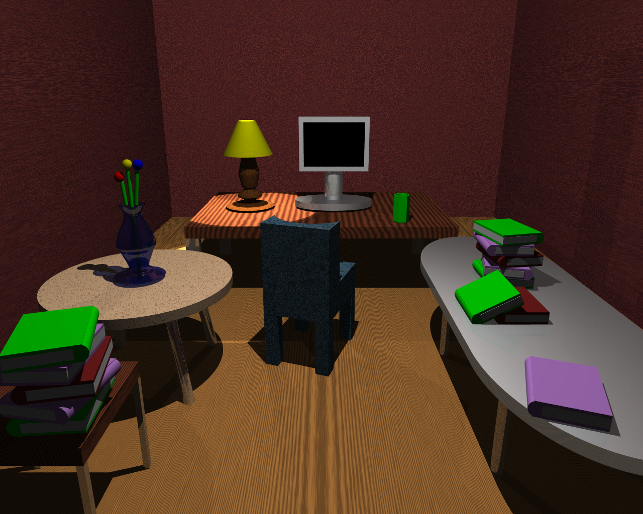

Hello, I'm a high school student taking a three-week course on POVray
programming this summer at City College in NYC. my first project was to create
an image of an office with four tables and various objects on the tables using
commands such as prism, lathe, sor and sphere_sweep. It is attached to this
post. I was just wondering If i could get some feedback on my first POVray
creation. It's a messy office with books strewn all over the table (I wanted to
practice my translating and rotating skills) and a cool blue glass vase.
also, how would I make the chair's seat more rounded and comfortable-looking.
i.e. how to make boxes more rounded at the edges, not pointy.
also, how would one go about making more realistic books? perhaps I could import
images for use as textures to put covers on the books. how do you do this?
Download 'office.png' (1897 KB)
Preview of image 'office.png'

Ah, a student assigned to model an office with POV-Ray... how come this sounds
familiar? :P
Good job.
Take care with the wall we're looking at straight-on: The texture doesn't look
too good; it seems to me that you carved the whole room out of a single piece,
and we're seeing the wood grain "head on" which we're seeing from the side in
the side walls. Maybe line up the wood vertically to avoid this, or use
separate objects for the walls.
The glass vase looks cool indeed.
Maybe add some petals to the flowers.
Images for book cover textures are a good thing to add realism. To be honest,
when it comes to realistic-looking books I personally go for meshes with
UV-mapped textures, but I guess your teacher would object for didactical
reasons (which is to say, he/she probably wants you to focus on CSG, at least
for now) :)
The parts that make up your books seem a bit misaligned; the paper should recede
a bit (in your shot it instead seems to stick out); the front and rear cover
boxes seem to stick out a bit to the front and back, respectively, instead of
aligning with the cylinder used for the back. (Real books often do have a ridge
between back and cover, but it's somewhat different in placement and shape. Take
a close look at a specimen.) Furthermore, you seem to be using a solid cylinder
for the back; for better effect, you might cut it into half, and cut away
another cylinder, for better effect; non-uniform scaling to "squish" the
cylinder might add to the look, too.
As for the chair's seat: Unfortunately, POV-Ray's internals are unsuited for
automatic rounding of edges and crevices, so you need to resort to manual
rounding. The standard procedure is a clever combination of cutting away part
of the object, and replacing it with a complementarily trimmed cylinder (or
torus, if the edge follows a circular curve), adding sphere sections at corners
where multiple rounded edges meed.
Very nice.  You're missing a checkerboard with a reflective sphere. ;-)
Check out the "superelipsoid". With some playing around, it makes decent
cushions, at least.
You can also use text to label the books at least.
I think it looks pretty good for a first povray project.  I notice you
you got a book propped up against another, which is good practice for
getting things rotates properly in tricky situations.  The vase looks
good too, although flower petals (maybe with a bunch of prisms) and a
bit of water in it might look good as well.
As Darren has suggested, take a look at the superquadratic ellipsoid object:
http://www.povray.org/documentation/view/3.6.1/285/
http://dynamicdreams.com/cg/img/scene_super3.jpg
They can be pretty good for cushions, in which case I'd make the seat of
the chair thinner and simply put a cushion on top of it.  The back of
the chair still looks a bit painful to sit on, and to fix that I'd
suggest changing the back of the chair to be a different style, like one
of these:
http://www.anaturalhome.com/images/products/cherry-chair.jpg
http://images.oneofakindantiques.com/5901_ladder_back_chair_1.jpg
Which I think should only be a little bit tricky to model.
I think that using an image as a texture for the covers could help a
lot.  You'll need to use an image map for this:
http://ftp.povray.org/documentation/view/3.6.1/337/
Probably you'll want to use several image maps, one for each part of the
book (i.e. front, back, spine, and pages).  You can look for the images
either online or by using a digital camera to take pictures of actual books.
It's also useful to have an actual book (or at least a picture of one
that's the same style you want) to work from when doing the modeling.
This one I found online seems to be about like what you want:
http://www.joes3dfantasyworlds.com/down/misc01/pileofbooks01-t.jpg
You'll notice that the pages are inset from the cover somewhat, and the
spine is shaped more like a thin cylindrical shell.  These things might
help you a bit too.
Do post the final image when you're done, I'm curious to see it!
The easiest way is to use a superquadric ellipsoid (superellipsoid{}).  There
are also rounded shapes in shapes.inc.
Look up "image_map" in the documentation.  Another option is to use an object
pigment with a text{} object.  Either way, the pigment should be rotated to
align with the book cover.
Over all, an impressive model for a begginner.
Some changes that I'd make and suggest to you:
Make your room out of several box, one for the floor, une for the
ceiling and one for each walls. Add the texture to each one separately.
Your book will look more convincing if made of 2 thin boxes for the
covers and another for the pages. A gradient pattern scaled small could
effectively simulate the pages edges.
Adding some text to the books will be an improvement. Look at the text
object and object pattern.
I'd tend to scale the wood textures down. The provided woot textures and
pigments normaly need some scaling that depends on the scene.
You got meny usefull propositions from other posters and I agree with
them. I propose you some alternate options.
A small critic: the table with the monitor looks to low, been at about
the same hight at the chair.
> create
> using
> this
> creation.
It's very good for a first project!
Whilst others have commented about the geometry and textures, I'd just
comment about the lighting.
The default POV light does not fade with distance (ie it lights everything
the same amount no matter how far away from the light it is) - this is not
very realistic.
Try adding the "fade_distance" and "fade_power" keywords to your lights
(look them up in the docs), you will need to adjust the light brightness to
get a good balance of light and dark areas in your scene, but it should make
it look a lot more realistic.
