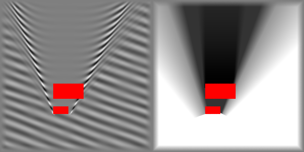

I am working on some wake problems, through a different approach with image
maps which is not very convincing presently, So, I am particularly
interested in your functions. Any chance you make them public? I would much
appreciate this!

I just posted the wake-wave making code to p.b.s-f. It can generate the image
maps attached to this message, which are used respectively as image_map in a
height_field and as pattern for a texture_map. In red the ship is shown, which
illustrates why the wake needs to be assymetrical. And if you look closely, you
can see that the waves nicely meet up in the middle :-).

Excellent! Thank you very much indeed. I am going to study your code
seriously. It seems to exactly cover my needs. I shall report back in due
time.

I hope it is all sufficiently self-explanatory. One thing to keep in mind is
that although I looked at several images of wakes, read written material about
it and closely watched ducks swim before creating this code, in the end the
formulas are not based on real-world physics. They're just functions that can
produce something that is visually close to actual wake waves. Functions that
can be tweaked to produce an assymetrical wake as well. If you dive into the
code, you'll probably see that the waves are constructed in a bottom-up
fashion, which hopefully helps you to understand what is happening.

Ok. Thanks for your additional explanations. I don't need exact replication,
make-believe is enough and I think that your code is doing that very well.
Swimming ducks indeed. I have been watching them too in that context :-)
