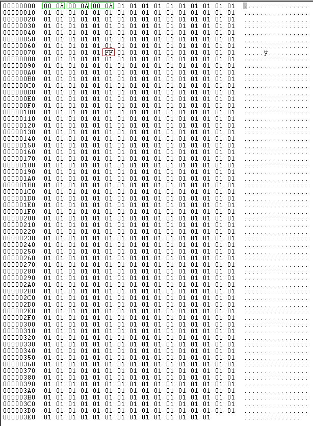

The attachment is a screenshot of the data inside the DF3 (a hexdump). This is a
10x10x10 DF3; but I am still having the problem with a 100x100x100; I used a 10x
DF3 to show the voxel better. The header is indicated by green boxes, the voxel
is indicated by a red box. The DF3 is of the proper filesize and I think it was
constructed properly; 10*10*10+6 = 1006 bytes.
As you can see, the offset of the voxel is at 075h. That puts the voxel *AT* the
second coordinate away from the forward, left, lower corner. The coord is XYZ =
2,2,2; subtracting 1 to bring into the range of 0 to 9 is 1,1,1; and then the
offset is 1 + (1*10) + (1*10*10) = 111, + 6 (for the header) is 117, and in hex
that is 075h.
As Alain suggested, I filled the blank DF3 with 01 instead of 00 before I
altered it for the voxel.

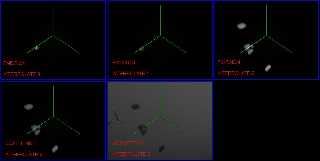

And finally here is a screenshot of some renders. The artifact problem is very
obvious. Even though this is a 10x10x10 DF3, I am still getting artifacting
with a 100x100x100 DF3.
Download 'panels.jpg' (245 KB)

.... SORRY about that! I overwrote the screenshot that I took (DARN it!! I could
kick myself - and it was such a NICE screenshot, with explanatory notes and
stuff!).
It displayed five 320x240 panels in a 1024x768 JPG, emission with interpolate 0,
1, and 2; scattering with interpolate 2 and absorption with interpolate 2 to
show the problem. Oh, well.

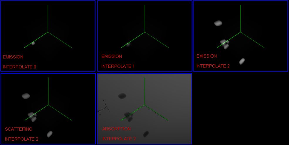

.... lets try this again, if it fails for some reason I give up.
The attachment SHOULD be the screenshots of some renders.

Download 'screen.jpg' (28 KB)
Preview of image 'screen.jpg'
From: JeffBTX
Subject: Re: DF3 Interpolation Problem
Date: 30 May 2009 13:25:00
Message: <web.4a216b4d1aa18c33f8eed5c40@news.povray.org>
.... good, the second attempt at posting that screenshot worked (after I
reconstructed it - sorry, no notes because I had to build it again and I was in
a hurry, but the problem is obvious).

> Basically I am getting artifacts from DF3 files. Alain suggested a
> possible
> solution; fill empty spaces with 1's instead of 0's. I tried it... the
> problem
> was alleviated somewhat. I am still getting severe artifacts if a voxel is
> placed EXACTLY at the corner of a media cube, so I "backed the voxel off"
> into
> the cube away from the corner a little. I'm still getting artifacts.
What is going on is that the bounding object is too close to the voxel.
Why is that so? After all, the density pattern goes from <0,0,0>
to <1,1,1>, shouldn't that mean it fits in a box the same size?
The answer is in the way that media is handled by POV.
A ray coming from the camera hits the bounding object...
then travels through the object until it exits the bounding object.
So you have a line segment, by default POV then chops that
line segement up in to 10 parts or "intervals", then tests each
interval, resulting in a color contribution for the final pixel.
So what happens when a voxel is near the edge of the
bounding object?
POV measures the first interval as a distance from the
side of the bounding object... the shape of the bounding
object is determining the geometry of the interval, so
some rays have more contribution from the lit voxel,
and it begins to take on the shape of the side.
The obvious fix is just to make the bounding object
bigger... but then you end up with intervals that are too
big. So then you need to increase the intervals to match.
camera {
   location <0,3,-3>
   direction z
   right     x*image_width/image_height
   look_at <-0.5,-0.35,0>
   angle 5
box {-1, 2
  texture {
    pigment {rgbt 1}
  interior {
    media {
      emission 1*3
      absorption 1*5
      scattering {1, White*3 extinction 1}
      density {
        density_file df3 "ts10.df3" interpolate 0
      intervals 30
      samples 1,100
  hollow
  translate -0.5
  rotate <0,45,0>
> that is 075h.
> In further posts I will try to post a .ZIP of the DF3, and a screenshot of
> renderings that displays the problem (this will be the first time I have tried
> to post attachments, so we will see if this works...)
Good news!
There are NO artefacts when using version 3.7 beta 32 and interpolate 2.
Interpolate 0 is NO interpolation. You only see the voxel.
Interpolate 1 is linear interpolation. The voxel becomes fuzzy.
With 3.6.1 and interpolate 2, there are HUGE artefacts. Making the container
larger don't help, in fact, the result gets worst. Also, if you enlarge the
container, you also need to increase the samples value a LOT. Adding 0.1 all
around and you need samples 20, at least!
Also, DON'T increase the intervals value!
I just tested samples 300 VS. intervals 30 samples 10.
My "normalised" times are:
intervals 30 samples 10: 1 (100% of the time)
samples 300: 0.787 (78.7% of the time)
samples 300 gives much smoother results, even if they are still uncorrect.

What you say makes perfect sense to me; that is, I understand it. But Alain says
that doesn't really help... I posted the code from your post into a new POV
file, tweaked the camera, etc., and rendered it. Using interpolate 2, the
problem still exists.
Alain;
Thanks for the information. POVRay 3.6.1c is the problem, then... I hate to
download an ongoing work-in-progress beta though. I guess I just have to wait
for an official 3.7 release... in the meantime, any work I do with DF3's will
be suspect.
