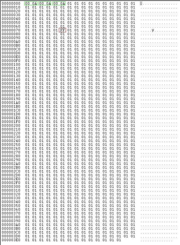

The attachment is a screenshot of the data inside the DF3 (a hexdump). This is a
10x10x10 DF3; but I am still having the problem with a 100x100x100; I used a 10x
DF3 to show the voxel better. The header is indicated by green boxes, the voxel
is indicated by a red box. The DF3 is of the proper filesize and I think it was
constructed properly; 10*10*10+6 = 1006 bytes.
As you can see, the offset of the voxel is at 075h. That puts the voxel *AT* the
second coordinate away from the forward, left, lower corner. The coord is XYZ =
2,2,2; subtracting 1 to bring into the range of 0 to 9 is 1,1,1; and then the
offset is 1 + (1*10) + (1*10*10) = 111, + 6 (for the header) is 117, and in hex
that is 075h.
As Alain suggested, I filled the blank DF3 with 01 instead of 00 before I
altered it for the voxel.

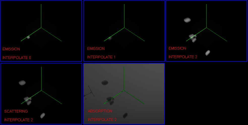

And finally here is a screenshot of some renders. The artifact problem is very
obvious. Even though this is a 10x10x10 DF3, I am still getting artifacting
with a 100x100x100 DF3.
Download 'panels.jpg' (245 KB)
Preview of image 'panels.jpg'

.... SORRY about that! I overwrote the screenshot that I took (DARN it!! I could
kick myself - and it was such a NICE screenshot, with explanatory notes and
stuff!).
It displayed five 320x240 panels in a 1024x768 JPG, emission with interpolate 0,
1, and 2; scattering with interpolate 2 and absorption with interpolate 2 to
show the problem. Oh, well.

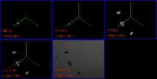

.... lets try this again, if it fails for some reason I give up.
The attachment SHOULD be the screenshots of some renders.
As to that ZIP I posted of the DF3 file... something happened(?)
It (the original ZIP) UNZips just fine into the DF3 file on my hard drive.
BUT if I download the ZIP out of the post, and UNZip it, Windows Vista refuses,
says that it is "empty" (?) Something happens during uploading, I guess (?)
Anyway...
Download 'screen.jpg' (28 KB)
Preview of image 'screen.jpg'
From: JeffBTX
Subject: Re: DF3 Interpolation Problem
Date: 30 May 2009 13:25:00
Message: <web.4a216b4d1aa18c33f8eed5c40@news.povray.org>
.... good, the second attempt at posting that screenshot worked (after I
reconstructed it - sorry, no notes because I had to build it again and I was in
a hurry, but the problem is obvious).
> that is 075h.
> In further posts I will try to post a .ZIP of the DF3, and a screenshot of
> renderings that displays the problem (this will be the first time I have tried
> to post attachments, so we will see if this works...)
Good news!
There are NO artefacts when using version 3.7 beta 32 and interpolate 2.
Interpolate 0 is NO interpolation. You only see the voxel.
Interpolate 1 is linear interpolation. The voxel becomes fuzzy.
With 3.6.1 and interpolate 2, there are HUGE artefacts. Making the container
larger don't help, in fact, the result gets worst. Also, if you enlarge the
container, you also need to increase the samples value a LOT. Adding 0.1 all
around and you need samples 20, at least!
Also, DON'T increase the intervals value!
I just tested samples 300 VS. intervals 30 samples 10.
My "normalised" times are:
intervals 30 samples 10: 1 (100% of the time)
samples 300: 0.787 (78.7% of the time)
samples 300 gives much smoother results, even if they are still uncorrect.
The documentations are WRONG about the default values used. They are:
method 3
intervals 1
samples 3

What you say makes perfect sense to me; that is, I understand it. But Alain says
that doesn't really help... I posted the code from your post into a new POV
file, tweaked the camera, etc., and rendered it. Using interpolate 2, the
problem still exists.
Alain;
Thanks for the information. POVRay 3.6.1c is the problem, then... I hate to
download an ongoing work-in-progress beta though. I guess I just have to wait
for an official 3.7 release... in the meantime, any work I do with DF3's will
be suspect.
