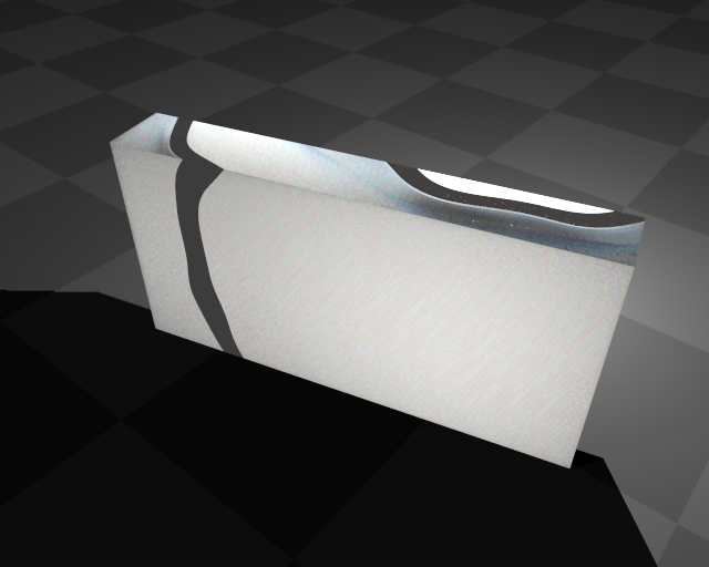

Today I tested the principle of making a SSLT marble object, lit from behind.
Results are interesting, but not entirely successful. I'll retry it in future
though.
The idea is that the veins permeate through the solid, and have different
absorbent and diffusive properties than the rest of the medium.
The attached image shows a simple box (this can be any CSG-able object), but it
is actually two objects: an isosurface for the veins (dark, and highly
absorbent), and its inverse for the rest of the material (light, and highly
scattering). I've chosen to mimic 'inverse' using phase in the vein pattern,
rather than trying to close off CSG inverses.
Notes to prevent confusion:
1. The floor does not use SSLT.
2. The box is slightly raised from the floor, so the shadow position is OK.
(Speculative!) Observations:
It's not a visually good marble (it won't convince anyone), but I think a
principle is demonstrated here.
1. Dark veins can throw 'shadows' into the material, even when the veins are not
touching (?) the surface of the overall object.
2. The blue back-scattering, and red forward-scattering (a consequence of the
scattering colours) at the top-right of the shape.
3. What I'm not really seeing is the gradual receding of the veins in the bulk
of the material. Someone will probably tell me they can see it (top-left) and
say that I need to tweak parameters of textures, but I think that this marbling
is not possible in the current SSLT implementation, because inner edges can't
see the (discarded filtered pass-through) light. I'd be interested to know the
truth either way.
4. Possible brightness problem at edge of CSG intersections. I don't want to
speculate on the cause, as there are many possible reasons. (Oh, OK then: 1.
Poor CSG coincidences (and is the top face complete?), 2. Perhaps small convex
volumes are problematic).
If/when this SSLT develops, I hope for marbles and woods to be created like this
(a new material library) - obviously with more marble-ish functions (like the
current surface textures), and with a better understanding of the interfaces
between coincident surfaces of different SSLT-enabled materials.
Trace time (not tuned): ~50 mins on Intel Q6600 @ 2.4GHz (640 x 512, +AM2 +a0.4)
Download 'subsurface_test4.jpg' (134 KB)
Preview of image 'subsurface_test4.jpg'

Plain fact observation:
You're operating far beyond the current limitations of the SSLT algorithm :P
Yes, but I'll save it for later ;o)
It's important to understand limits, and maybe others can learn from this
exercise, and not get too ambitious yet.

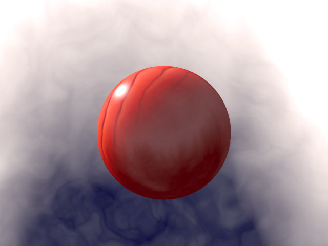

First off - fantastic work on the initial SSLT algorithm, it's an amazing
feature that already works very well!
And now to my request :-) Having the SSLT algorithm be able to take a density
parameter in the same way media does would be in my top two requests for future
work - faked media-based SSS can give some pretty stunning results in term of
the feeling for the material.
My examples is far from stunning, but hopefully shows that there's a huge amount
that could be achieved if density could make it into the SSLT system...
Cheers,
Edouard.
Download 'media-sss-density.jpg' (25 KB)
Preview of image 'media-sss-density.jpg'
Thanks. Glad to hear you like it.
Unfortunately(?), the model on which the SSLT algorithm is based is not really
"volume aware": Basically all it does to compute the apparent color of a point
on the object's surface is sample the incident light at some other surface
points nearby, and then apply some smart math to it.
So yes, I will ultimately equip it with mechanisms to vary the material
parameters over space. But no, this will only take into account the parameters
on the surface (using the values at both the entrance and exit point).
Well, we'll see what the SSLT code will be able to do with that pattern
approach.
A possible extension would be to simply use not the parameters at the entrance
and exit point, but the averaged value along a straight line between the two.
Maybe this would be a viable way to "fake" volumetric effects.
