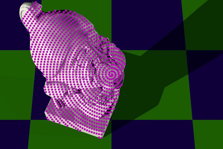

From: Edouard Poor
Subject: Re: Autofocus macro *almost* done...
Date: 4 Mar 2009 04:10:00
Message: <web.49ae442162bb2823bd47b0730@news.povray.org>
"Edouard Poor" <pov### [at] edouardinfo> wrote:
> Yeah - I work in a spiral from the center of the image outwards, doing a trace
> at each point. The ones that hit the object get stored in an array. After I've
> finished the spiral, I sort the array based on distance from the camera and
> choose the value at 25% (the, umm, median of the first half - which I presume
> has some statistical name that I either never knew, or long since forgot...).
A picture is worth at least 74 words:
Download 'autofocus-sprial.jpg' (130 KB)
Preview of image 'autofocus-sprial.jpg'
From: triple r
Date: 5 Mar 2009 03:20:01
Message: <web.49af8a2d62bb282363a1b7c30@news.povray.org>
That clears it up.  Thanks.  There may be some pathological cases, but this
appears to work very well.
 - Ricky
