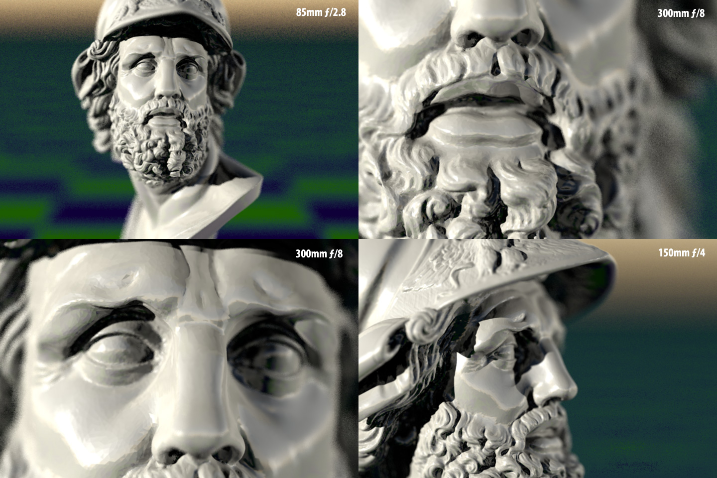

I've been working on updating my 35mm Camera macros, and I had the idea to make
an autofocus version of the macro to help with complex objects and narrow
depths of field, and any other situations where choosing, say, the center of
the objects bounding box would give the wrong results.
Not quite done (mainly code tidy up at this point), but here are the results on
the Ajax model.
I'm using a 35mm camera approx 500mm from the bust (which is scaled to be about
180mm high).
Lenses used: 85mm, 150mm and 300mm.
Any comments on the quality of the focal plane chosen?
Cheers,
Edouard.
Download 'autofocus.jpg' (361 KB)
Preview of image 'autofocus.jpg'

I like the idea.  My usual method is trial and error.  How does it choose?  Does
it trace?  What happens if the object has holes?  What if there is no central
subject?
I really like the physical approach here.  Just like lightsys, I usually try to
choose arbitrary parameters that give the same look, but my choices always fall
far short of physically-based choices.
No complaints here.
 - Ricky
From: scott
Subject: Re: Autofocus macro *almost* done...
Date: 4 Mar 2009 02:43:30
Message: <49ae3122$1@news.povray.org>
Only that my 300mm lens wouldn't be able to focus that close :-)  Apart from
that looks like good useful work!

Yeah - I work in a spiral from the center of the image outwards, doing a trace
at each point. The ones that hit the object get stored in an array. After I've
finished the spiral, I sort the array based on distance from the camera and
choose the value at 25% (the, umm, median of the first half - which I presume
has some statistical name that I either never knew, or long since forgot...).
I need to add some fallback code for when the spiral and the object don't
connect. Something involving the same trick, but aimed at the center of the
objects bounding box. Or something like that.
I'm now much more impressed by my point-and-shoot camera with it's auto-focus
face detection stuff. It all sounds easy until you actually have to write the
code... :-)

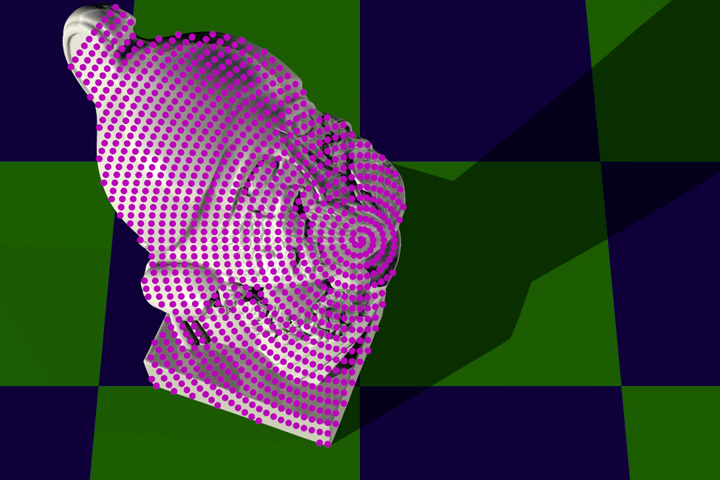

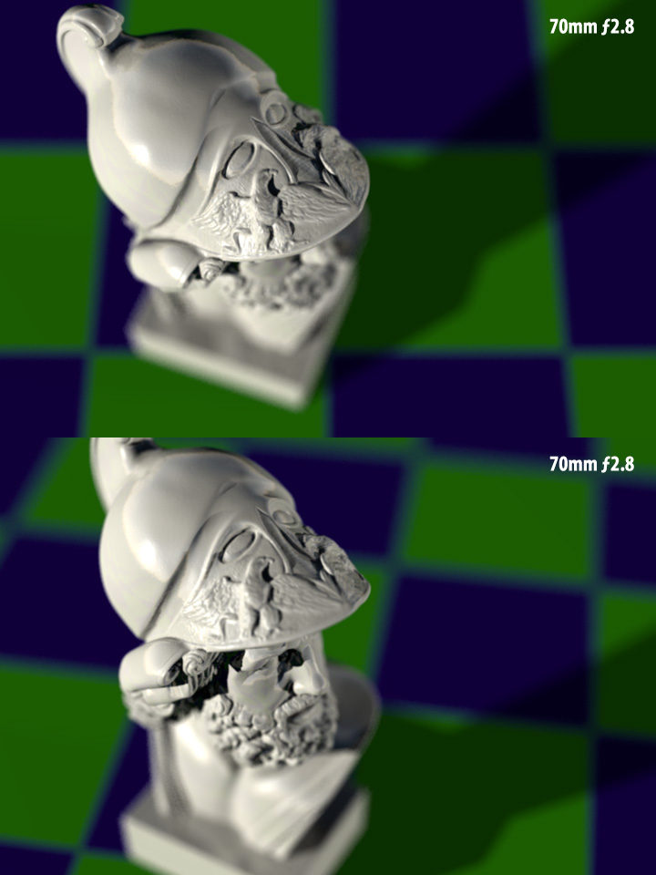

Attached is another couple of images that were rendering in the background. On
this model at least, I'm pretty happy with the results so far.
Cheers,
Edouard.
Download 'autofocus-2.jpg' (101 KB)
Preview of image 'autofocus-2.jpg'
From: Edouard Poor
Date: 4 Mar 2009 04:10:00
Message: <web.49ae442162bb2823bd47b0730@news.povray.org>
A picture is worth at least 74 words:
Download 'autofocus-sprial.jpg' (130 KB)
Preview of image 'autofocus-sprial.jpg'
That clears it up.  Thanks.  There may be some pathological cases, but this
appears to work very well.
 - Ricky
