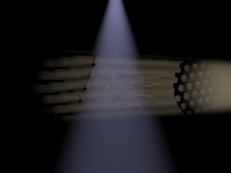

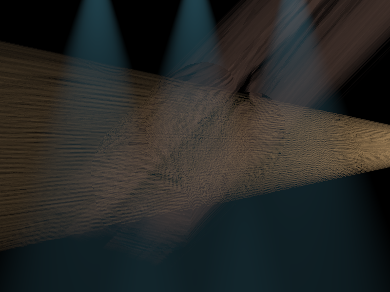

I've been working on using spotlights as pattern projectors by putting a small
cylinder just in front of the light with an image_map and filter all 1, and
when they are projecting on any surface it works fine.
When I try to put media in the air, all sorts of artifacts show up, especially
when multiple light beams interact.
Does anyone have any idea of how to fix this?
Relevant code info: using scattering type 2 (also tried isotropic with same
results), low density media, light sources are spotlights with inverse square
law fading.
The blue lights are perpendicular to the camera with no pattern projecting, the
yellowish light is also perpendicular and from the right but with pattern, and
the pinkish is coming from behind the camera and facing the plane that the
other lights are in.
Thanks for any help!
Chris
Download 'fogtest.png' (372 KB)
Preview of image 'fogtest.png'

Unfortunately, it's not something that seems to have been fixed with the
beta. Here is a simpler test image, it renders identically in all the
version I have to test in: Windows: Offical 3.6.1 & 3.7b31 and MegaPOV
1.2.1; Mac OS X: official 3.6.1, MegaPov 1.2.1 (PowerPC)
I didn't try clipka's idea of media sampling quality yet, but here's the
code for this test image so you can verify:
//Code Start
global_settings{
	#if(version < 3.7)
		assumed_gamma 1.0
	#end
#default{texture{finish{ambient 0}}}
camera{location <-10,0,-30> look_at <0,0,0>}
light_source{
	20*y rgb <0.5,0.5,1.0>*100
	spotlight radius 8 falloff 18
	point_at 0
	fade_distance 2*pi fade_power 2
light_source{
	-30*z rgb <1,0.8,0.5>*100
	spotlight radius 8 falloff 12
	point_at 20*z
cylinder{0,-0.001*z,0.5
	texture{pigment{hexagon rgb 0, rgbt 1, rgb 0 rotate <90,0,10> scale 0.05}}
	scale <5,5,1> translate -20*z
box{-100,100 hollow
	texture{pigment{rgbt 1}}
	interior{media{scattering{2,1}density{rgb 0.001}}}
//Code End
Download 'fogtest3.png' (138 KB)
Preview of image 'fogtest3.png'

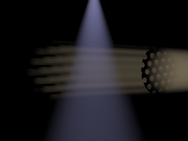

This is indeed a sampling quality issue: As the ray travels through the media,
it encounters alternating intervals of bright / dark light caused by the
"patterned" spotlight from the right.
The default number of samples is not enough to sample each single of these light
cones reliably. Note that you have something like 5 light cones in sequence to
be traversed by a ray; the default of 10 samples is barely enough to place a
single sample in each bright and each dark interval, and leaves no room for any
precision.
So with default settings you inevitably get an aliasing effect in the media
sampling.
With just that single light source, it isn't much of a problem: The aliasing
errors average out to a good deal, and the result looks convincing enough to
the human eye.
The problem surfaces, however, with the additional spotlight, as it causes POV
to modify the distribution of the media samples in an attempt to optimize it
for the standard case (whic is that the spotlight's cone makes up one single
illuminated interval), resulting in modulations to the aliasing effects, and
eventually moiree patterns.
Cranking up the quality helps indeed, e.g. using intervals 10 and samples 10,10
significantly reduces the amount of moiree (though it still remains visible; at
the same time the light pattern becomes less smooth, but close inspection shows
that this is actually more realistic.)

From: CShake
Subject: Re: weird media artifacts?
Date: 27 Feb 2009 15:56:48
Message: <49a85390@news.povray.org>
> -----BEGIN PGP SIGNED MESSAGE-----
> Hash: SHA1
> clipka wrote:
>> precision.
>> sampling.
>> the human eye.
> 	Note that using intervals 1 and samples 100 should give better
> results than intervals 10 samples 10 for the same render time (and
> of course, you can then lower the samples again to improve render
> time, 50 or even 30 should be enough here).
> 		Jerome
> mailto:jeb### [at] freefr
> http://jeberger.free.fr
> Jabber: jeb### [at] jabberfr
> -----BEGIN PGP SIGNATURE-----
> Version: GnuPG v1.4.9 (GNU/Linux)
> iEYEARECAAYFAkmoPp4ACgkQd0kWM4JG3k9ElACeJlUlKh0pNQ9CY1myEbTSHZn8
> 8xQAoJh1Mg5DE3MNAj4F5efVGi55wrlV
> =V73p
> -----END PGP SIGNATURE-----
Thanks, the increased samples with fewer intervals makes a huge
difference in render time, I tried this scene first with 30 intervals
(ratio 0.5) and minimum 10 samples, then 1 interval with 100 samples and
it ran at less than 1/4 the time and produced superior results.
Seems like my problem has been fixed!
Working replacement line for previously posted code:
interior{media{scattering{2,1} method 3 intervals 1 ratio 0.5 samples
100,1000 variance 1.0/256 confidence 0.96 density{rgb 0.001}}}
Chris
Download 'fogtest3_1int_100samp.png' (106 KB)
Preview of image 'fogtest3_1int_100samp.png'
