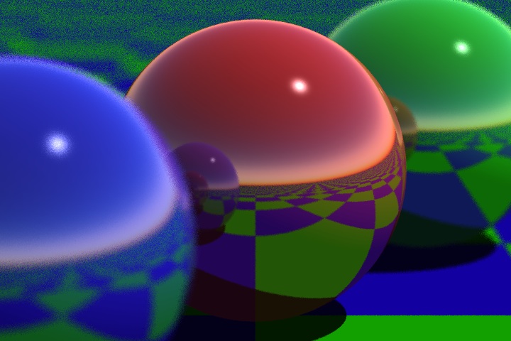

A simple macro I put together that approximates a 35mm camera in the scene.
Should do the correct field of view and a vaguely plausible focal blur. Feel
free to fix any obvious (and even not so obvious) flaws...
The example picture uses a 50mm lens at f1.4. The three balls are 100mm in
diameter, with the center ball 500mm from the camera. The checkerboard is 100mm
per square.
#macro Camera35mm( cam_pos, look_pos, focal_length, fstop, num_samples )
 #local film_width = 35;
 #local fov = degrees( atan( (film_width / 2) / focal_length ) * 2 );
 #local apertureDiameter = focal_length / fstop;
 #local focal_distance = vlength( look_pos - cam_pos);
 camera {
  perspective
  focal_point look_pos
  blur_samples num_samples
  aperture (apertureDiameter / focal_distance) * 1000  // Magic Number
  location cam_pos
  look_at look_pos
  angle fov
  right x * 1
  up y * image_height/image_width
#end
Cheers,
Edouard.
Download '50mm_f1.4.jpg' (136 KB)
Preview of image '50mm_f1.4.jpg'

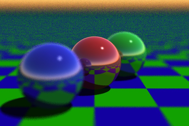

> per square.
And another - same geometry, but using a 105mm lens at f/5.6.
Download '105mm_f5.6.jpg' (82 KB)
Preview of image '105mm_f5.6.jpg'
