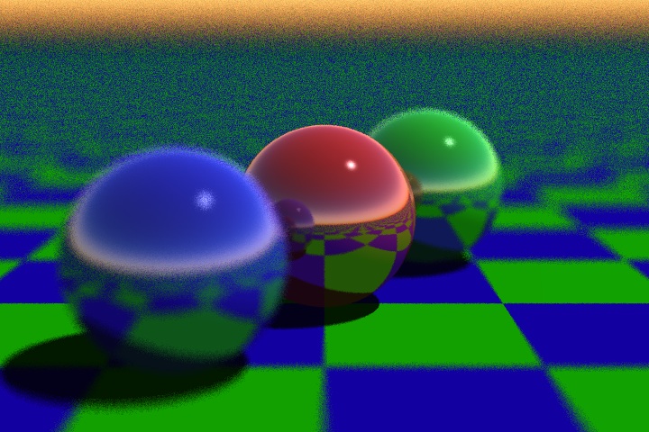

A simple macro I put together that approximates a 35mm camera in the scene.
Should do the correct field of view and a vaguely plausible focal blur. Feel
free to fix any obvious (and even not so obvious) flaws...
The example picture uses a 50mm lens at f1.4. The three balls are 100mm in
diameter, with the center ball 500mm from the camera. The checkerboard is 100mm
per square.

Cheers,
Edouard.
Download '50mm_f1.4.jpg' (136 KB)

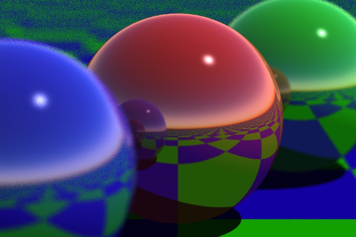

> per square.
And another - same geometry, but using a 105mm lens at f/5.6.
Download '105mm_f5.6.jpg' (82 KB)
Preview of image '105mm_f5.6.jpg'
