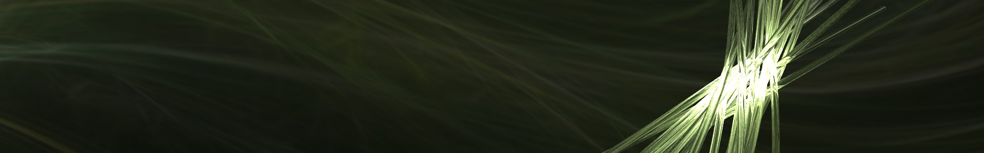

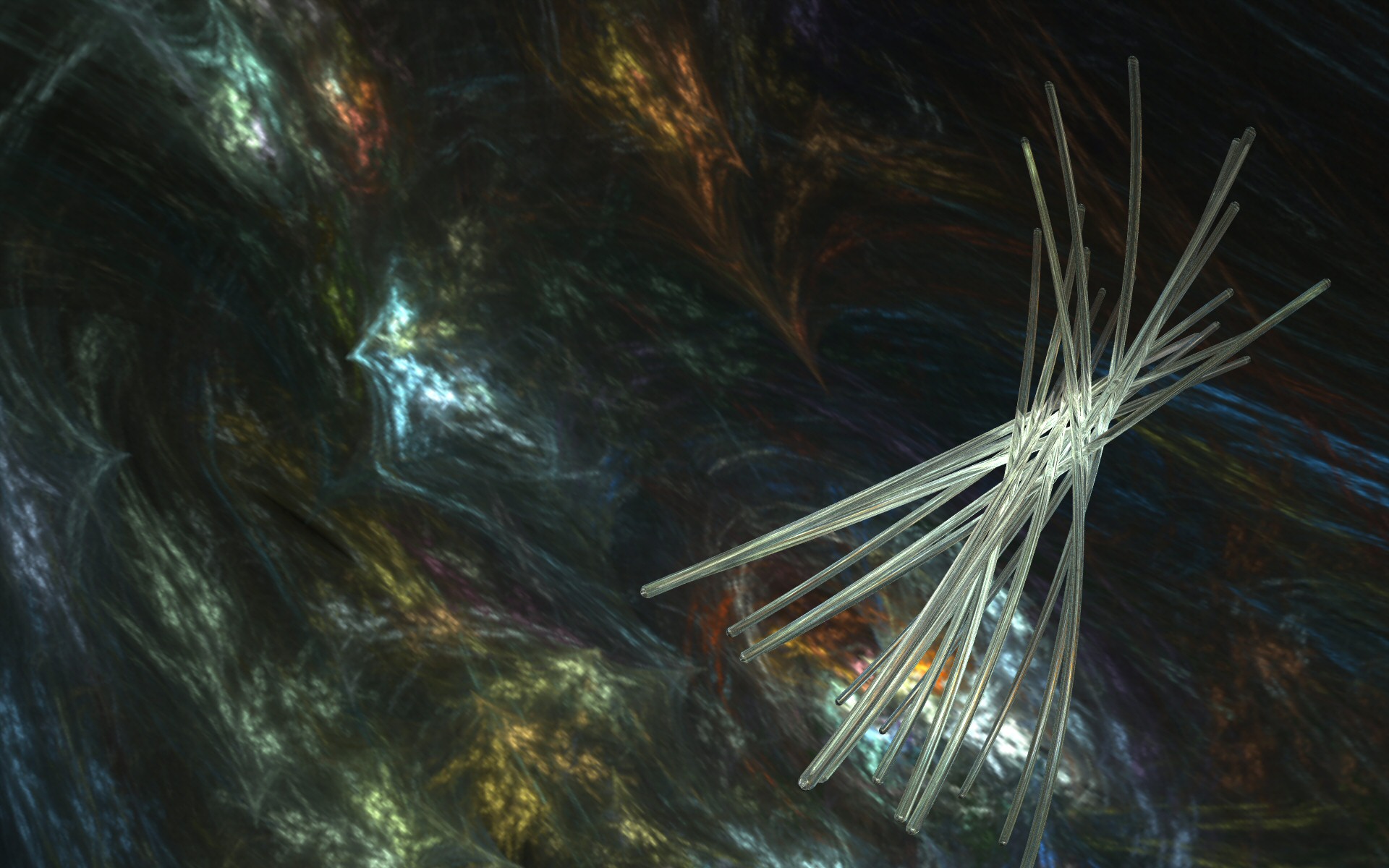

Mid-week abstract anyone?
Just a small test, which uses a few techniques which perhaps might be of
interest for some?
First, it's a simple way of randomly placing a lot of objects without them
intersecting. The code should speak for itself, but I don't know if this method
is entirely bulletproof?
Second, I wanted to use an image I did with apophysis (
http://www.apophysis.org/ ). The resolution was a bit too low though, and I
lost the settings to remake it. So I blurred it by averaging the image several
times in a while loop. I've blurred procedural textures this way before, but it
works quite well with image_maps also.
I'd love to see some "remixes" of this scene! The source is below, and I can
post the background image if anyone's interested.
(Pinnedyr means phasmatodea/walking sticks in Norwegian).
-Peter

Download 'pinnedyr_01.jpg' (129 KB)
Preview of image 'pinnedyr_01.jpg'

Just an quick example with glass.inc, which works for my background:
global_settings{max_trace_level 20}
#include "glass.inc"
object{OBJ
        texture{
                pigment {rgbf 1}
                finish{F_Glass2}
        interior{I_Glass2}
Have a nice weekend, and thanks for all the comments everyone!
-Peter
From: Peter Hertel
Subject: Re: Blurred apophysis meets traced cylinders
Date: 7 Mar 2009 18:10:00
Message: <web.49b2fe11202941c22611931b0@news.povray.org>
After 8h 36m (with some of the time in low priority), this was not a that quick
test after all ;) Maybe max_trace_level was a tad too high.
Well, I liked the result, so here it comes. Ultra-wide this time.
-Peter

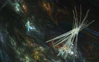

Here is with glass.inc.
Does not look so bright as you example, but the glass-like texture is more
pronounced than in my earlier image. I used max_trace_level 10. I do not see
any black spots, so that looks ok. Render time was about 30 minutes on my
machine (Pentium D 2x3GHz).
Download 'Pinnedyr_01.jpg' (368 KB)
Preview of image 'Pinnedyr_01.jpg'
