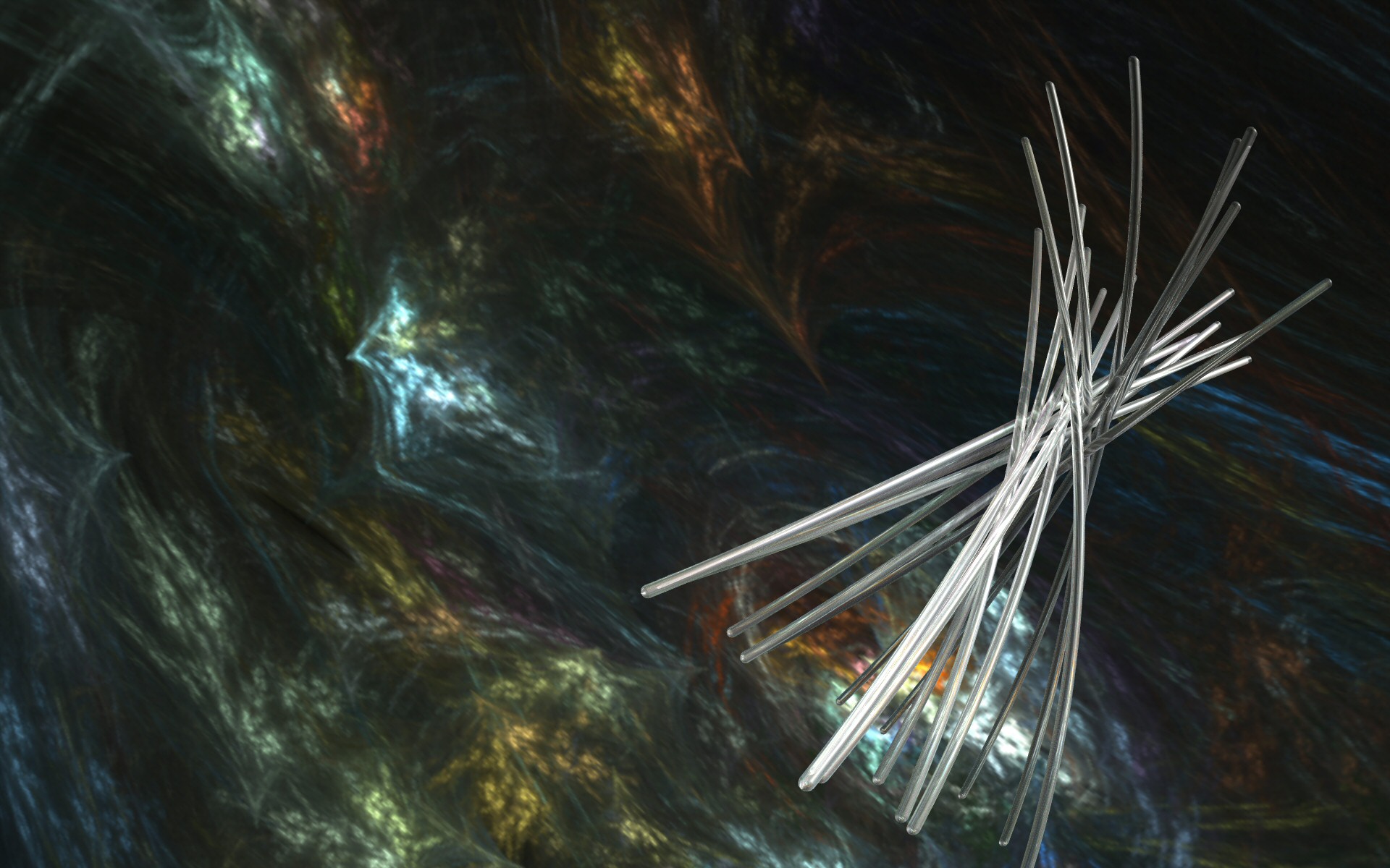

Mid-week abstract anyone?
Just a small test, which uses a few techniques which perhaps might be of
interest for some?
First, it's a simple way of randomly placing a lot of objects without them
intersecting. The code should speak for itself, but I don't know if this method
is entirely bulletproof?
Second, I wanted to use an image I did with apophysis (
http://www.apophysis.org/ ). The resolution was a bit too low though, and I
lost the settings to remake it. So I blurred it by averaging the image several
times in a while loop. I've blurred procedural textures this way before, but it
works quite well with image_maps also.
I'd love to see some "remixes" of this scene! The source is below, and I can
post the background image if anyone's interested.
(Pinnedyr means phasmatodea/walking sticks in Norwegian).
-Peter
// +w1920 +h1200 +a0.3
// +w1920 +h400 +a0.3
camera{
        ultra_wide_angle
        location <1,3,-5>*0.3 look_at y*1 angle 130
        sky vrotate (<0,1,0>,z*40)
        translate <-1,-0.5,-1>
        right x*image_width/image_height
        up y
light_source{<5,15,-10>1}
#local TO = plane{y,0} // Trace Object
#local Radius = 0.025; // Radius of cylinders
#local S = seed(1337);
#local X = 0;
#while (X<1)
        #local Shoot_Start     =
vrotate(<1-rand(S)*0.5,3+sin(X*4*pi)*0.1+rand(S)*0.2,0>,y*360*rand(S));
        #local Shoot_Direction =
vrotate(<-Shoot_Start.x+rand(S)*0.1,-1.3-rand(S)*0.5,-Shoot_Start.z+rand(S)*0.1>,y*10*rand(S));
        #local Shoot_End       = trace(TO,Shoot_Start,Shoot_Direction);
        #if(Shoot_End.y=0) // If it hits the plane in TO
                #ifndef(OBJ) // Final OBJect
                        #local OBJ = merge{
                #else
                        #local OBJ = merge{object{OBJ}
                #end
                        cylinder{Shoot_Start,Shoot_End,Radius}
                        sphere{Shoot_Start,Radius}
                        sphere{Shoot_End,Radius}
                #local TO =
                union{
                        object{TO}
                        cylinder{Shoot_Start,Shoot_End,Radius*2} // Radius
doubled to avoid collision
        #end
#local X = X+0.001; // Decrease to shoot more cylinders
#end
object{OBJ
        texture{
                pigment {rgb 0.9 filter 0.9}
                finish{reflection {0.2,0.6} ambient 0.1 specular 0.4 phong 0.3
irid{0.25 thickness 1}}
        interior{ior 1.255 fade_color x*2 fade_power 2}
#local AP = 0.05; // increase/decrease to blur less/more
// These settings worked well for my 1920x1200 image_map
sky_sphere{
        pigment{
        average
                pigment_map{
                        #local X = 0;
                        #while (X<1)
                                [AP+X*AP, image_map{png
"Apophysis-081026-214_1000.png" interpolate 2 map_type 1}rotate y*(35+1*X)]
                        #local X = X+AP;
                        #end
Download 'pinnedyr_01.jpg' (129 KB)

Here is one.
Download 'Pinnedyr.jpg' (360 KB)
Preview of image 'Pinnedyr.jpg'

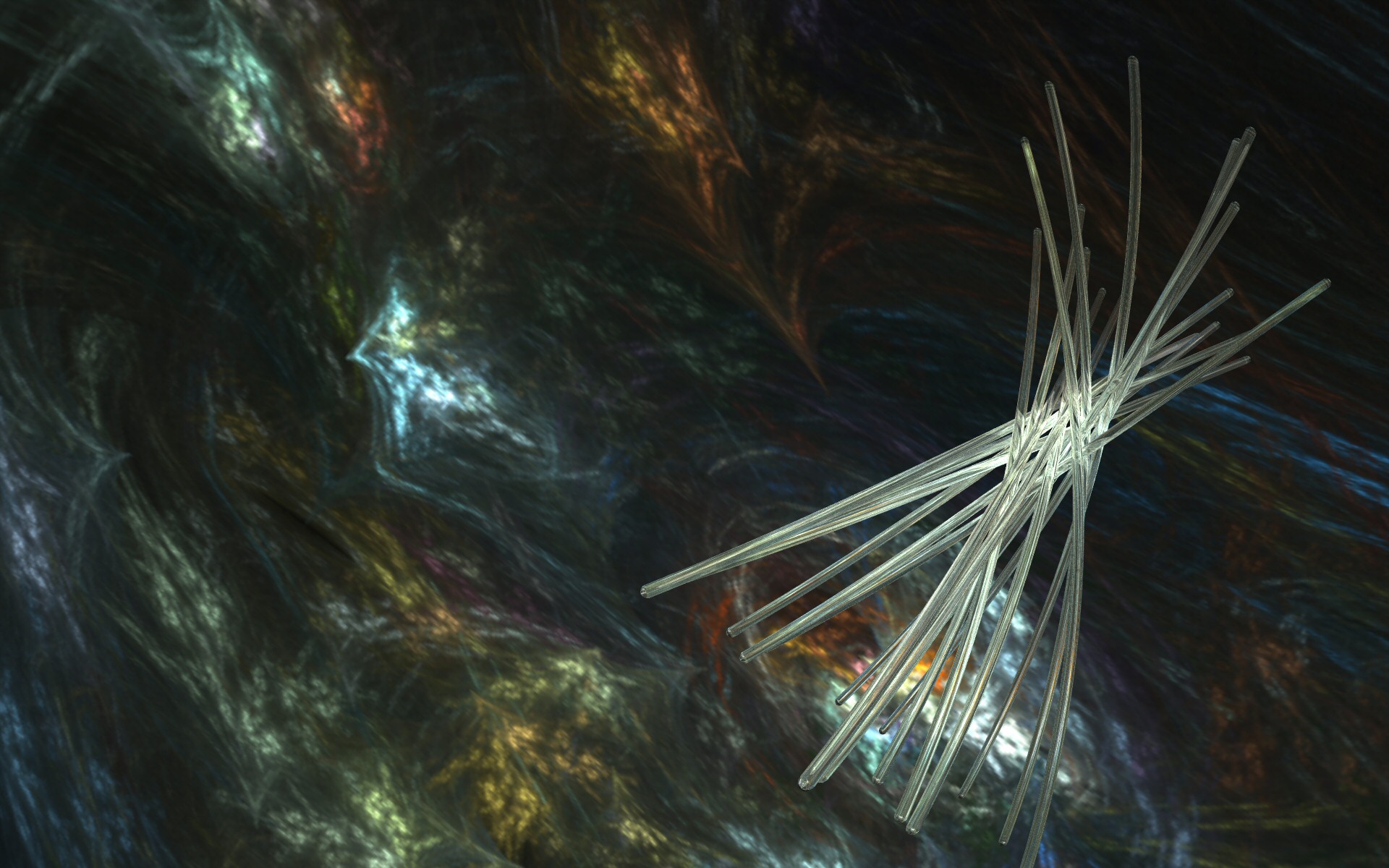

Just an quick example with glass.inc, which works for my background:
global_settings{max_trace_level 20}
#include "glass.inc"
object{OBJ
        texture{
                pigment {rgbf 1}
                finish{F_Glass2}
        interior{I_Glass2}
Have a nice weekend, and thanks for all the comments everyone!
-Peter
From: Peter Hertel
Subject: Re: Blurred apophysis meets traced cylinders
Date: 7 Mar 2009 18:10:00
Message: <web.49b2fe11202941c22611931b0@news.povray.org>
After 8h 36m (with some of the time in low priority), this was not a that quick
test after all ;) Maybe max_trace_level was a tad too high.

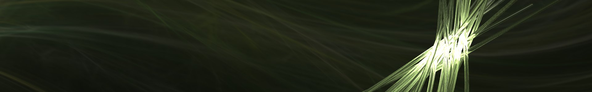

Well, I liked the result, so here it comes. Ultra-wide this time.
-Peter
Download 'pinnedyr_03.jpg' (48 KB)
Preview of image 'pinnedyr_03.jpg'

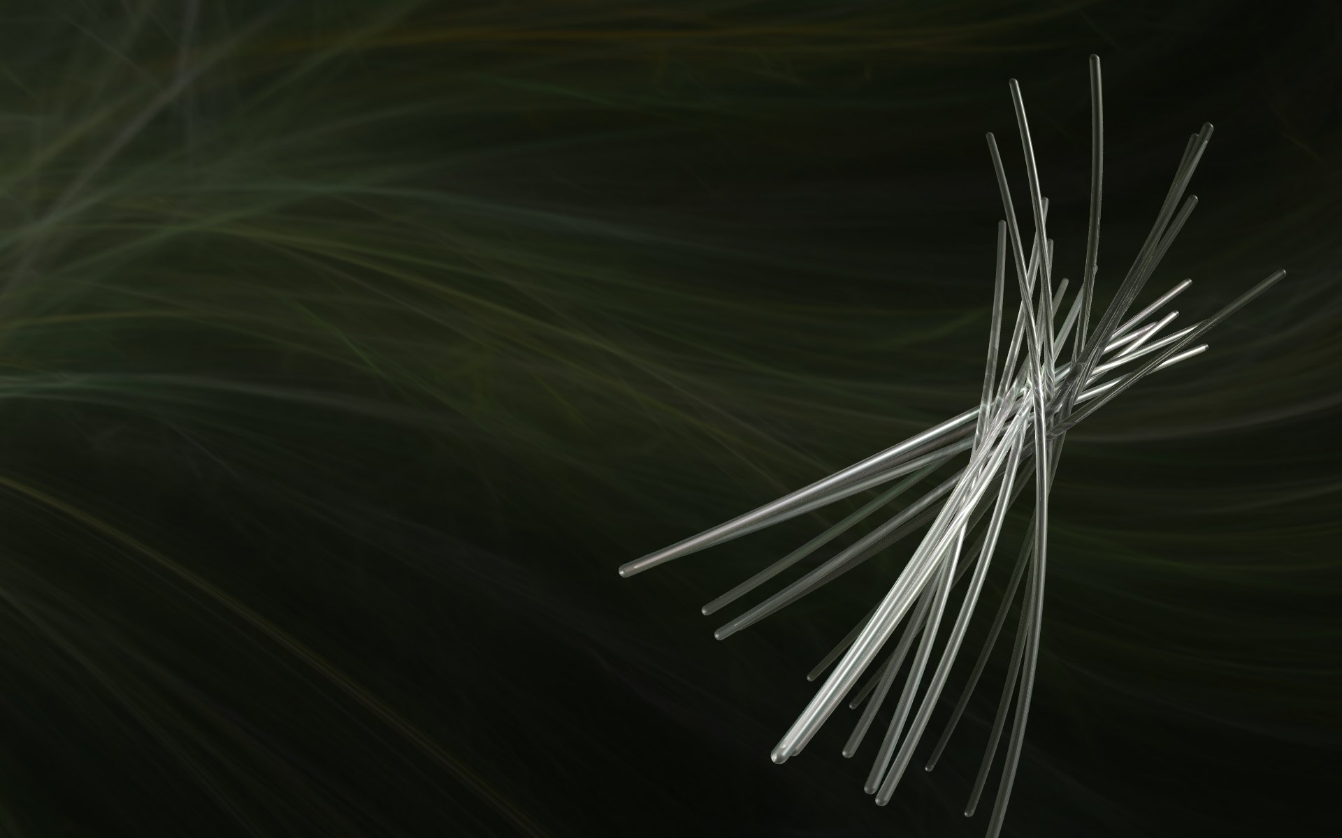

Here is with glass.inc.
Does not look so bright as you example, but the glass-like texture is more
pronounced than in my earlier image. I used max_trace_level 10. I do not see
any black spots, so that looks ok. Render time was about 30 minutes on my
machine (Pentium D 2x3GHz).
Download 'Pinnedyr_01.jpg' (368 KB)
Preview of image 'Pinnedyr_01.jpg'
