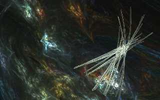

Here is one.
Download 'Pinnedyr.jpg' (360 KB)
Preview of image 'Pinnedyr.jpg'

> Here is one.
> Thomas
Wow, that looks really nice!
I've been trying to add such a colorful background myself, but have failed
miserably. It would be interesting to see your scene with a more glasslike
texture.

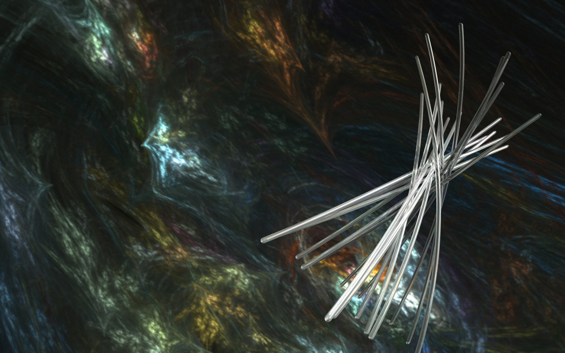

From: Peter Hertel
Subject: Re: Blurred apophysis meets traced cylinders
Date: 7 Mar 2009 18:10:00
Message: <web.49b2fe11202941c22611931b0@news.povray.org>
> Just an quick example with glass.inc, which works for my background:
After 8h 36m (with some of the time in low priority), this was not a that quick
test after all ;) Maybe max_trace_level was a tad too high.
Well, I liked the result, so here it comes. Ultra-wide this time.
-Peter
Download 'pinnedyr_03.jpg' (48 KB)
Preview of image 'pinnedyr_03.jpg'

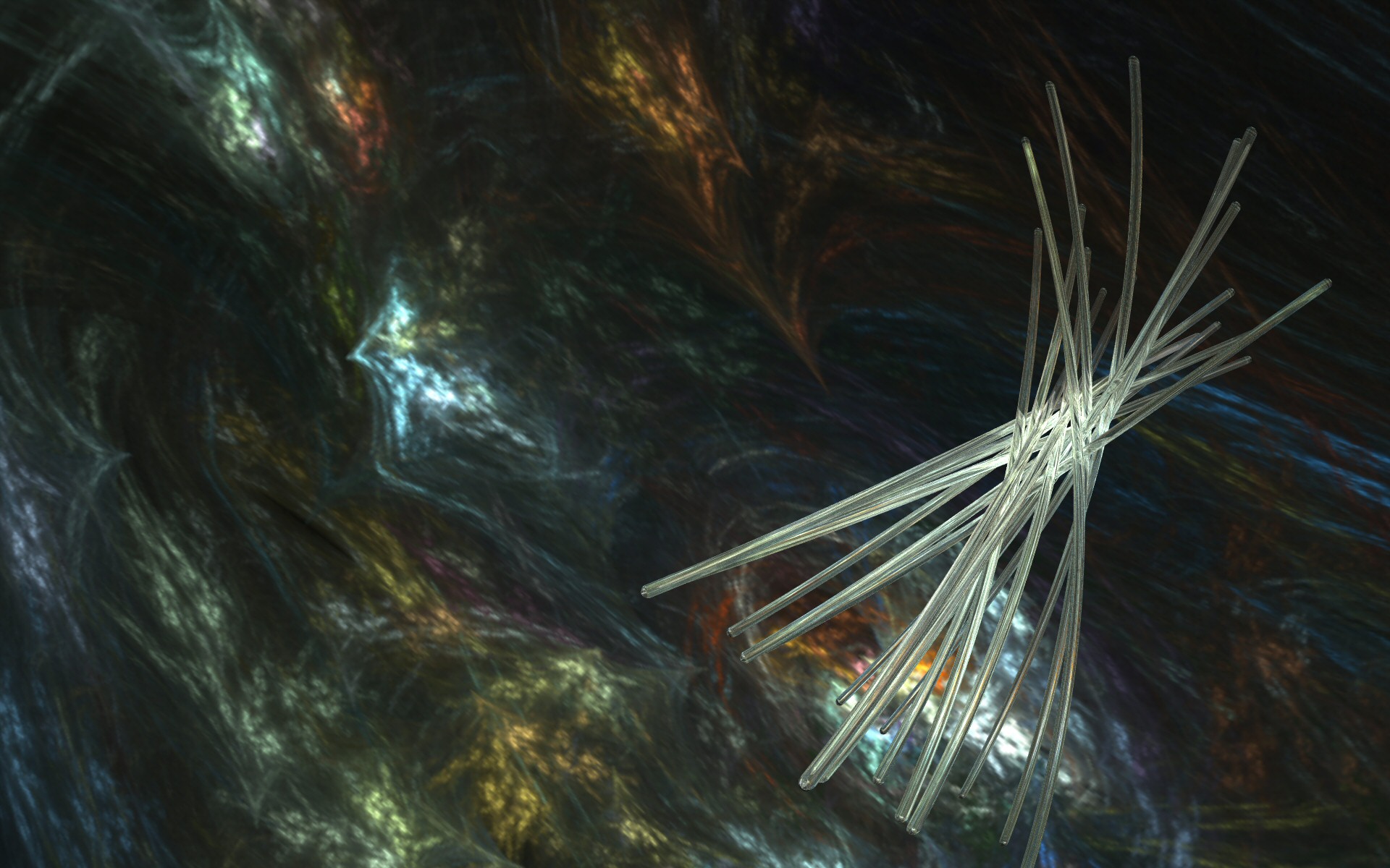

Date: 9 Mar 2009 06:01:19
Message: <49b4e8ef@news.povray.org>
Here is with glass.inc.
Does not look so bright as you example, but the glass-like texture is more
pronounced than in my earlier image. I used max_trace_level 10. I do not see
any black spots, so that looks ok. Render time was about 30 minutes on my
machine (Pentium D 2x3GHz).
Download 'Pinnedyr_01.jpg' (368 KB)
Preview of image 'Pinnedyr_01.jpg'
