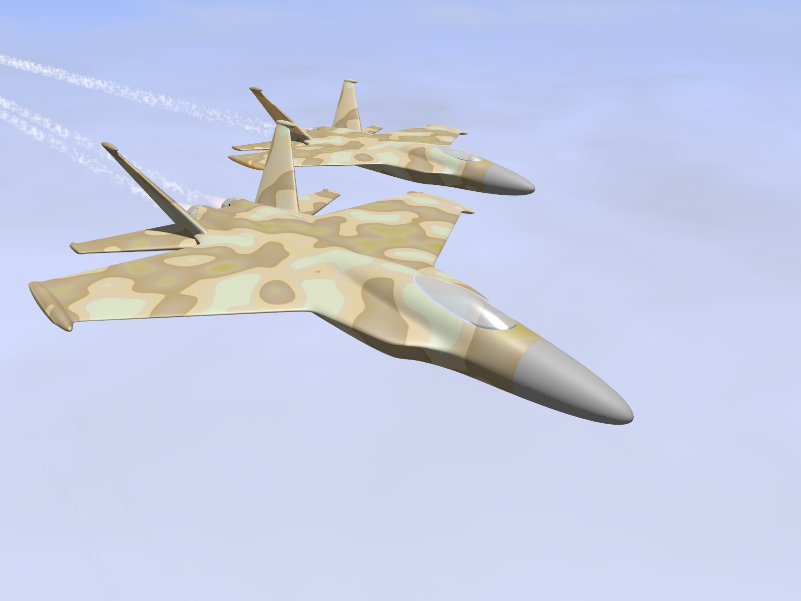

Hi,
I have posted about my jet named the M22 before but I decided that it was time
to post a picture of it.  This render is at 1600x1200 with 0.3 antialiasing and
it took roughly 3.5 days to render.
CREDITS
-thanks to Kevin Loney, Jaap Frank and Tor Olav Kristensen for there isosurface
to mesh conversion include file
-thanks to Rune Skovbo Johansen for his particle system which was used to make
the smoke trail
-thanks to the POV community for all the help whether directly or indirectly
-thanks to the POV-Ray developers for developing such a great piece of software
A little background:
I started modeling this jet 100% in POV-Ray SDL back in March 2008.  I've worked
on it very slowly since then.  The chassis version you see here is an
isosurface, but I also have mesh and CSG versions.  I started this whole thing
because I eventually wanted to make a dogfight sequence but that's a long way
away.
By the way I am aware of the following problems with this render.
-there are 2 artifacts at the engine-nozzle area
-where the cockpit glass meets the main chassis of the plane the blue colour is
suppose to be dark grey
-there is a small shading artifact on the nose cone of the closer plane
All comments and criticisms are welcome.
Bridgeofstraws
Download 'm22 sample scene 3.jpg' (340 KB)
Preview of image 'm22 sample scene 3.jpg'

It's good to know someone else takes interest in jets as much as I do. :)  To
answer your questions, I do intend to add control surfaces, landing gear,
weapons, a fully automatable cockpit, and a pilot.  This project will take
quite a while but I imagine it will be worth it.  I've already developed a way
to do the flight path animation.  I used 2 spline to do this.  One spline is
used to adjust the jet's roll while the second spline is for actually moving
the jet.  I used the Reorient_Trans with the direction my jet normally faces
(before moving it or rotating it) and a rough approximation of the derivative
of the spline at the current point in time.  The reason I used this instead of
the spline_trans is because I had to move the smoke trail in a way not possible
with the spline_trans macro.  The spline_macro should work great if you are just
moving the jet.  Even if you wanted a lot of control on the banking you could
use the spline_trans with no banking and use a separate spline to roll, similar
to what I did.
I can understand why you're making the aircraft as meshes.  If I was much better
at mesh modeling I would too.  They`d certainly make longer animations more
possible because they are so fast to render.  Something that may interest you
is that half the rendering time was spent on the smoke trail because of the
high max trace level I had to use to remove artifacts and the amount of media
the smoke uses.
Bridgeofstraws

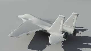

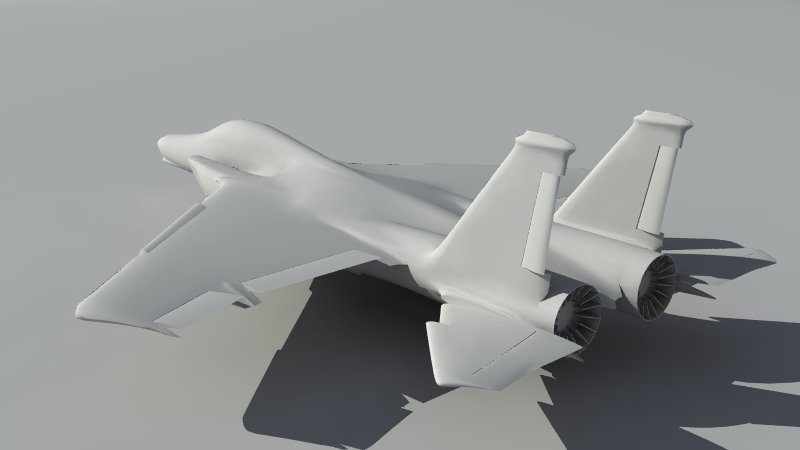

P.S. Attached is an untextured view of the model in progress. The mesh file is
about 1.4 MB, stats on a P4 3.0GHz (single core):
Peak memory used:          35522439 bytes
Total Scene Processing Times
  Parse Time:    0 hours  0 minutes  0 seconds (0 seconds)
  Photon Time:   0 hours  0 minutes  0 seconds (0 seconds)
  Render Time:   0 hours  5 minutes 32 seconds (332 seconds)
  Total Time:    0 hours  5 minutes 32 seconds (332 seconds)
CPU time used: kernel 10.88 seconds, user 313.52 seconds, total 324.39 seconds
Render averaged 1109.77 PPS over 360000 pixels
Download 'ac10 test_2.jpg' (23 KB)
Preview of image 'ac10 test_2.jpg'
From: Jörg 'Yadgar' Bleimann
Subject: Re: A Jet Fighter
Date: 17 Dec 2008 08:55:48
Message: <494904e4$1@news.povray.org>
High!
Nice contrails - but usually, they start only at a certain distance from
the jet nozzle, as the exhaust gases need to cool to crystallize!
See you in Khyberspace!
Yadgar

The engine effect for my jet was done using a fairly turbulent bozo patterned
emissive media with a cone shaped container.  Right now it isn't the best, but
it is a start.  If you like I may be able to render some closer up views of the
flame.

I really like your aircraft.  I can't believe how smooth the mesh for it is.
Did you use radiosity to light the scene?  Anyways, that is an awesome
aircraft.

Thank you, and yes, I did use radiosity (when it is untextured and the plane is
white, it is hard to see exactly what is going on).  The mesh is fairly smooth,
but there are a few bits that could use more smoothing.  I usually keep the mesh
low density for ease of working, then do a smooth-on-export with recursion level
1.  This means that the working one is about 2000 vertices, whereas a smoothed
export one is closer to 8000.  I plan on making 3 or so resolutions - 2000 is
more than enough for a high-speed moving spec, whereas a ground scene may
require a fully smoothed model, which is closer to ~32000.
Of course, after that, one needs a burning model, a crashing one, an exploding
one, one crashed on the ground, one partially disassembled for maintenance...
Reactor
