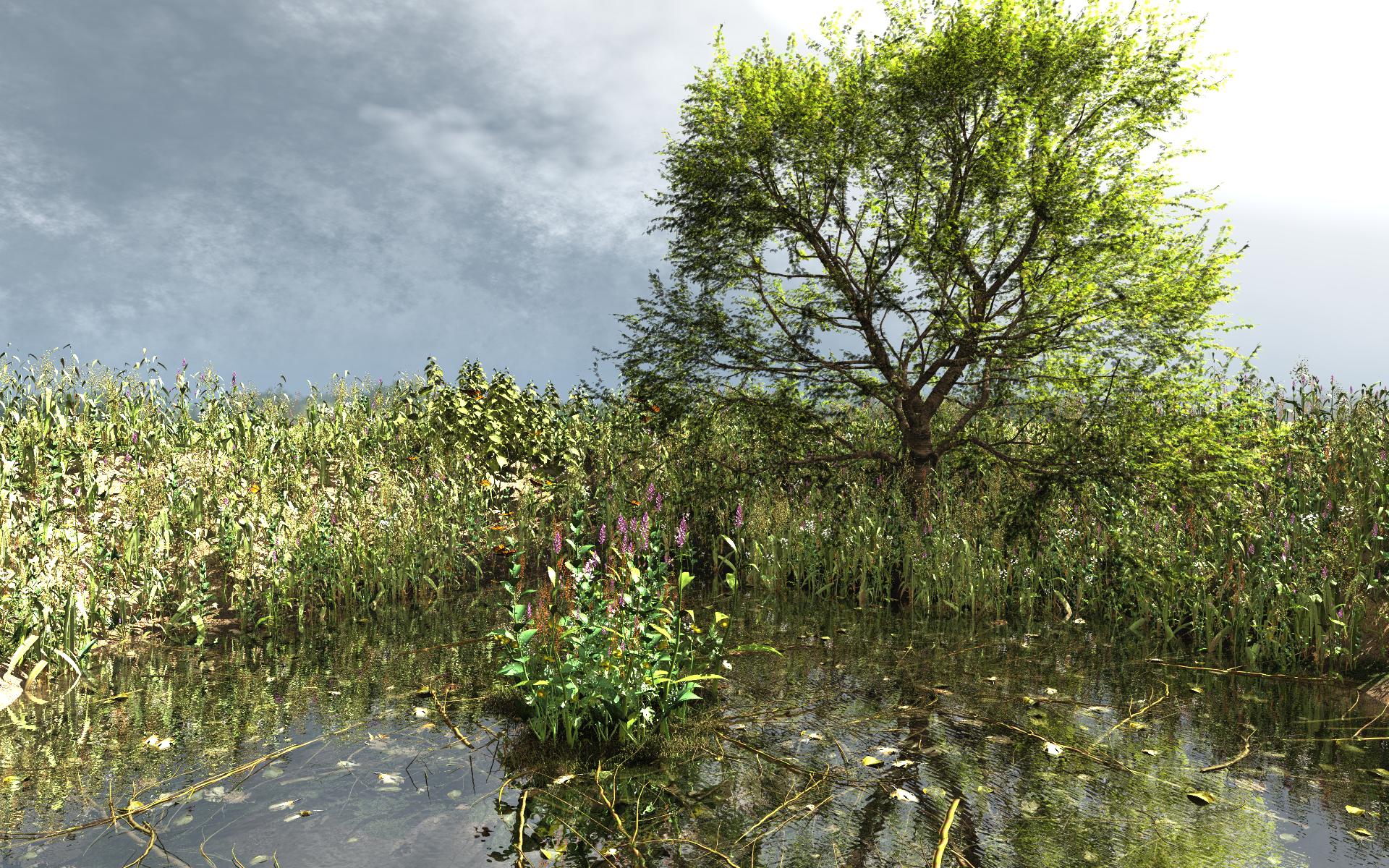

Hi, I am currently trying to render large trees in POV-Ray. I have attached an
image of a prototype scene so you can see what I mean. The scene used was
created by Gilles Tran and is available here:
http://www.oyonale.com/modeles.php?lang=en&page=38
I have just replaced his tree with one of mine.
The issue I am having is that with so many leaves light does not propagate into
the crown of the tree. In the picture I have posted I used a %50 transparent
leaf texture which helps a little but also blurs everything and would look bad
for close up shots.
What I am looking for is a way to make a texture that allows light to pass
through it while not having the object transparent.
Does anyone know how to do this in POV-Ray?
Thanks
-Steve
Download 'tranparentleaves.jpg' (692 KB)
Preview of image 'tranparentleaves.jpg'

From: slongay
Subject: Re: Translucent Leaf Texture
Date: 24 Oct 2008 22:45:00
Message: <web.490287ac694f7e34dc638afc0@news.povray.org>
Thanks for the quick replies.
To give proper credit one of the guys in my lab is designing a program which
creates those trees. I'm only in charge of getting them into POV-Ray, putting
them in a landscape and making nice pictures.
I currently do use the double illuminate but this only allows the light to
illuminate the other side of the leaf and not pass through it to illuminate
into the crown.
I have tried using 2 instances of my leaves mesh, one with transparency and
shadows but no image and the other without transparency and shadows but with
image. It does help to brighten the crown slightly but I still have some
playing to do. I will give media a shot tomorrow and then post the results.
Thanks
-Steve
