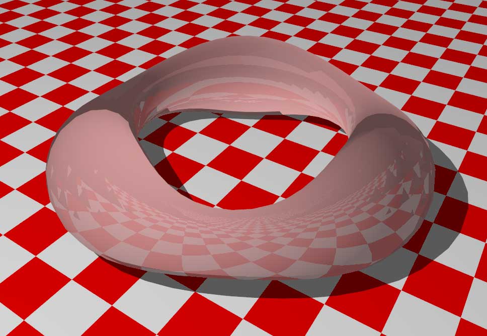

From: B  Gimeno
Subject: calculating normal vector FH
Date: 25 Sep 2008 17:35:00
Message: <web.48dc038462133541a5f67c3f0@news.povray.org>
thread in povray.general
B. Gimeno
Download 'bt_test.jpg' (58 KB)
Preview of image 'bt_test.jpg'

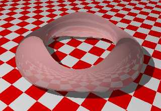

Theory is fine, but understand it and unite with the existing code is a
different story.
I've been trying other methods to "calculate" the normal, like using the same
points of the original object with a differente radius, but it generates
artifacts as this picture shows.
I wonder if even getting correctly calculate the normal vector could it apply to
other kinds of objects like the surface of Klein post <a
href:"http://news.povray.org/web.488a15af4a3fd4ff2380a740%40news.povray.org">
here</a>.
I suppose you know what I mean, the normals should be to reverse as the surface
is folded in on itself generating more artifacts like these. Or not?
B. Gimeno
Download 'bt_test_2.jpg' (70 KB)
Preview of image 'bt_test_2.jpg'

Triangles are still rendered as triangles, the normal is used to
make the highlights act different. The solution to this sort of
thing is to either use more triangles, or switch to isosurfaces.

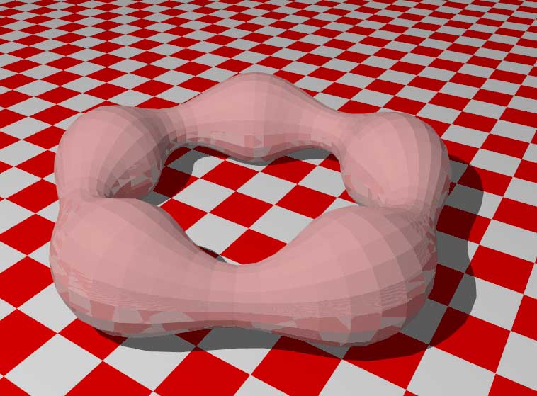

I suspect that B. Gimeno's image might possibly be getting the normals inside
out, at least over part of the surface.
Here's a similar image, created with 900 triangles, that doesn't show the same
effect.
Download 'smoothnormals.jpg' (97 KB)
Preview of image 'smoothnormals.jpg'

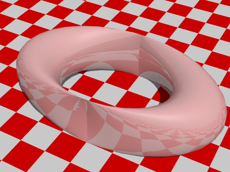

From: Mike Williams
Subject: Re: calculating normal vector FH
Date: 30 Sep 2008 15:24:40
Message: <gc2XgwMszn4IFwOT@econym.demon.co.uk>
Wasn't it B. Gimeno who wrote:
>"Mike Williams" <nomail@nomail> wrote:
>>the same
>> effect.
>Curious object, does it tried to be a torus shape?
>If so, let me see your code, the use of cross-reference between sine and cosine
>functions is wrong and is beyond my level of English and the google's automatic
>translator  ake myself understood, but I think I still remember how to get a
>decent torus with a nested-loop.
It's called a Bohemian Dome.
It's the shape that you get if you hold a circle flat and sweep it
around a circle. For a torus, the diameter of the swept circle always
points to the centre of the torus. For a Bohemian Dome the diameter of
the circle always point in the same direction.
The surface intersects itself. The side that is the inside on one half
is the outside on the other half. And POV even gets that right: it uses
the interior_texture on the outside of one half.
It's generated by these parametric equations:
          x = A*cos(u)
          y = B*cos(v) + A*sin(u)
          z = C*sin(v)
Code to create it using a parametric isosurface (seriously slow) or
using Ingo Janssen's "param.inc" to create a smooth mesh2 to approximate
it (fast) can be found here:
          http://www.econym.demon.co.uk/isotut/param.htm
Mike Williams
