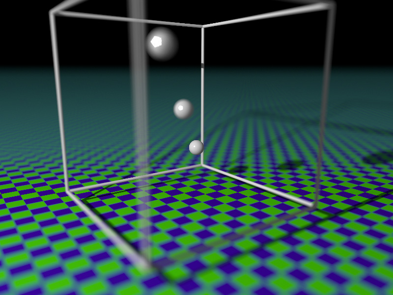

I'd had a version of depth of field blur in my stochastic render rig for some
time, but there was something not quite right with it.
After some time, and reading Paul Bourke's website
(http://local.wasp.uwa.edu.au/~pbourke/modelling_rendering/povcameras/ and
http://local.wasp.uwa.edu.au/~pbourke/projection/stereorender/ helped the most)
I realised that I had made the classic blunder, and was moving the camera to
achieve focal blur, which gave me a focal point, and not a focal plane.
The correct solution, as Paul and others have pointed out, is to use a shear
operation (which POV-Ray supports via a transform { matrix <...> } line in the
camera { ... } declaration.
If you are looking down the z axis, then all you need is
camera {
    transform { matrix <1, 0, 0,  0, 1, 0,   rx, ry, 1,   0, 0, 0> }
where rx and ry are the amount of shearing that occurs, and therefore the amount
of depth of field blur.
If you are not looking along the z axis, then you need to transform the camera
so it is along the z axis, do the shear, then transform it back.
The results are exactly what I was after to start with, but had gotten wrong - a
nice clear focal plane, passing through the look_at point, and parallel to the
image plane.
Cheers,
Edouard.
Download 'dof-shear-fixed.jpg' (153 KB)
Preview of image 'dof-shear-fixed.jpg'

Attached is my test object with focal blur using the technique above - I'd
posted one a few days ago, but this one has the corrected focal blur, and does
look a little better for it.
This image also has anti-aliasing done by moving both the camera and look_at
points by a sub-pixel distance in x and y based on a random gaussian function.
Not having anti-aliasing per frame I'm rendering speeds things up quite
noticeably.
The code adds the following over what I posted above:

The next big challenges (and I'm not sure I'm quite up to the task - maths is
not my strong point) is to define the focal blur in terms of the aperture for
the angle of the camera (i.e. the "lens"), and to automatically set the
aa_scale value based on the camera angle, camera to look_at distance, and image
size being rendered.

I've merged 10000 images with it, plus doing it all at the end eliminates the
any possible accumulation errors that might build up.
> Good work, at any rate. Have you tried moving the camera in a circular fashion
> to produce an even result? I've got an array of 227 points distributed evenly
> within a circle, if you are interested.
Usually a random distribution seems to work well, and different scenes require a
different number of frames to look good.
Actually one issue I've noticed is that I think that the random number generator
in POV-Ray isn't quite as randomly distributed as I would like - esp with
averaging deep DoF and specular highlights (or HDR reflections of point light
sources) I notice a discernible pattern appearing in the bokeh. I guess I could
test it by loading a random array produced externally (with some high quality
RNG)  and comparing the results.
> Sam
Cheers,
Edouard.

From: Edouard Poor
Subject: Re: Stochastic render rig focal blur FIXED
Date: 22 Aug 2008 19:50:00
Message: <web.48af4f8e90c1c695dbf7248f0@news.povray.org>

Random Number Generator - POV-Ray's "rand()" (and "seed()"). POV's one is fast,
but, I'm suspecting, may show patterns when you use it in particular ways. An
interesting example of another RNG that was used in the past, but had problems
when used for 3D data, is at
http://www.cs.pitt.edu/~kirk/cs1501/animations/Random.html - POVs RNG is better
than that one I think, but might still show some non-randomness.
> Sam
Cheers,
Edouard.
