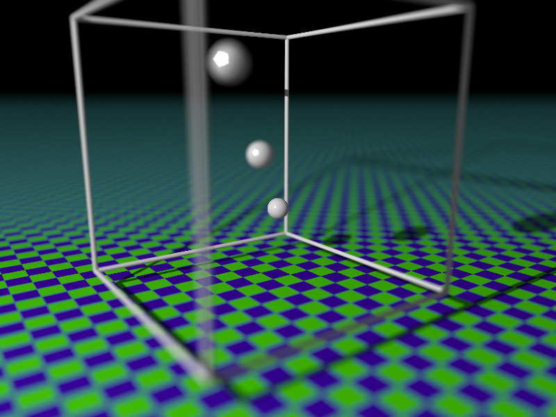

I'd had a version of depth of field blur in my stochastic render rig for some
time, but there was something not quite right with it.
After some time, and reading Paul Bourke's website
(http://local.wasp.uwa.edu.au/~pbourke/modelling_rendering/povcameras/ and
http://local.wasp.uwa.edu.au/~pbourke/projection/stereorender/ helped the most)
I realised that I had made the classic blunder, and was moving the camera to
achieve focal blur, which gave me a focal point, and not a focal plane.
The correct solution, as Paul and others have pointed out, is to use a shear
operation (which POV-Ray supports via a transform { matrix <...> } line in the
camera { ... } declaration.
If you are looking down the z axis, then all you need is
camera {
    transform { matrix <1, 0, 0,  0, 1, 0,   rx, ry, 1,   0, 0, 0> }
where rx and ry are the amount of shearing that occurs, and therefore the amount
of depth of field blur.
If you are not looking along the z axis, then you need to transform the camera
so it is along the z axis, do the shear, then transform it back.
The results are exactly what I was after to start with, but had gotten wrong - a
nice clear focal plane, passing through the look_at point, and parallel to the
image plane.
Cheers,
Edouard.
Download 'dof-shear-fixed.jpg' (153 KB)
Preview of image 'dof-shear-fixed.jpg'
From: Edouard Poor
Subject: Re: Stochastic render rig focal blur FIXED
Date: 21 Aug 2008 07:00:00
Message: <web.48ad4a4390c1c695dbf7248f0@news.povray.org>
Source code to the above post.
(Also - I know this has been solved a bunch of times before, but this code
should also be useful to anyone wanting to create stereo pairs - just cut out
the random iris sampling stuff, and just set rx to +some_value the -some_value
(and ry to zero), and your got the two stereo render pairs you need.)
#include "transforms.inc"
#declare s = seed( frame_number );
#declare lens_shape =
 function {
  pigment {
   image_map {
    png "pentagon-outlined.png"
    once
#declare found = false;
#while ( found = false )
 #declare test_pos = <rand(s), rand(s), 0>;
 #declare test_value = lens_shape( test_pos.x, test_pos.y, test_pos.z ).red;
 #if ( pow( rand(s), .333 ) <= test_value )
  #declare lens_offset = test_pos - <0.5,0.5,0>;
  #declare found = true;
 #end
#end
#declare rx = lens_offset.x * 0.05;
#declare ry = lens_offset.y * 0.05;
#declare cam_location = <-10, 8, -15>;
#declare look_location =<3, 3, 3>;
#declare eye_direction = look_location - cam_location;
camera {
 perspective
 transform {
  translate look_location * -1
  Reorient_Trans( eye_direction, z )
  Reorient_Trans( z, eye_direction )
 location cam_location
 look_at look_location
 angle 60
 right x * 1
 up y * image_height/image_width
light_source {
 < -20, 15, -5>
 rgb 1
plane {
 <0.0, 1.0, 0.0>, 0.0
 material {
  texture {
   pigment {
    checker
    rgb <0.123476, 0.000000, 0.998413>,
    rgb <0.107591, 0.993164, 0.000000>
   finish {
    diffuse 0.6
    brilliance 1.0
sphere {
 <0, 6, 0>, 0.5
 pigment { rgb 1 }
 finish { specular 50 roughness 0.001 }
sphere {
 <-3, 9, -3>, 0.5
 pigment { rgb 1 }
sphere {
 <3, 3, 3>, 0.5
 pigment { rgb 1 }
union {
 cylinder {
  <-5, -5, -5>, <-5, -5, 5>, 0.1
 cylinder {
  <5, -5, -5>, <5, -5, 5>, 0.1
 cylinder {
  <-5, 5, -5>, <-5, 5, 5>, 0.1
 cylinder {
  <5, 5, -5>, <5, 5, 5>, 0.1
 cylinder {
  <-5, -5, -5>, <-5, 5, -5>, 0.1
 cylinder {
  <-5, -5, 5>, <-5, 5, 5>, 0.1
 cylinder {
  <5, -5, -5>, <5, 5, -5>, 0.1
 cylinder {
  <5, -5, 5>, <5, 5, 5>, 0.1
 cylinder {
  <-5, -5, -5>, <5, -5, -5>, 0.1
 cylinder {
  <-5, 5, -5>, <5, 5, -5>, 0.1
 cylinder {
  <-5, -5, 5>, <5, -5, 5>, 0.1
 cylinder {
  <-5, 5, 5>, <5, 5, 5>, 0.1
 translate y*6
 pigment { rgb 1 }

From: Samuel Benge
Date: 21 Aug 2008 17:10:01
Message: <web.48add8e190c1c695b6b777fb0@news.povray.org>
This is useful information! Thanks! I occasionally mess around with averaged
frames, and I can get a certain kind of focal_blur by moving the camera
around... but this looks even better :)
Sam
