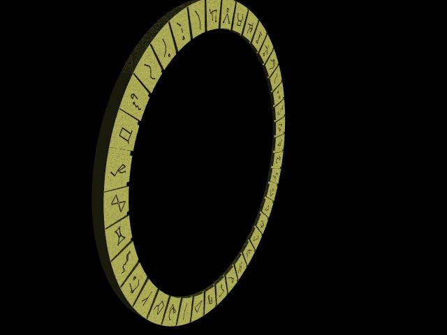

Just to inflict interest, here a poor man's attempt:
Needs so much work. Like building a model, argh. Crude bumped disk so far.
Download 'stargate2.png' (360 KB)
Preview of image 'stargate2.png'
I've watched the show enough to know the stargate consists of 6 parts,
The outer ring, the inner ring, the chevrons, the top lights, the side
lights,
and the water fountain effect in the middle.
The outer ring is just a cylinder ring with some gear-like crenellations
around the inside lip. It's mostly textured with a stone-like normal,
and a smooth spot where the locks might engage.
The inner ring has all the interesting glyphs (39?), I think you could
save those out as heightfield images, it's probably most of the detail
of the stargate. There's some ribs between the glyphs, more
crenellation on a lip, and a tapered inner edge.
The chevrons are the same shape all the way around the ring,
they're T shaped, following the same curve as the disk, the
V shaped part has grating for lights (there is an inner solid
lip unlike the model you linked to, and I think there's more than
six slots for light). The chevrons move in and out to lock the
gate in position.
The top lights are brighter, along with it's 4 chevron lights,
which shine thru the chevron grates. The light frame is
mostly translucent, and doesn't move.
The side lights are dimmer, I think they might only have
2 side lights shining through the chevron grates as well.
The bottom lights are the same as the side lights,
you just never see them usually, in Stargate: Atlantis you
see them in space sometimes.
The center effect probably could be done with something
like Rune's particle system.
http://runevision.com/3d/include/particles/

From: Chris B
Subject: Re: StarGate
Date: 23 Jun 2008 14:26:47
Message: <485feae7$1@news.povray.org>
"Tim Attwood" <tim### [at] comcastnet> wrote in message
news:485eec4c$1@news.povray.org...
>> far.
Sounds like a perfect collaborative project for the object collection.
I reckon I can do the Glyphs for the Milky Way stargate pretty quickly
because there's an SVG by Max Willis on the Wiki, so I can convert them into
prism objects using Inkscape and cut them out of the inner disk using CSG.
So does the inner ring have a wedge shaped cross-section?
Chris B.

From: Chris B
Date: 23 Jun 2008 20:11:10
Message: <48603b9e@news.povray.org>
"Chris B" <nom### [at] nomailcom> wrote in message
news:485feae7$1@news.povray.org...
>>> far.
> into
I've posted the 39 Glyphs as prism objects on povray.binaries.scene-files
along with this very crude scene file that cuts them out of segments of a
ring and assembles the segments into a circle. If anyone wants to use them
to make a stargate I'd be happy to go through and scale and centre them as
needed.
Chris B.
Download 'Stargate.JPG' (20 KB)
Preview of image 'Stargate.JPG'
