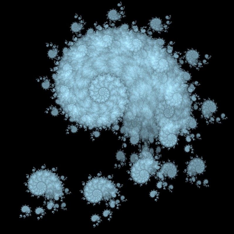

Last February, Sam Benge introduced a very cool technique and some great images,
created by iterative mapping of images onto discs:
http://news.povray.org/povray.binaries.images/thread/%3C47bf6f44%40news.povray.org%3E/?ttop=275374&toff=100
He also provided the code:
http://news.povray.org/povray.binaries.scene-files/thread/%3C47bfbb8e%40news.povray.org%3E/
This technique can also be used to produce "normal" (Iterated Function System)
fractals, using the condensation set method (repeated shrinking, moving and
pasting), as opposed to the more familiar "chaos-game" bouncing dot method.
Just to make sure I was understanding what was going on, I rendered the same
fractal using Povray and Iterative Imaging (the first picture), and then using
the chaos-game approach, with Apophysis ( http://www.apophysis.org ).
Because the condensation set method involves repeated shrinking, round-off
errors quickly accumulate, unless you render the image very large.  I made this
one 3200 x 3200.  I've included a close-up of the actual size, also.
Since rendering this, I thought of a way to eliminate the "cut-off" where the
fractal goes off the edge of the box.  I now use planes, and just shrink and
map the pigments on the planes.  Also, when the fractal overlaps itself, you
need to choose which plane goes on top -- this leads to slightly different
images, even though the actual attractors are the same.
Download 'spiral7_99.jpg' (127 KB)
Preview of image 'spiral7_99.jpg'

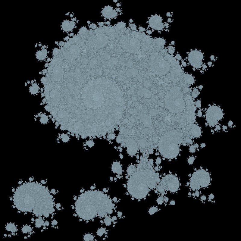

From: Dave Matthews
Subject: Re: Iterative Imaging and IFS
Date: 10 Jun 2008 00:45:00
Message: <web.484e0603fcea2f82d64794640@news.povray.org>
Here's the Apophysis picture
Download 'spiral7_apophysis.jpg' (115 KB)
Preview of image 'spiral7_apophysis.jpg'

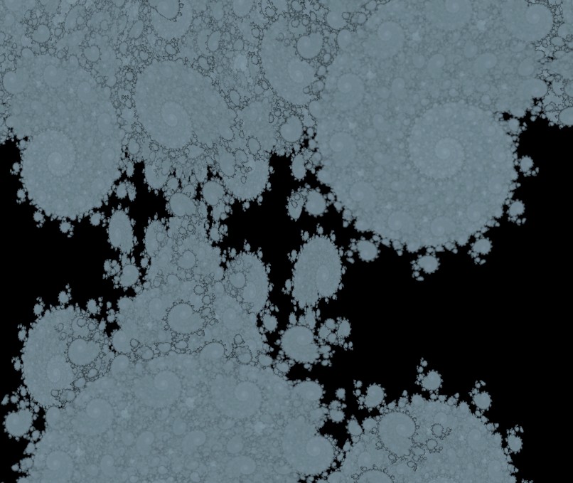

From: Dave Matthews
Message: <web.484e063bfcea2f82d64794640@news.povray.org>
And here's a close-up of the POVRay image
Download 'spiral7_99closeup.jpg' (120 KB)
Preview of image 'spiral7_99closeup.jpg'
From: stbenge
Date: 10 Jun 2008 01:32:01
Message: <484e11d1@news.povray.org>
Cool image.
I'm not sure I understand your exact method, but I'm sure it helps. Why
is the POV-Ray render hard-edged, while the Apophysis image looks soft?
You could probably get a smoother result by fiddling with the pigment.
It would be nice to generate these images in POV without also generating
a long sequence of animation frames. If there was a way to rename the
output image in POV without using an external application to do so, I
would be pretty happy about it :) Maybe I'll raise a question in p.a-u.
I was actually thinking of this earlier, but found no solution in the
documentation. I found no working solution short of calling an external
program to rename the file, anyway. I don't know how to make C++ rename
a file, so I'm sort of stuck.
Sam

From: Dave Matthews
Date: 11 Jun 2008 00:15:01
Message: <web.484f5047fcea2f82d64794640@news.povray.org>
stbenge <stb### [at] hotmailcom> wrote:
> Cool image.
Thanks.
There are 2 reasons why the Apophysis image looks softer.  The first is that it
is made by tracking a bouncing dot around the plane, while the condensation
method is made by repeatedly projecting images onto the plane, so that you keep
seeing the edges of the (smaller and smaller) images.
The other reason is that Apophysis has a rendering option that lets you
oversample, and then it interpolates the results.
> Sam
I'm trying to follow Christian's suggestions, but they are a bit beyond me, so,
for now, I don't really mind going back and dumping a bunch of intermediate
images.  Also, sometimes the final frame isn't the best image, so it's nice to
look back up and see which one "works."
Here's the code, as I adapted it.  I'm working on fixing it up a bit more.
Also, by adding different backgrounds, and messing with the transparencies, you
can get some pretty neat effects -- I'll share a few and you can probably come
up with better ideas (you usually do!)
// Condensation IFS adapted from S. Benge
// final_frame will determine the number of iterations.
// Make sure that file_name, below, matches your name for the file!
global_settings{
 assumed_gamma 1.0
camera{
 orthographic
 right x*2 up y*2
 location <0, 0, -20>
#default{ finish{ambient 1 } }
#declare file_name = "CondIFS2";
#declare Number_Of_Transforms = 3;
#declare T_array = array[Number_Of_Transforms];
// The last transform in the array will be on the plane that is closest to
// the camera.
#declare T_array[0] = transform {scale <-0.5, 0.6, 1>
  translate <0.3, -0.1, -0.07> };
#declare T_array[1] = transform { scale <0.9, 0.9, 1>  rotate 30*z
   translate <.04, 0.13, -0.1> };
#declare T_array[2] = transform { scale <0.26, 0.26, 1>
   translate <-0.72, -0.72, -0.15>  };
#macro M2(T_,n_o_t_)
union {
#local J = 0;
#while (J < n_o_t_)
plane { -z, 0.05*(J+1)
      pigment { pigm
      transform { T_[J]} } }
#local J = J + 1;
#end }
#end
#macro scene_elements()
#declare FIN = function { pigment { image_map { png file_name once} } };
#declare pigm=
 pigment { function{FIN(x,y,z).gray} pigment_map { [0.0   color rgbt <0,0,0,1>]
 [0.01   color rgbt <0,0,0,1>]
 [0.01  image_map {png file_name once}    ] } scale 2 translate <-1, -1, 0>};
M2(T_array, Number_Of_Transforms)
#end
#declare fn = frame_number;
#if(fn>1)
 #if(fn<11)
  #declare file_name=concat(file_name,"0",str(fn-1,0,0),".png");
  #else
  #declare file_name=concat(file_name,str(fn-1,0,0),".png");
 #end
 scene_elements()
#else
  plane{z,1
  pigment {  rgb <0.5, 0.7, 0.9> } }
#end

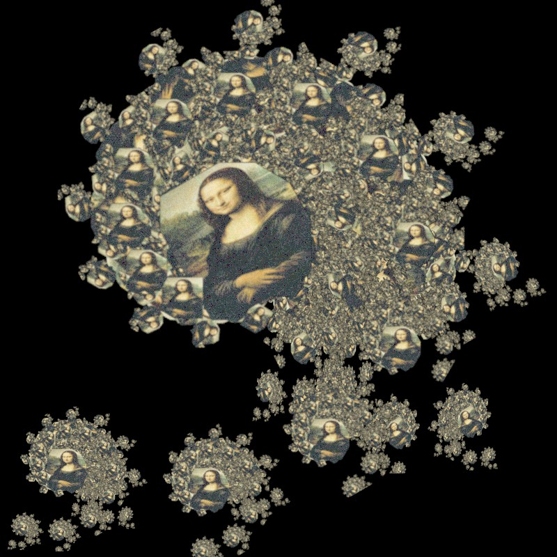

One thing you can do, of course, is change the initial image from a boring blue
plane.
(This also helps show how the IFS is generated, I think.)
