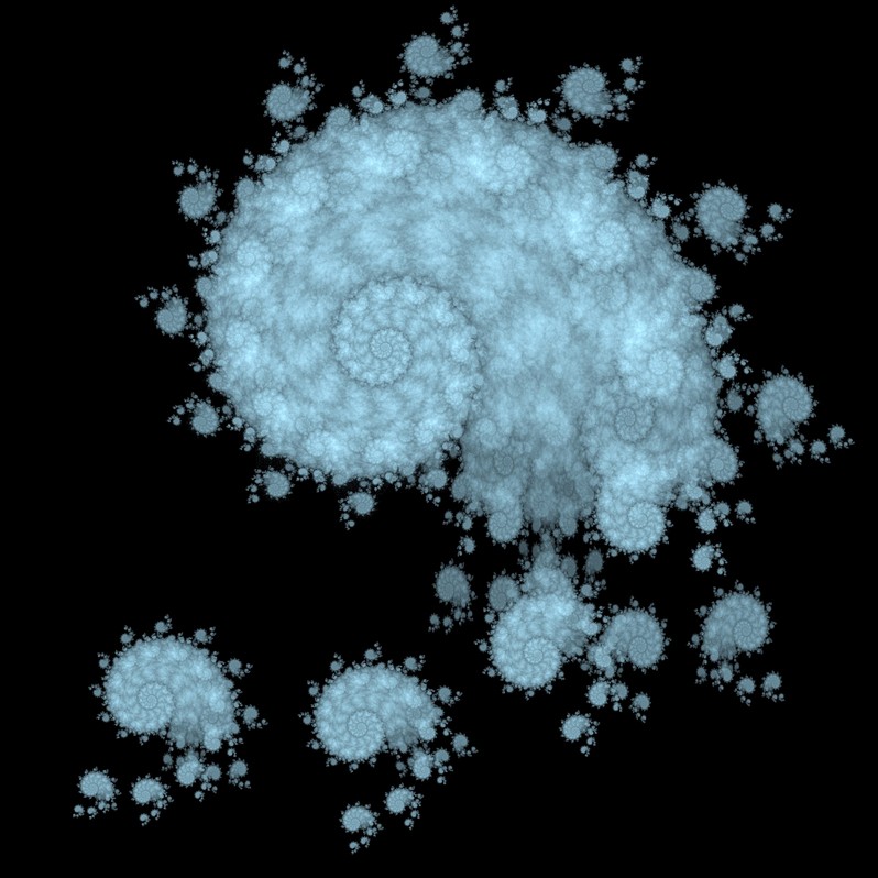

Last February, Sam Benge introduced a very cool technique and some great images,
created by iterative mapping of images onto discs:
http://news.povray.org/povray.binaries.images/thread/%3C47bf6f44%40news.povray.org%3E/?ttop=275374&toff=100
He also provided the code:
http://news.povray.org/povray.binaries.scene-files/thread/%3C47bfbb8e%40news.povray.org%3E/
This technique can also be used to produce "normal" (Iterated Function System)
fractals, using the condensation set method (repeated shrinking, moving and
pasting), as opposed to the more familiar "chaos-game" bouncing dot method.
Just to make sure I was understanding what was going on, I rendered the same
fractal using Povray and Iterative Imaging (the first picture), and then using
the chaos-game approach, with Apophysis ( http://www.apophysis.org ).
Because the condensation set method involves repeated shrinking, round-off
errors quickly accumulate, unless you render the image very large.  I made this
one 3200 x 3200.  I've included a close-up of the actual size, also.
Since rendering this, I thought of a way to eliminate the "cut-off" where the
fractal goes off the edge of the box.  I now use planes, and just shrink and
map the pigments on the planes.  Also, when the fractal overlaps itself, you
need to choose which plane goes on top -- this leads to slightly different
images, even though the actual attractors are the same.
Download 'spiral7_99.jpg' (127 KB)
Preview of image 'spiral7_99.jpg'

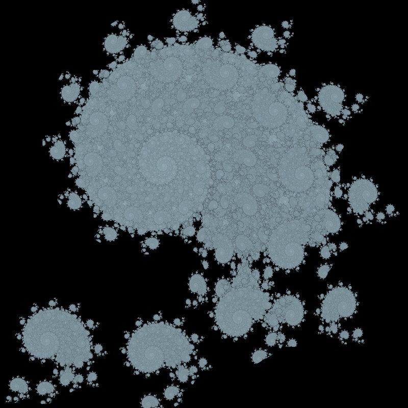

Here's the Apophysis picture
Download 'spiral7_apophysis.jpg' (115 KB)
Preview of image 'spiral7_apophysis.jpg'

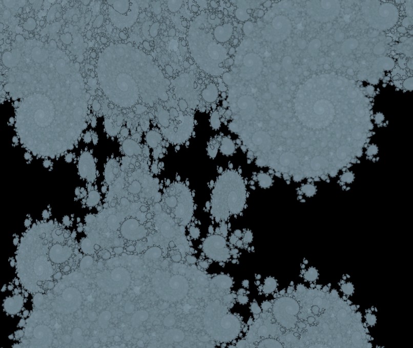

And here's a close-up of the POVRay image
Download 'spiral7_99closeup.jpg' (120 KB)
Preview of image 'spiral7_99closeup.jpg'

stbenge <stb### [at] hotmailcom> wrote:
> Cool image.
Thanks.
> I'm not sure I understand your exact method, but I'm sure it helps. Why
> is the POV-Ray render hard-edged, while the Apophysis image looks soft?
> You could probably get a smoother result by fiddling with the pigment.
There are 2 reasons why the Apophysis image looks softer.  The first is that it
is made by tracking a bouncing dot around the plane, while the condensation
method is made by repeatedly projecting images onto the plane, so that you keep
seeing the edges of the (smaller and smaller) images.
The other reason is that Apophysis has a rendering option that lets you
oversample, and then it interpolates the results.

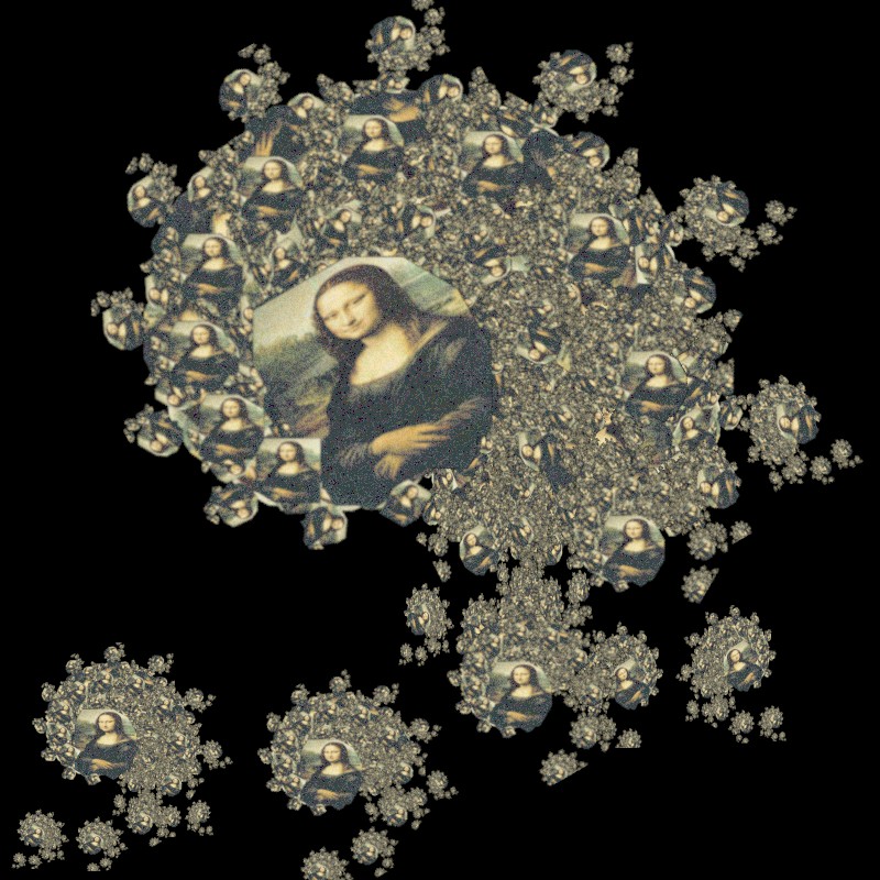

Here's the code, as I adapted it.  I'm working on fixing it up a bit more.
Also, by adding different backgrounds, and messing with the transparencies, you
can get some pretty neat effects -- I'll share a few and you can probably come
up with better ideas (you usually do!)
Actually, the "solution" eliminates one "cut-off" error, the one that occurs
when the fractal goes off the edge of the box (the discs in Sam's method), but
there's no way that I know of to eliminate the other "cut-off" error, the one
that occurs when a piece of the fractal goes out of the camera's view, since
all that gets mapped back is what the camera sees.
From: Dave Matthews
Subject: Re: Iterative Imaging and IFS
Date: 11 Jun 2008 00:45:00
Message: <web.484f57ccfcea2f82d64794640@news.povray.org>
One thing you can do, of course, is change the initial image from a boring blue
plane.
(This also helps show how the IFS is generated, I think.)
Download 'condensationmona02.jpg' (178 KB)
Preview of image 'condensationmona02.jpg'
