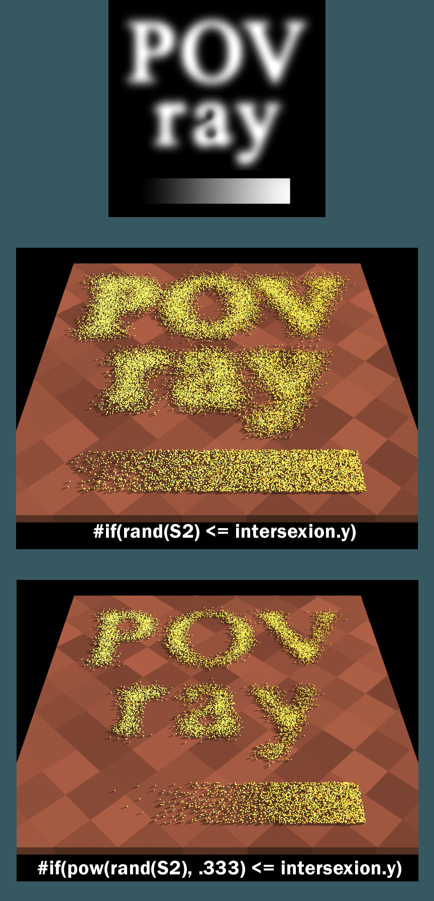

Here's a simple demonstration, using lots of small spheres as the 'sprayed-on'
objects (intersexion.y is the height found at any point on the masking HF):

How this works: If intersexion.y is, say, .2--corresponding to a low point on
the HF and a relatively dark pixel in the blurry image_map--and if rand(S2) has
an equal chance of being *anywhere* between 0 and 1 (which it does), then there
is only a 20% chance that rand(S2) will be <= .2, and thus only a 20% chance of
an object being made in that case. (Said another way: If rand(S2) is greater
than .2, no object is made.) If intersexion.y is .9999--representing a very
high point on the HF and a bright pixel in the image_map--then rand(S2) has a
99.99% chance of being at or below that value...meaning that an object WILL be
made, no question. Taken as a whole, the code thins out the number of objects
in the 'blur zone'--more objects in brighter areas, less in darker areas. The
result looks like objects sprayed through an airbrush!
For everything to work as-expected, the blurry image_map grayscale values need
to go from pure black to pure white, so that the resulting traced y-values of
the HF go reliably from 0 to 1. (BTW, "smooth" doesn't have any effect on a HF
when tracing it--that's purely a lighting trick based on normals.) Changing <=
in the code to >= has the effect of inverting the image_map's grayscale
values...resulting in MORE objects in the dark areas, LESS in the bright areas.

#if(pow(rand(S2), .333) <= intersexion.y)

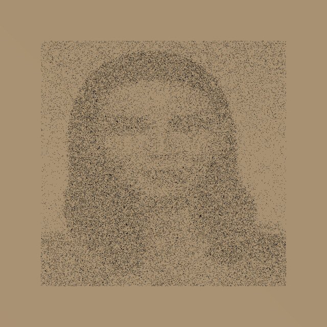

Just a very rapid example, taking a random photograph I had, without
particular blurring I must say, but still a nice result.
Thanks again, Kenneth!!
Download 'Kenneth airbrush.jpg' (103 KB)
Preview of image 'Kenneth airbrush.jpg'

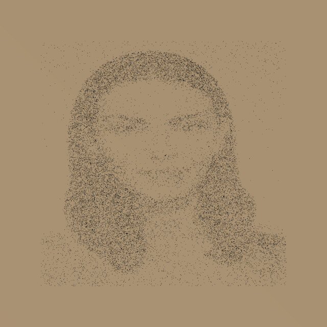

...and using  pow(rand(S2), .333)....
Download 'Kenneth airbrush2.jpg' (67 KB)
Preview of image 'Kenneth airbrush2.jpg'

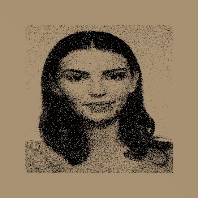

...and increasing the number of objects (x10 Kenneth's example).
And now I stop!  :-)
Download 'Kenneth airbrush3.jpg' (103 KB)
Preview of image 'Kenneth airbrush3.jpg'
