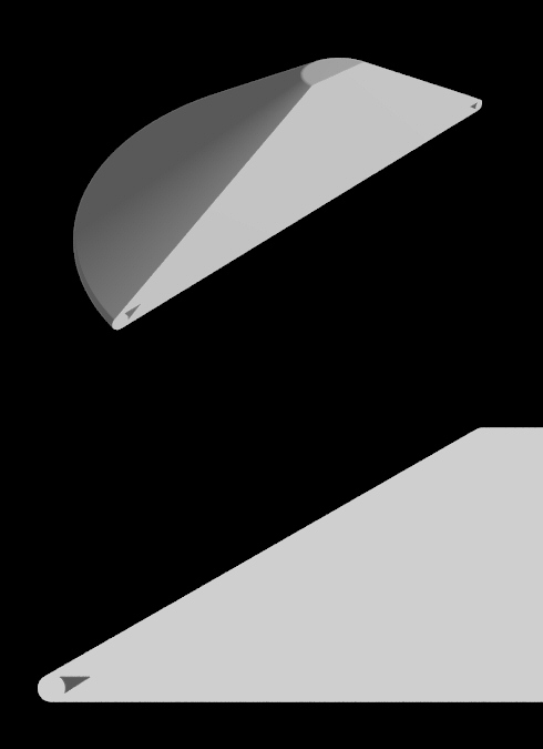

I've found a bug in the Round_Cone macros in shapes.inc. I'm not sure if this
counts as a 'proper' POV-ray bug, but I wanted to post an illustration too so
it can go here for now. Should I also post this to povray.bugreports?
Anyway, the problem is that for very shallow-angled cones (i.e.,
baseradius-topradius >> height), there is a small gap running around the larger
end, between the torus and the two bulk cones. It is quite clear in the image
below.
It may have an adverse effect on CSG as a union and on transparent cones as a
merge. The fix is quite simple, and involves simply filling the end torii with
cylinders. Just add this code to the body of the macro:
cylinder { PA, PA + 2*Axis*EdgeRadius, R1 }
cylinder { PB, PB - 2*Axis*EdgeRadius, R2 }
anywhere inside the union/merge and after R1 and R2 are defined.
Hope this helps
Bill
Download 'conedemo.jpg' (26 KB)
Preview of image 'conedemo.jpg'

Bill Pragnell nous apporta ses lumieres en ce 2008/04/10 06:37:
> below.
> Hope this helps
> Bill
That gape is always present, even when the top and base radius are the same. The
same apens with the rounded cylinder macro.
Thank for spoting it and posting the correction.
