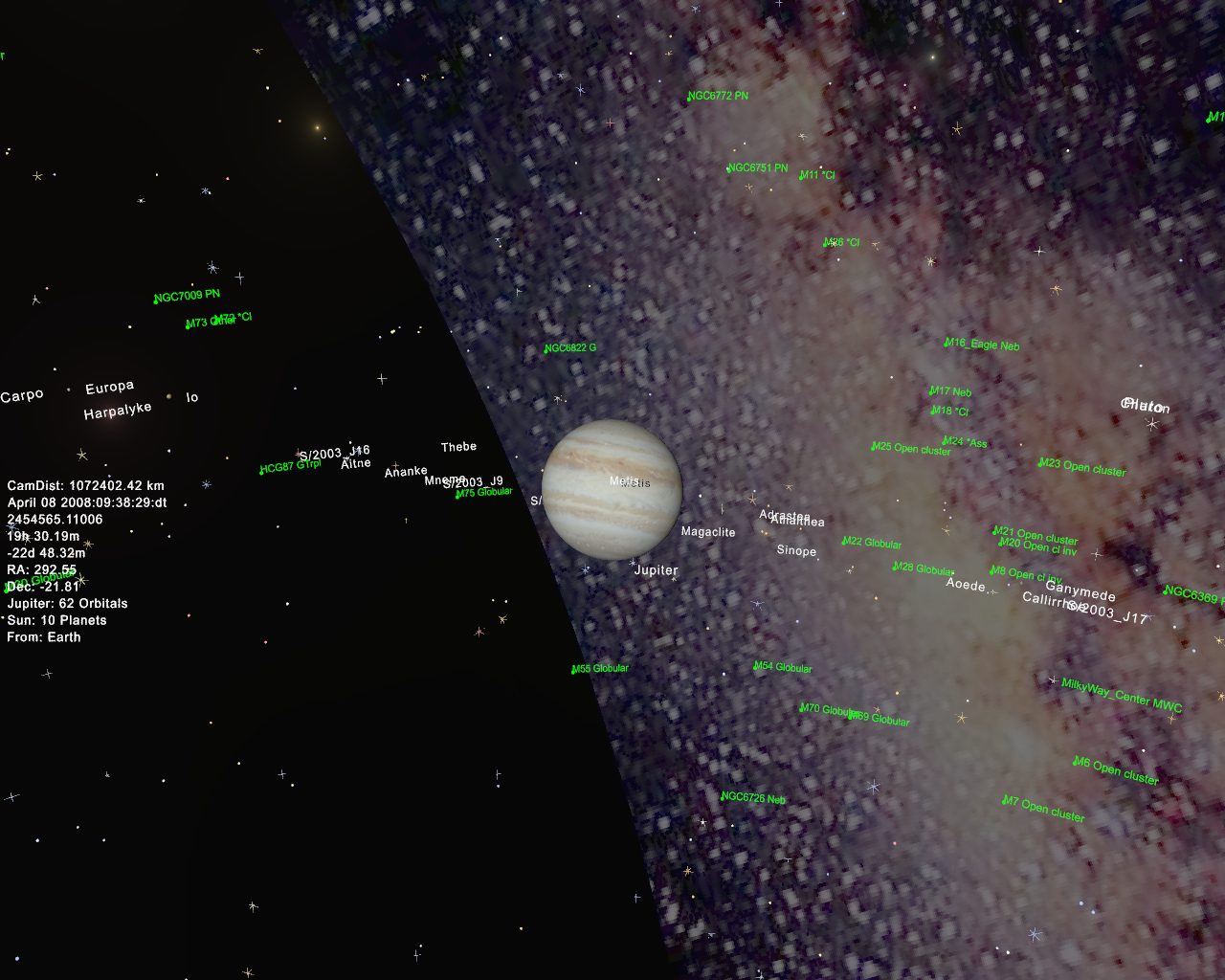

more than just raw guts now
Download 'jupsat.jpg' (193 KB)
Preview of image 'jupsat.jpg'

alphaQuad nous apporta ses lumieres en ce 2008/04/06 21:55:
Nice, but the straight, sharp edge of the "milky way" is bothering me. It should
be prety irregular, more gradual, somewhat fluffy.

Had much difficulty with the text, basically if I stayed away from transform
matrix and rotated a ra and dec, it was much better. But close up on 200 km
rocks with large translations, it was either gone or blurred, settled for
readable blur.

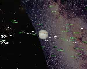

Done:
Set cam view by object name
Access multiple catalog arrays incrementally
Select percent flare and glow stars
Fix Milky way-basically the map has a hard line. Layered out some darker colors;
75 out of 255 in PSP layer properties
The only thing that seems to be wrong with atmosphere now is that it might take
days to render one.
Wonder what might happen if someone with more pov experience than I jumped on
this.
Colors are very faded from jpg compression here. I am seeing more color than
this.
Download 'planetarium3.jpg' (164 KB)
Preview of image 'planetarium3.jpg'

While I am deeply impressed by your planetarium work, it goes way beyond my
capabilities, the one thing that hurts my eyes is the Milky Way map.
Supposing that it is not necessary to reproduce it faithfully, wouldn't an
emitive media give much nicer results? I suppose this would be contained
inside a (flat) torus. Just my 2 cents...
