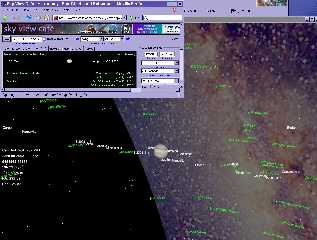

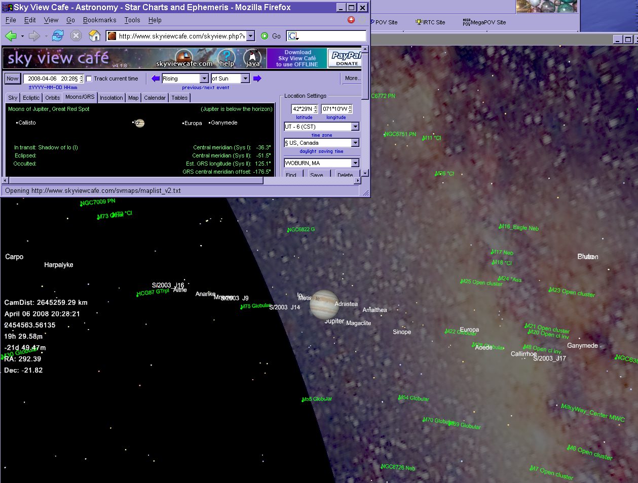

more than just raw guts now
Download 'jupsat.jpg' (193 KB)
Preview of image 'jupsat.jpg'

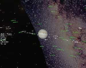

alphaQuad nous apporta ses lumieres en ce 2008/04/06 21:55:
Nice, but the straight, sharp edge of the "milky way" is bothering me. It should
be prety irregular, more gradual, somewhat fluffy.

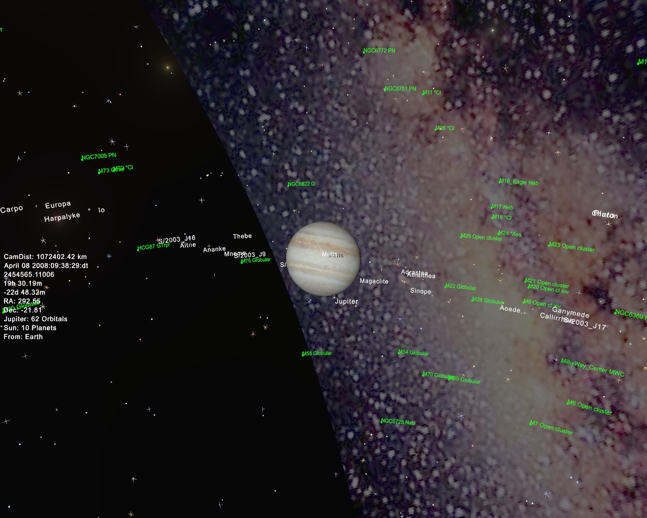

Had much difficulty with the text, basically if I stayed away from transform
matrix and rotated a ra and dec, it was much better. But close up on 200 km
rocks with large translations, it was either gone or blurred, settled for
readable blur.
Done:
Set cam view by object name
Access multiple catalog arrays incrementally
Select percent flare and glow stars
Fix Milky way-basically the map has a hard line. Layered out some darker colors;
75 out of 255 in PSP layer properties
The only thing that seems to be wrong with atmosphere now is that it might take
days to render one.
Wonder what might happen if someone with more pov experience than I jumped on
this.
Colors are very faded from jpg compression here. I am seeing more color than
this.
Download 'planetarium3.jpg' (164 KB)
Preview of image 'planetarium3.jpg'

-22d 48.33m
Dec: -21.81
no one noticed?
First thought it was the round func, but doing this fixed it. (round() was not
used)
Floor rounds up?
#local dm = concat(str(floor(dec),0,0),"d ",
str(round(abs(mod(dec,1.0))*60,2),0,2),"m");
fix: floor(dec-mod(dec,1.0))
#local dm = concat(str(floor(dec-mod(dec,1.0)),0,0),"d ",
Not according to help:
floor(A) Floor of A. Returns the largest integer less than A. Rounds down to the
next lower integer.
Bizzare, but just proven, something perhaps to consider with use of floor().

> Floor rounds up?
> next lower integer.
Including down for negative numbers then,
Modulus gives a negative remainder and adds it, for same as positive value.
My round function rounds up for negative values and down for positive,
but floor rounds down for negative numbers it seems to me. So no floor does NOT
round up in ANY case, heh.
Just thought that was needed, since no one noticed.
Nuthin worse than expecting greatness and getting, WTH?
The word round should be nowhere near the floor description. It should be just
the integer, pos or neg, IMO.
Another logic hurdle melts.
abs(negative) must equal positive. where floor() can get in the way of such
logic.
