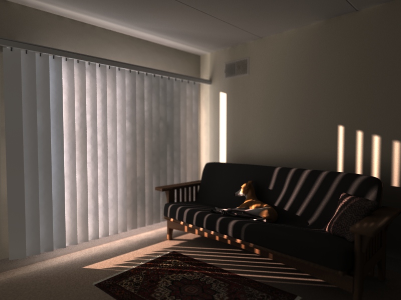

I have to confess I cheated.  This is a combination of two renders.  The low
quality render has fewer artifacts on the blinds because it just smoothes them
over, but lots of artifacts around the ceiling.  The higher quality render cuts
down on artifacts around the ceiling, but causes a lot of artifacts on the
blinds.  I went all the way up to count=1600 without any improvement.  Wherever
there's a gap there are a lot of artifacts.  Does this mean I have not balanced
count and error_bound correctly, or does anyone have other ideas on how I might
improve or fake the rendering quality?  Either way, my tip for the day?  Stay
away from blinds.
 - Ricky

we should need to see your radiosity settings...

Have tried placing an additional area light right in the doorway itself?  The
second area light would be much dimmer of course, and would span the entire
size of the doorway.
Very nice image, by the way.  Despite the artifacts on the blinds, I would not
have known it was a render if were posted elsewhere.  They just look textured
or dirty.  Adds to the realism, even.  :)
Sorry.  Of course.  Here are the settings for the high quality render:
radiosity {
  normal off
  count 300
  recursion_limit 2
  error_bound 0.35
  pretrace_start 0.08
  pretrace_end 0.02
This gives a lot of artifacts.  If I decrease the count to 50 and increase the
error_bound to 0.5, it looks better, but the detail disappears.  That also
increases artifacts around the corners of the walls.  Tried max_sample, but in
reading over the radiosity docs, perhaps I need a lower pretrace_start?
 - Ricky
Yes, there are 3x3 mosaics of area lights that cover the whole window.  One
inside the room and two outside.  There's also a sky_sphere with an rgb 1
pigment.  Without the area lights the render is a lost cause, but the area
lights don't solve everything either.
 - Ricky

As others have said it's a beautiful render, and I would never have thought the
artifacts were such if you hadn't said so.
> radiosity {
>   normal off
>   count 300
>   recursion_limit 2
>   error_bound 0.35
>   pretrace_start 0.08
>   pretrace_end 0.02
I would definitely try lowering pretrace_end, and maybe an error_bound of 0.2 or
0.1. Also, make sure minimum_reuse is nice and small too - the default is 0.015
but you could try 0.01 or 0.005. All of this will slow the render
significantly, but I have found it effective (although every radiosity scene is
different). You may also need to raise count a little too but see how it goes.
I guess you're right.  It's just that the perfectionist in me would rather get
rid of the radiosity artifacts and simulate the same effect with a texture than
consider the artifacts a feature.
Thanks!  I'll try that.
