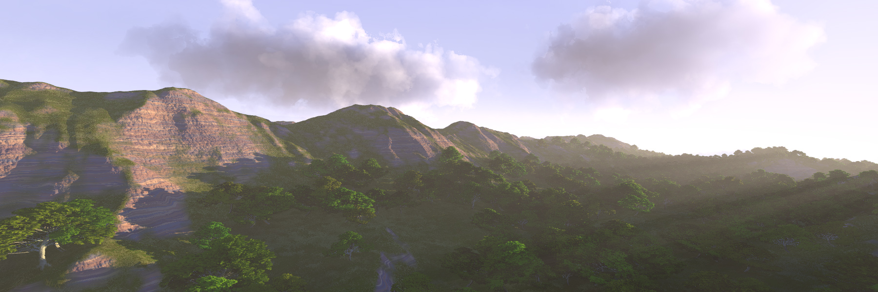

So I'm continuing on my acquaintance with media.  I have this scene where I have
a large sphere with sparse media which acts as atmosphere.  Then, I add an oval
which contains much denser media in order to make a cloud (which is within the
large sphere, of course).  I'm happy with the results of either media when used
independently, but in this picture you can clearly see the outline of the oval,
as if the oval cancels the other media with its own.  Can someone help me with
this?
My current solution is to define everything as a function, and then simply add
the functions together and just have one object with a complicated media
definition.  This works, but with the downside that I have to used more samples
on *everything* rather than just on the clouds which need the greater
definition.  This slows the render considerably.
(The samples are not turned up very high in this render, by the way)
Download 'hftester02.png' (204 KB)
Preview of image 'hftester02.png'

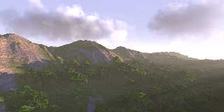

Well, I'm finding that despite the longer render times, using more samples
overall has some distinct advantages, such as the light streaks you get in this
render.  In reality, the media did not have nearly as much effect on the render
time as did the forest, once you add radiosity and AA.  I'm pretty happy with
the results here, although I'd like to change the shape of the clouds a bit and
perhaps add more.  The forest could use some more variety in the vegetation, as
well.

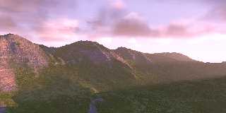

Well, here's some more tests.  This one was done with samples at 20 and took
about 36 min.  As you can see, there's no AA on this one, though.  Even at 20,
you can still see that "shelving".
I suppose one could cut up your atmosphere into segments, and have something
like:
intersection {
  sphere {0, AtmosphereSize}
  box {<-Size,0,-Size>, <Size, CloudAlt, Size>}
  ...samples 1,1...
  density {MediaFunction(x,y,z)}  //all using the same function
intersection {
  box {<-Size,CloudAlt,-Size>, <Size, CloudAlt+CloudDepth, Size>}
  ...samples 20,20...
But I suspect that in some way the tangent surfaces would show up.  Also, I'm
finding that changing the samples tends to affect the apparent density.  So the
density of the background might be obviously different in the two boxes.
> independently, but in this picture you can clearly see the outline of the oval...
Like others here, I've been grappling with this conundrum for a long time. Based
on *lots* of tests and experiments, I've come to some conclusions:
1) When there are two media objects, one inside the other (like your cloud oval
inside your atmosphere), the larger enclosing sphere's media samples value
completely overrides the smaller sphere's (and, I believe, its method and
intervals as well.) You can test this by giving your cloud media samples 1000,
and your atmosphere samples 1.  It will render lightning fast--and look
terrible! Reverse the order, and BOTH spheres' media take on samples 1000. Or
more generally, both spheres' medias seem to be treated as one, samples-wise.
This has caused me grief in the past, when I actually *wanted* the smaller
sphere to have a smaller samples count, just for the look.  But it can't be
done, unfortunately. As others have mentioned, the best (and only?) way of
eliminating or minimizing the small sphere's "visibility" is to keep pumping up
the samples count--in the larger enclosing sphere's media.
2)  When using two or more medias in a single interior statement (in a single
sphere, of course), there is a similar limitation.  Consider this:
interior{
     media #1{ pattern, samples, density, etc....}
     media #2 {pattern, samples, density, etc....}
In this case, media #2's samples completely override those in media #1. I.e.,
the final media samples override the one(s) before it. But on the upside, there
is no 2nd sphere shape "outline" to have to worry about.  And the two medias can
be translated within the sphere relative to each other, to a degree. With
appropriate color_maps for each media's density, and some media translations,
you might be able to get both your cloud(s) and atmophere this way, in one
sphere. Certainly not as easy as using two spheres, though!
