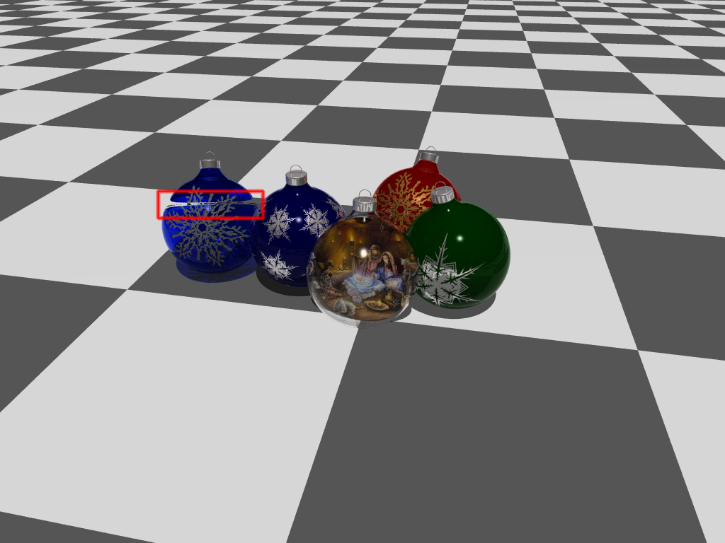

I've been working on a holiday themed offering, and it was going rather well.
But I've been having problems with a model I made, and I can't figure out why.
The bulb object is made from a lathe, using a linear_spline.  There are 3600 odd
 control points, placed with loops.  I used a debug statement to observe the uv
coordinates around the defect, and they tell me I'm seeing things, but the
defect remains, no matter what texture I apply.
Other than that, I'll let the attached image speak for itself.
Any comments or suggestions would be helpful.
A.D.B
 Very nice!
You could use sturm (more accurate root solver) in your lathes.
Marc
  Try 'sturm', or my MeshLathe macro (from http://lib.povray.org/ ).
The latter might even render faster...

I tried using Sturm.  It takes longer, and there's no appreciable improvement.
I suppose I could try the macro...
Is it at all possible that the problem comes from having too many control
points?  Current count is 3338 (I'll admit this may be overkill.}  Also, the
defect seems to move upward as the incident angle increases.
Thanks for the input,
A.D.B.

You can usually fix that with nail polish. Is it possible to render nail polish
in Povray?
It seems to me that the clear&gold ball with the Nativity scene on it is a
little out of round in some places. Did the glass get too hot and sag?
Leef_me

Could it be that you are seeing the plane through the ornament? All
other ornaments in the picture
don't appear to be as see-through as the one in question.Try to test
just that one ornament in slightly
different places on the plane to see if the defect moves or changes.
Anthony D. Baye wrote:
> > defect remains, *******no matter what texture I apply.*******
>> > the
Sometimes the normals on lathes get flipped, try using an
interior_texture and see if that has an effect.

I've tried everything that's been suggested, so far, but nothing - aside from
decreasing the number of control points - had any effect.  And decreasing the
number of control points messed up my uv_mapping.
I'm posting the code for the bulb, if anyone can help me, I'd be grateful.
