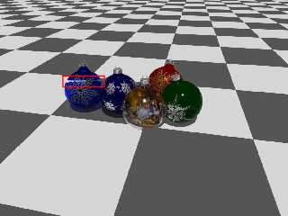

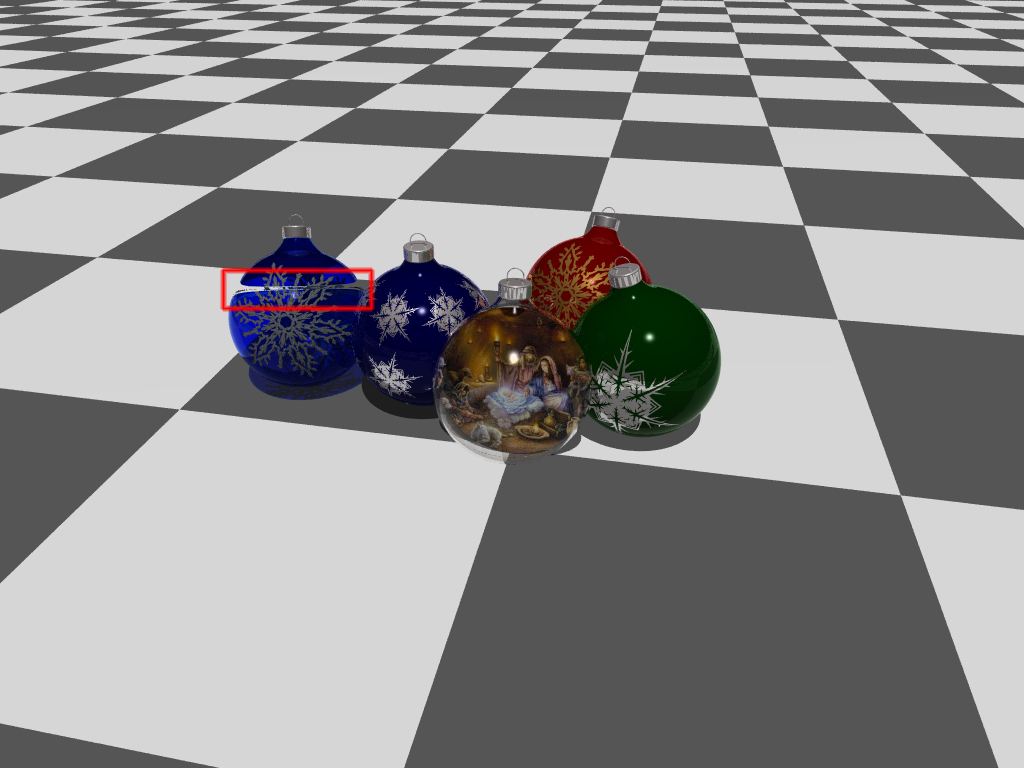

I've been working on a holiday themed offering, and it was going rather well.
But I've been having problems with a model I made, and I can't figure out why.
The bulb object is made from a lathe, using a linear_spline.  There are 3600 odd
 control points, placed with loops.  I used a debug statement to observe the uv
coordinates around the defect, and they tell me I'm seeing things, but the
defect remains, no matter what texture I apply.
Other than that, I'll let the attached image speak for itself.
Any comments or suggestions would be helpful.
A.D.B

From: M a r c
Subject: Re: Just in time for Christmas, Hopefully
Date: 15 Dec 2007 02:47:03
Message: <47638677$1@news.povray.org>
message de news: web.47635f3fd0e9aafab80d39510@news.povray.org...
 Very nice!
You could use sturm (more accurate root solver) in your lathes.
Marc
From: Warp
Date: 15 Dec 2007 06:30:54
Message: <4763baee@news.povray.org>
  Try 'sturm', or my MeshLathe macro (from http://lib.povray.org/ ).
The latter might even render faster...
From: Anthony D  Baye
Date: 15 Dec 2007 13:40:01
Message: <web.47641f2a33ad2e29b80d39510@news.povray.org>
I tried using Sturm.  It takes longer, and there's no appreciable improvement.
I suppose I could try the macro...
Is it at all possible that the problem comes from having too many control
points?  Current count is 3338 (I'll admit this may be overkill.}  Also, the
defect seems to move upward as the incident angle increases.
Thanks for the input,
A.D.B.
From: Warp
Date: 15 Dec 2007 17:05:05
Message: <47644f91$1@news.povray.org>
  It is. Use a dozen or so control points and a smooth spline.
From: Leef me
Date: 15 Dec 2007 18:30:01
Message: <web.4764628b33ad2e29892adb1d0@news.povray.org>
"Anthony D. Baye" <Sha### [at] spamnomorehotmailcom> wrote:
> A.D.B.
You can usually fix that with nail polish. Is it possible to render nail polish
in Povray?
It seems to me that the clear&gold ball with the Nativity scene on it is a
little out of round in some places. Did the glass get too hot and sag?
Leef_me
From: Art Flint
Date: 16 Dec 2007 09:39:41
Message: <476538ad@news.povray.org>
Could it be that you are seeing the plane through the ornament? All
other ornaments in the picture
don't appear to be as see-through as the one in question.Try to test
just that one ornament in slightly
different places on the plane to see if the defect moves or changes.
Date: 16 Dec 2007 10:35:01
Message: <web.476544da33ad2e29b80d39510@news.povray.org>
> > defect remains, *******no matter what texture I apply.*******
From: Tim Attwood
Date: 16 Dec 2007 16:08:22
Message: <476593c6$1@news.povray.org>
>> > the
Sometimes the normals on lathes get flipped, try using an
interior_texture and see if that has an effect.
Date: 17 Dec 2007 01:00:01
Message: <web.47660fa633ad2e29da3f66bb0@news.povray.org>
I've tried everything that's been suggested, so far, but nothing - aside from
decreasing the number of control points - had any effect.  And decreasing the
number of control points messed up my uv_mapping.
I'm posting the code for the bulb, if anyone can help me, I'd be grateful.
