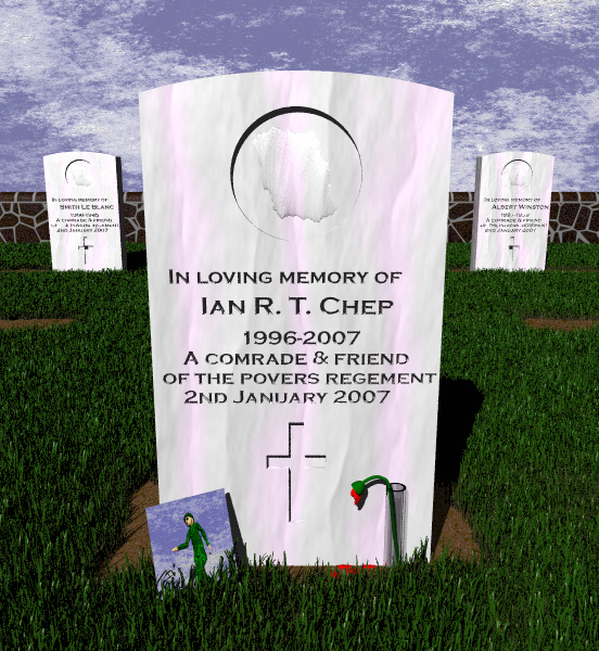

Ok so I realise that I am giving the game away as to how my 'Before and
after' entry is going to look however there is something not quite right
about it yet and I cant figure out what it is. So in desperation I have to
reveal my entry in the hope of suggestions as to what is possibly wrong!
Any comments welcome about how I can improve this to be better for the
competition. Also apologies if I dont use your ideas however I am currently
revising for exams so trying to persuade myself to study rather than partake
in other more enjoyable activities.
Malcolm

From: Tek
Subject: Re: Before and after WIP
Date: 14 Apr 2007 14:14:30
Message: <46211a06@news.povray.org>
Cool concept!
My suggestions:
Regiment is spelt regiment not regement!
The lighting is not very well balanced, I suggest you add global_settings
{ assumed_gamma 1 } and use some ambient light or radiosity (pitch black
shadows look wrong with a blue sky).
The material on the gravestones looks strange, it has pink stripes and
they're brighter than the sky!
The text is engraved too deeply, real grave stones enscriptions are only a
few millimeters deep.
The wall at the back is just 2 flat colours, it should have a normal map on
it and shouldn't be pitch black, e.g. pigment { rgb .5 } normal { crackle -1
form <1,0,0> }
The sky blue colour is a bit purple, I suggest you add a little green to get
a more cyan-blue shade.
I like the grass & soil, though I think the soil should be darker than the
grass but improving the lighting will help you see how they look.
Tek
http://evilsuperbrain.com
"milco2006" <mil### [at] hotmailcom> wrote in message
news:web.462113eabdf9d2e4d178c7da0@news.povray.org...
> currently
> partake
> Malcolm

From: Christian Froeschlin
Date: 14 Apr 2007 20:25:49
Message: <4621710d$1@news.povray.org>
> competition.
The sky looks promising, but has very fine structure. Maybe you
can try scaling it up a bit. Also, the composition might feel
more natural if the setup would not be perfectly symmetrical
and the camera a bit more distant from the tombstone.

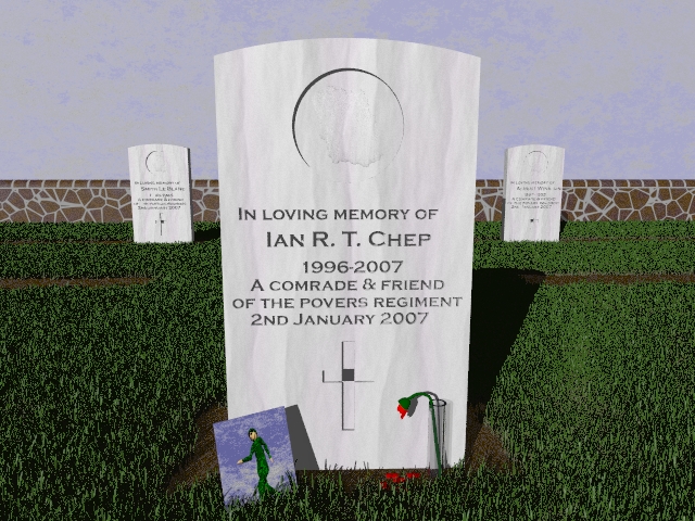

From: milco2006
Date: 17 Apr 2007 10:35:02
Message: <web.4624da622cd286fb48808b530@news.povray.org>
I have played around with my lighting a bit however in making the gravestone
look better it has dulled the clouds and the grass seems to change a lot. I
have posted the picture again below so you can see the changes I have made.
I still havent worked on wall textures as I have been busy getting back to
uni for the last few days.
Any further advice would be much appreciated however I realise you have a
real life too so no worries. This is only my third attempt at a full scene
for an IRTC type thing and so not had much experience yet. Also the fact
that until now lighting has not played a big part means that I am not very
good at it yet and I guess, like the rest of povray skills, it just comes
with practice.
Thanks Tek,
Malcolm

Is that an actual hole at the center of the crosses, or is it an artefact due to
coincident surfaces?
> Alain
> 'Honesty is the best policy, but insanity is a better defense'
It is an artifact that I havent yet succeeded in getting rid of. I reckon if
I just move the surfaces around a little it will go away, however at about
20 minutes to render the scene completely each time I wasnt feeling
inclined to try when I noticed it just before posting my last message!
Malcolm
