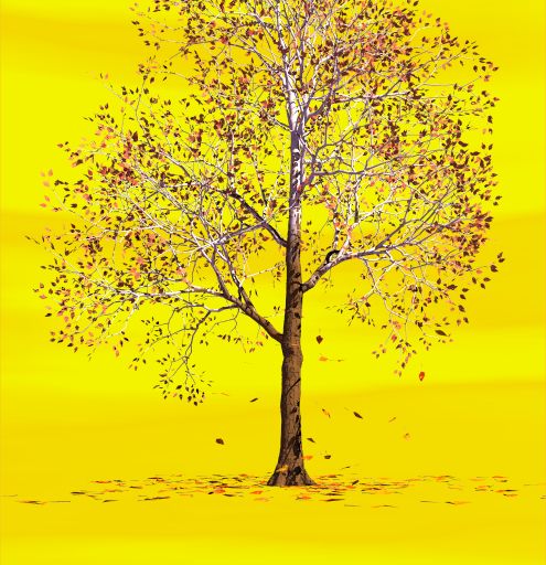

I have been working on a macro that creates a tree.  My goal is
photo-realism, so I appreciate your comments and suggestions.  The tree is
modeled entirely in POV using recursive macros. I've attached a few of the
recent results.
Download 'tree13-10-24s.jpg' (133 KB)
Preview of image 'tree13-10-24s.jpg'

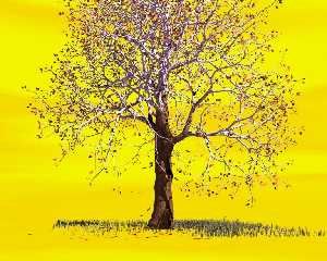

Download 'tree v13-ds.jpg' (71 KB)
Preview of image 'tree v13-ds.jpg'

The fading of the bark adds a lot. The leaves look too flat to me, but that
is only on a close examination. The same with the bark on the trunk - it is
a little flat. Still, on first glance it was much better than any other
recursive tree I've ever seen. Same on the second and third look, too. Nice
work.

Wow, they're very good. I like how so many POV-artists do it themselves,
even when similar things have already been developed, because there are
always advantages starting fresh. It's great to have so many technically
savvy artists!
Hmm, photo-realism from what distance? Up close can be a demading challenge
indeed.
The falling leaves in both images are an especially nice touch. The
large-trunk brown bark texture is very real-looking to me, and the leaves
are attached to the branches. The overall trunk looks realistically curved
and curled in both images.
Criticism: (w/grain of salt, please)
The last level of twiggy recursion isn't quite fine enough, to my eye; it
seems like it should look busier and noisier around the tree margins. The
light branch and twig texture seems a little too bare, but that may be
realistic. The texture transition doesn't show peeling-up bark like a
sycamore or such tree has.
Overall, though, my only major criticism is that the branch and twig
sections are too straight. Add more small-scale wiggles and irregularity if
you can.
Oh, also- not that it affects the tree realism- but the ground doesn't show
any shadow that I can see. ??
Very good job. Keep it up!
-Stefan Sittler

Very impressive.  I've started on a project such as this a few times, but I always get
a headache
from the complexity and stop.
I'd love to see the method to your madness.  Are you planning to post the code?
Kyle

Ooh - lovely.
How long did it take to parse and render? And what are your machines specs?
And... are you going to post the code?
-Nekar Xenos

Thanks for all your generous input!  I'd like to implement some of the
changes you suggested and get my code cleaned up before I post it.
"Nekar" <ger### [at] rpmmagcoza> wrote:
> Ooh - lovely.
I render on a 2 Ghz PC; to get a tree with decent enough complexity it
usually takes about 2-3 minutes to parse and then renders at around 300 -
500 pixels per second.
(btw, I didn't actually bother to make an object for the ground other than
the leaves, so there's no shadow.)

VERY impressive!  And very timely and inspiring (for me):  I'm currently
working on a similar idea, using isosurfaces...to get real bark detail
mostly,  but also to "bend" the trunk and make it "bumpy", and to create a
lower trunk shape that mimics the way the roots spread out.  Will post an
example soon.
Haven't yet thought about branches--which your macros do a *beautiful* job
with. Congratulations on your excellent code design! Like others, I would
very much like to see it. Please post when ready.  :-)

I am curious about this: Isn't your render time very slow for an isosurface
tree? And what about planting a forest with them?
I agree!!

When you have very detailled trees, you only use 1 or 2, maybe 3. For the
background trees, it's usualy beter to use mesh trees.
Not all isosurfaces are very slow. It depend on it's complexity and gradiant.
