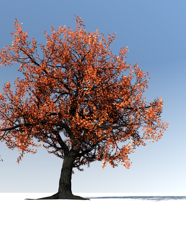

My wife and I do some amateur photography, and have done a good job of
decorating our house with prints. The dining room has been an issue though.
I would love to put a three or four panel image up showing a large solitary
oak tree in winter, summer, fall, and spring. I can imagine it quite well,
but can't seem to find a good subject despite always keeping my eyes open.
I was thinking this weekend, heck, why not make my own reality. I'm getting
the hang of semi photo-realistic renderings with lots of detail in POV. I
may as well put it to good use.
Here are the fruits of my labor so far. I think I've got something that's
pretty close to realism for the focus of my image. I was hoping to get some
criticism it.
It's an xfrog model with texture maps applied. Rendered with a little
radiosity and one light source. One problem I'm having is getting the look
of filtered light through the leaves. I get some unrealistic dark spots
under the canopy. Making the leaves partially transparent doesn't seem to
do much unless I over do it. Then the leaves on the fringe are too
transparent. Any ideas?
Also, I mentioned above the 4 seasons idea. What can I do to differentiate
spring from summer? I'd like 4 distinct images. I was thinking a foggy
picture for spring with some small patches of snow?
Download 'oak_tree_fall.jpg' (319 KB)
Preview of image 'oak_tree_fall.jpg'

I like the idea! I've had a similar problem with black spots on leaves - you
might try increasing the max_trace_level.
For spring, you may want to add
- longer shadows
- shorter grass (and lighter in colour)
- leaf buds/smaller leaves
Rob.

 you can try to put 2 copies of the leaves slightly drifted in position, one
with no transparency and "no-shadow", the other with shadow but "filter all
1" in the image_map statement.
Marc

The tint of leaves in spring are very different from those in summer.
Depending on the type of tree, you may get slightly rusty green to pale
yellow green in spring, while those same trees show a much darker green
during summer.
Nice project! I think it will look spectacular on your wall!!

Perhaps bright green buds instead of leaves for spring?
-tgq

Wow, very nice picture. I love the look of your tree, but I don't know how
to get better-looking leaf transparency. Good luck on that- although it
looks very believable to me right now. Perhaps faking it with a little
ambient (glowing in radiosity) on the leaves? --might look a lot worse
though. Or you could try a no_shadow fill light lighting only the tree
(light_group I think).
As for distinguishing seasons, in my neck of the woods grass is lighter and
greener in the spring, darker and browner in the summer. Also (as someone
said) you may be able to get leaf buds in the spring, and smaller leaves,
maybe some acorns (If it's a good POV-year :) that fall to the ground in
summer. Mostly I think of the lighter green and flowering in the spring, if
there are any other plants in the picture.
(off-topic) I downloaded the source to your image from last IRTC and have
been playing with it- your rust textures are really, really good (and
clever). Amazing work.
I bet that tree-radiosity took a while, eh?
Looking very good, good luck!
-Stefan

None from me. It is really great!

In summer I expect a tree with lots of green leafs. In spring I expect
small leafs with buds. In winter: If therer were leafs I were in Florida.

How about flowers on the tree for the spring picture?

In spring the leaves are a little smaller and a somewhat lighter green.
During the sumer, the leaves grow a darker green, maybe with sume blueish
shadeing. They are full grown and more opaque.
Longer shadows in spring, shorter ones for sumer.
