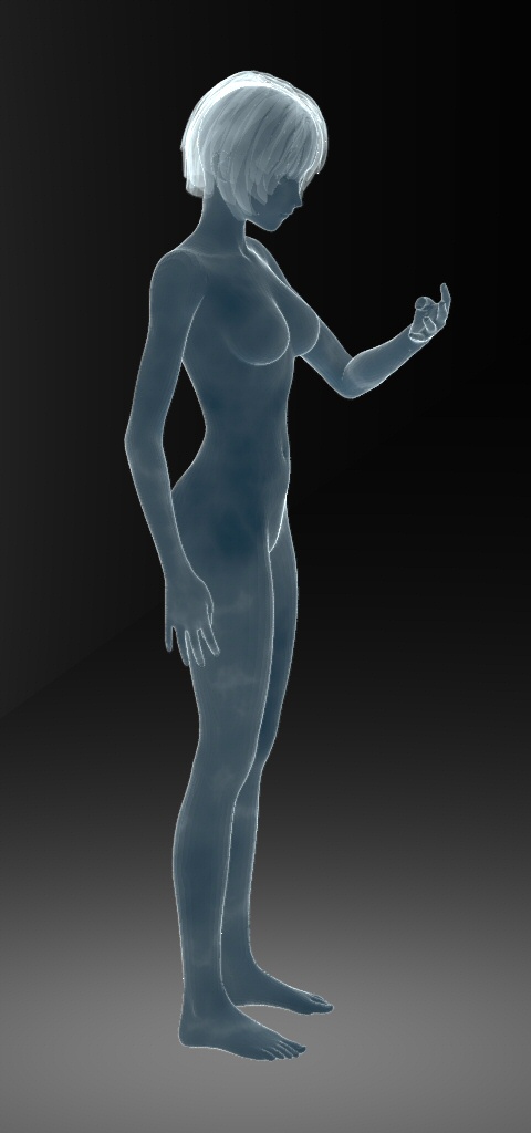

Here's a development picture from my forthcoming (hopefully!) IRTC entry for
this round. I was going to hold off posting anything till I'd finished it,
but this is such a strange bit of modelling I felt I had to share it.
It is, of course, DAZ's Aiko, but in spectral form. I think I've been
incredibly cunning with this image, but this could be wishful thinking and
maybe many of you will see what I've done at a single glance. Anyway, I'm
going to be mysterious and not explain how this was made until I come to
write the image description for the competition.
I need to make some changes. The pose is a bit flat and will be improved. I
want the light to be slightly bluer, and the coruscating patterns a little
sharper. I may well use different hair for the final - her features are
somewhat obscured. And finally, there are some white pixel-sized artifacts
dotted around the model, which I don't think I can do anything about.
Making the ghost brighter will help mask them; failing that, it'll be a
post-process to remove them which is of course against The Rules.
Feedback appreciated!
Bill
Download 'ghostgirl.jpg' (52 KB)
Preview of image 'ghostgirl.jpg'
From: Roman Reiner
Subject: Re: Ghost girl (very mild nudity)
Date: 18 Sep 2006 08:20:00
Message: <web.450e8e23d89b4a7a5cf0fa1e0@news.povray.org>
Concerning the artifacts, did you try to increase the max_trace_level?
About her appearence in general, how about making her surface fully
transparent and filling her with emitting media instead? This would ofc
increase the render time but i guess it would look better. Control the
density to obtain a similar pattern!
Regards Roman
From: Bill Pragnell
Date: 18 Sep 2006 09:10:00
Message: <web.450e9a7fd89b4a7a731f01d10@news.povray.org>
Yes, with no joy. I believe the spots are caused by gaps in the mesh which
cause the media to appear infinitely deep at those points, but there's
little I can do about it. They look similar to the coincident surface
artifact, but manifest themselves much more rarely, seemingly at random
locations depending on render resolution, etc.
I've tried that, and although the results are interesting, I prefer this
'glowing outline' look! :-) I have some more experiments in mind, however.
Bill
From: Stephen
Date: 18 Sep 2006 10:00:00
Message: <web.450ea5e5d89b4a7af1cb1e660@news.povray.org>
Have you tried to subdivide the mesh in Poseray and change the weld
tolerance?
Stephen
From: Bill Pragnell
Date: 18 Sep 2006 10:10:01
Message: <web.450ea822d89b4a7a731f01d10@news.povray.org>
> tolerance?
No... I'll give it a go, although the Aiko3 mesh is pretty hi-res already!
Might make my PC chug a little. (Tough, that's what it's there for) :)
Bill
From: Stephen
Date: 18 Sep 2006 10:20:00
Message: <web.450eaae7d89b4a7af1cb1e660@news.povray.org>
> > tolerance?
> Bill
emitting media and see if there are any leaks. Then decrease the weld
tolerance to close them up.
Stephen
From: Florian Siegmund
Date: 18 Sep 2006 13:55:00
Message: <web.450edc7ed89b4a7a7758051a0@news.povray.org>
Looks very pretty, though. I think I can imagine how you did the light
outline, because I by myself wrote a scene in pov-ray some thime ago where
I experimented with "x-rays", and that looked similar. I don't know how to
remove the bright pixel dots, because I didn't have this problem. But a
thing that you could do is changing the pose of the left hand a bit,
because it looks strangely twisted. (Ouch!) But all in all, good work :)
Florian
From: Orchid XP v3
Date: 18 Sep 2006 14:57:56
Message: <450eec34$1@news.povray.org>
Mild nudity? She's completely transparent! LOL. ;-)
Very pretty though... The middle part doesn't look quite "right". I
think it's the two legs overlapping and making that part extra bright.
Sure, that's physically correct; doesn't mean it will _look_ right...

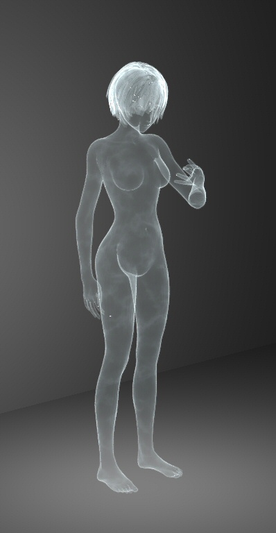

From: Bill Pragnell
Date: 18 Sep 2006 17:30:01
Message: <web.450f0f35d89b4a7afb2e2dd30@news.povray.org>
Right, here's an opaque version. I think this looks better - the body parts
visible through the previous version *were* a little confusing. I'm not
sure if this looks as 'ghostly', though... I think I'll have to see it in
context! Next stop, pose.
Bill
Download 'ghostgirl2.jpg' (70 KB)
Preview of image 'ghostgirl2.jpg'
Date: 19 Sep 2006 03:58:03
Message: <450fa30b$1@news.povray.org>
news:web.450f0f35d89b4a7afb2e2dd30@news.povray.org...
> parts
Yes, in a sense this looks better. I have some concern about the hair
though, especially in this latest image, as it show too much the 'shell' it
is in fact. Being bald would almost look better, but that would change
totally the context.
