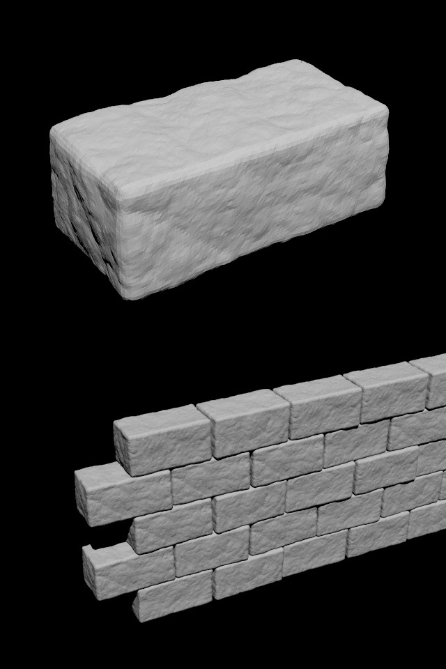

Bricks and building slabs in general can be difficult to simulate with
textures. Of late, I've taken to building structures from discrete brick
objects, using random selection from a small array of differently textured
mesh bricks to cut down on memory usage. This can look great, especially
when the individual bricks can then also be randomly displaced or rotated
very slightly to give a sense of irregularity.
However, my simple bricks don't look so good close up, and I'm a little
dissatisfied with using isosufaces as substitutes, partly because it's
difficult to avoid sharp corners, but mainly because of the severe
speed/memory issues for large numbers of bricks. To this end, I've been
working on a macro to create boxes with rounded edges and corners purely as
meshes, together with an isosurface-like surface perturbation. The image
below shows two examples, using a granite pigment function. Obviously, this
is a simple example, but in principle any function can be used on the
surface, and the box can be given any dimensions and location. One could
also colour the bricks based on the pigment function used to generate the
surface (might have to take a look at that sandstone... :) ).
Once I've tidied up the code and made it more usable I'll post the source,
if anybody's interested!
Bill
Download 'isobricks.jpg' (113 KB)
Preview of image 'isobricks.jpg'

How about using smooth_triangles instead? In the example you showed, it
looks like you used "flat" triangles. That should make them look
smoother, and probably better, at close range.

This is very true. However, I can't immediately see a way of generating the
normals which wouldn't take an order of magnitude more work on my part!
The example mesh was intentionally low-res for illustrative purposes. In
practice, I think it would be much easier simply to increase the resolution
of the mesh until the triangles disappear. For really close-range shots, you
wouldn't need many bricks. For long-range shots, lower-res bricks would do
fine (the bricks in the wall shown above have the same res as the single
brick, for example). For a mixture, you'd want to alter the resolution
according to distance from the camera. All of this can be aided further by
using copies picked from small arrays of pre-declared meshes to save
memory.
Luckily, mesh resolution is one of the parameters in my macro!
Bill

generating the normals isn't all that hard.
Each vertex is touched by three or more triangles.
For each triangle you take a vector perpendicular to it's plane,
of length proportional to the length of that triangle's two edges that
intersect with the point in question (I think that's vcross() not sure
now because it's been a while).
Then you average those vectors to give you the normal at that point.

It wasn't the actual calculation that was putting me off, just the amount of
thought and coding required to implement it! It would indeed be vcross(),
and there's VPerp_To_Plane(v1,v2) in math.inc, although I fail to see the
difference between them to be honest.
Each vertex is touched by eight triangles, although I could probably get
away with averaging the normals to the four non-planar quadrilaterals
touching each vertex (which amounts to the same thing, at least in my
head). I'm going to have to re-write my main loop...
Well, I've thought about it now, so obviously I'm not going to be happy
until I've done it! :)
To be continued...
Bill

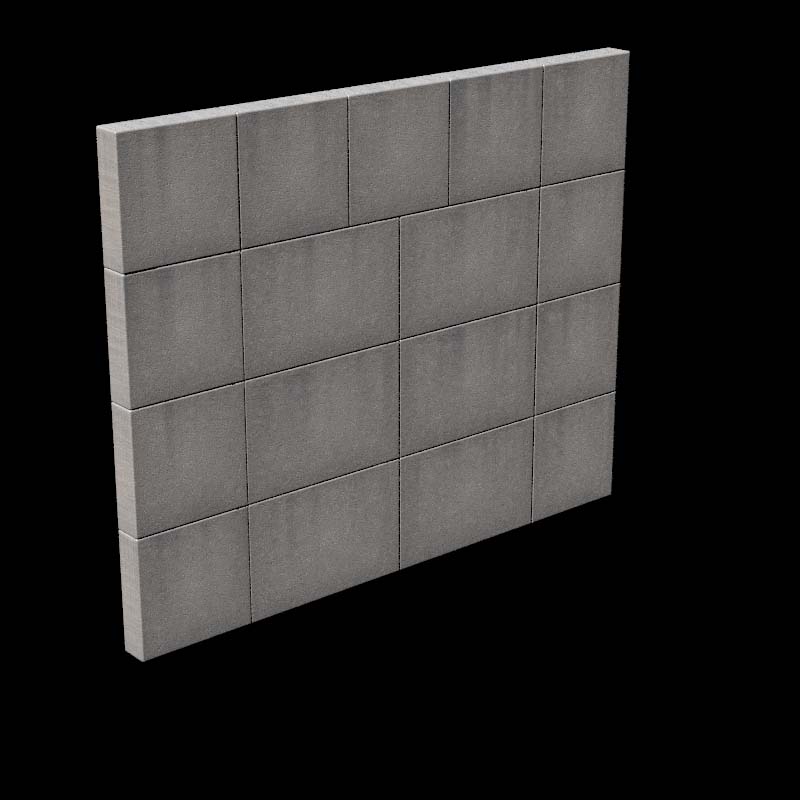

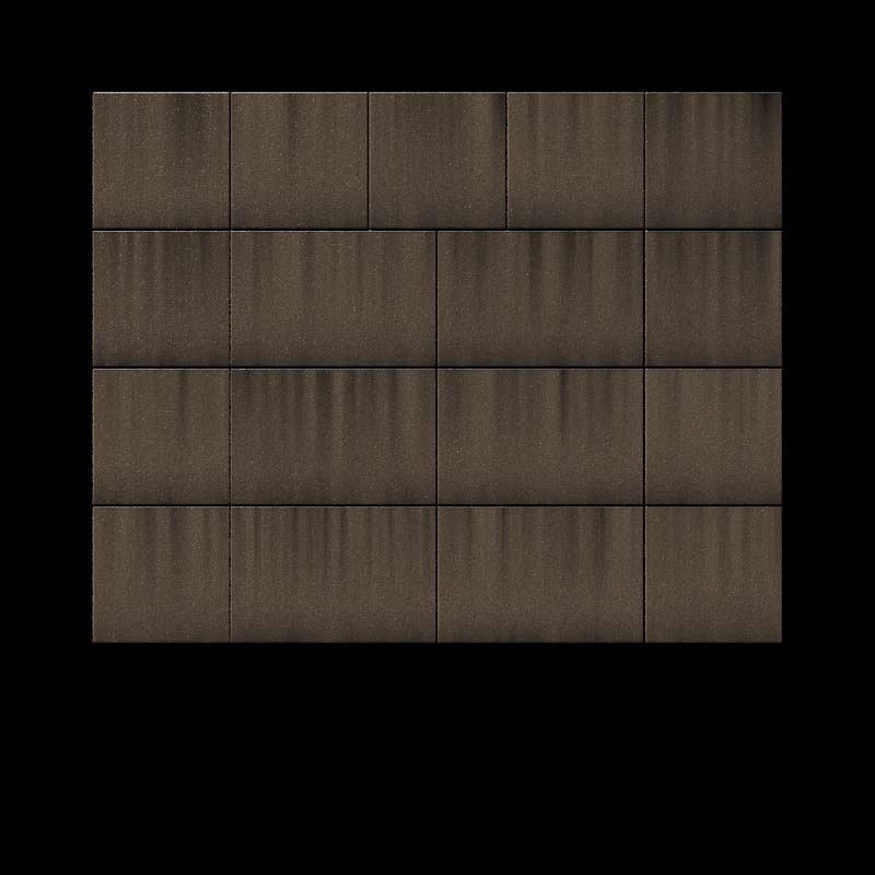

FWIW a while back I was playing a bit with getting the weathering in
face stones.  The examples attached are in fact iso's using round box
macros from iso_csg.inc with some displacement, but the streaking
effects might interest you.
Download 'img.2009.jpg' (52 KB) Download 'img.2012.jpg' (54 KB)
Preview of image 'img.2009.jpg'
Preview of image 'img.2012.jpg'
