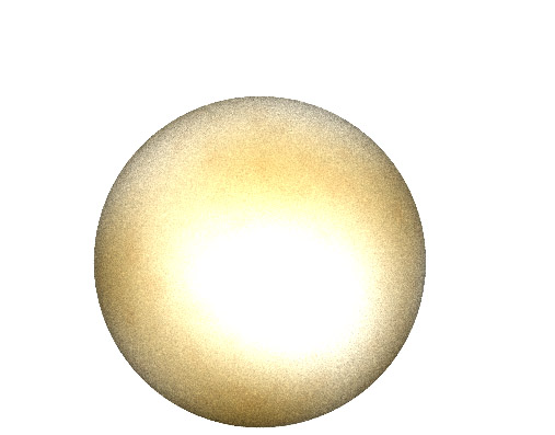

Well the opening pitches have been thrown this year..
I have been trying to find a decent baseball in a current (3.6?) POVRAY
version for ages with not much luck.  Someone posted one that was close
back in old posting in p.b.i.
http://news.povray.org/povray.binaries.images/thread/%3C38AFF53B.4A483B33%40stud.ntnu.no%3E/?mtop=12
; however, I didn't see all the source posted and what was posted seemed to
be some other related render (maybe MEga PoV?). Somewhere slse in the
newsgroup someone posted a link to a tutorial describing how to make a
baseball seam but the link is now broken.
Anyway can we pool our resources and make a reasonable baseball the
community can use?  I would think we can leave off any logo that involves
an image map for now unless someone is industrious.
Sadly, so far I have the basic drity leather ball in the scene. It seems a
little more speckled than the original I based it on for some reason and
making it a much brighter scene didn't help much.
 I imagine blobing could be used to add the raised part at the seems but how
to get the red stitches is beyond me.  Here is what I have:
//baseball attempt
//modified from
#declare AreaLightOn = off;
#include "colors.inc"
// radiosity (global illumination) settings
global_settings {
  radiosity {
    pretrace_start 0.08           // start pretrace at this size
    pretrace_end   0.04           // end pretrace at this size
    count 35                      // higher -> higher quality (1..1600) [35]
    nearest_count 5               // higher -> higher quality (1..10) [5]
    error_bound 1.8               // higher -> smoother, less accurate [1.8]
    recursion_limit 3             // how much interreflections are
calculated (1..5+) [3]
    low_error_factor .5           // reduce error_bound during last pretrace
step
    gray_threshold 0.0            // increase for weakening colors (0..1)
[0]
    minimum_reuse 0.015           // reuse of old radiosity samples [0.015]
    brightness 1                  // brightness of radiosity effects (0..1)
[1]
    adc_bailout 0.01/2
    //normal on                   // take surface normals into account [off]
    //media on                    // take media into account [off]
    //save_file "file_name"       // save radiosity data
    //load_file "file_name"       // load saved radiosity data
    //always_sample off           // turn sampling in final trace off [on]
    //max_sample 1.0              // maximum brightness of samples
camera {
  location <0, 10, -36>
  direction 1*z
  look_at <-.2, 0, 0>
light_source {
  <0, 20, -70> color White *1.6
  #if (AreaLightOn=yes)
  area_light 75*x, 75*y, 75, 75
  adaptive 1
  jitter
  #end
light_source {
  <80, 120, -200> color White
  area_light 10*x, 10*y, 5, 5
  adaptive 1
  jitter
  #end
plane {
  z, 2.5
  hollow
  pigment { White }
  finish { ambient .5 }
# declare ball=
pigment { bozo
    colour_map {
        [0 rgb <255,249,227>/255]
        [0.5 rgb <233,255,227>/255 ]
        [0.8 rgb <219,205,150>/255 ]
        [1 rgb <255,249,227>/255]
# declare darkness=
pigment { ripples
    colour_map {
        [0 rgb 1]
        [0.8 rgbf <131,105,55,90>/255 ]
        [1 rgbf 1]
# declare R =3;
sphere {<0, 0, 0>, R*3.05
    texture{pigment {ball}}
    texture{pigment {darkness}}
    finish {specular .1 roughness .05}
    normal { granite 0.5  scale .001 }
Download 'basic baseball from old povray newsgroup.jpg' (31 KB)
Preview of image 'basic baseball from old povray newsgroup.jpg'

Not bad guess at the texture.  He oiously also layed in some scuffs with
a large bumps or dents of some such.
Most of his code there looks straightforward enough to me.  He is using
a patched version that circulated for awhile that allowed you to replace
the #declare with a $ sign.  The eval_3d_spline macro is pretty tame as
I recall.  But all of that is obviously just a way to get the raised
seams.    But what we don't have is the actually spline definition which
is at the heart of the path of the seam on the sphere.
I recall there was a nice tutorial circulating in the Wings3D community
that demonstrated how to model the shape of that style of seam (which
exists on other sports balls too)  It took advange of how subdivision
smoothing worked against a cube as I recall.  But I can no longer find it.

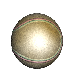

Wow, that spline is great!!!  We are really close.  Thanks for all your
help!!
Okay, so I integrated everything we have so far and put it in the same
thread in p.b.scene file. It looks a little elongated in the y direction.
I don't quite now why but it may be the camera and the "up" or "direction"
I left from the older scene. I rendered it at 2960 by 1920 so the ratio was
the same as 640/480 like in the camera definition.
If I could bother you some more...Part of the code is stil beyond my ability
though.  Did you envision the "cross" as the part of the code allowing me to
walk the spline and make a red cylinder between theparallel set of points on
either side of a seam to make red stiches along the seam?
Here is the work in progress so far:
Download 'baseball with spline wip.jpg' (56 KB)
Preview of image 'baseball with spline wip.jpg'

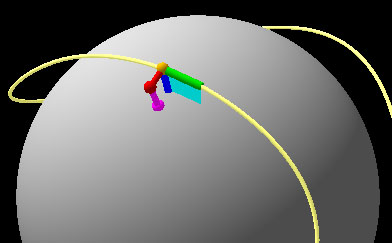

Yes but it is also how I made the parallel bunching along the seam.  The
vcross gives the cross product.  The cross product of two vectors gives
a vector that is perpendicular to the plane of the two vectors you take
the cross product of.
So here's how it works:
In my illustration you can see that the actual spline rides above the
surface of the sphere. (Jellby's contribution my eliminate the need for
this but...later* )
The orange ball is some point on the spline as we loop along it:
SeamSpline(I/Grain)
The green cylinder is a segment of the spline which I called Seg
SeamSpline(I/Grain)-SeamSpline((I-1)/Grain)
The blue cylinder runs perpendicular to the ball's surface from
the orange ball which I call Norm
The cyan plane is the plane that the two vectors Norm and Seg lie in
The red cylinder is the cross product of the Norm and Seg vectors and
is therefore perpendicular to the cyan plane.
I use it to locate a point along-side the spline, the red sphere
Now you see in the code that I use the trace() function.
This function finds the point where the magenta cylinder intersects
the ball's surface, marked by the magenta sphere.  The magenta cylinder
is nothing more that the path from the red sphere to the center of the
ball.  The magenta sphere is the same as the spherical blob components
that I use to make the lumps along the seam.
* But now with Jelby's contribution it is probably possible to define
points directly on the surface of a sphere, thus obviating much of this.
Download 'img.0000.jpg' (25 KB)
Preview of image 'img.0000.jpg'
