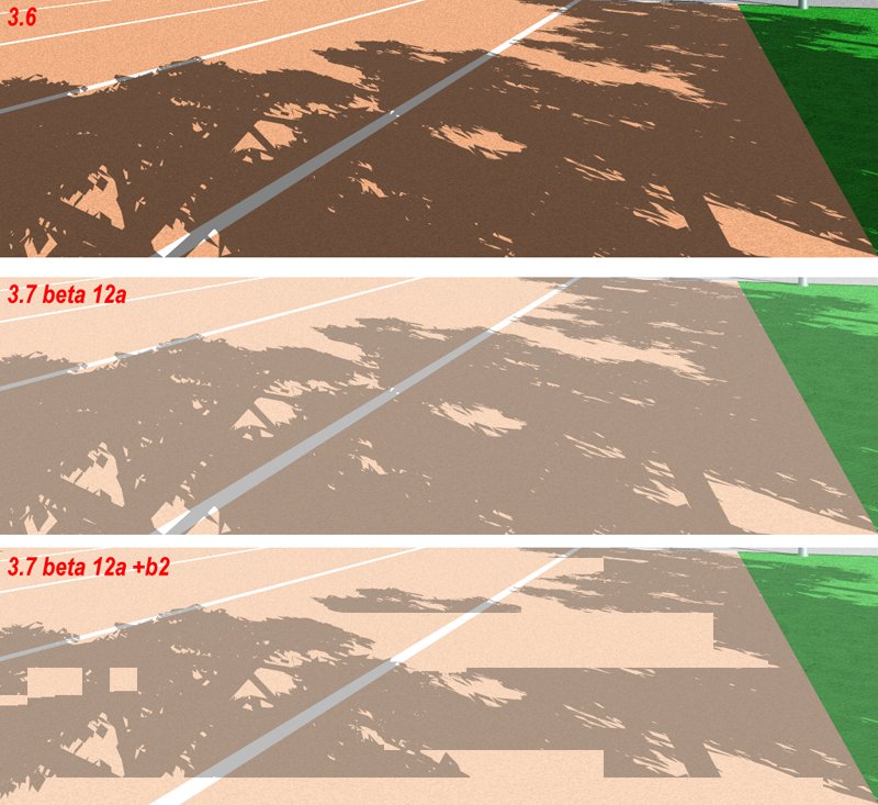

There are some artifact when using bounding method +b2 with the current beta
12a version. Also it seems that fog gives quite different result in the
scene. Maybe it is intentional redesign of this feature, I don't know.
// the definition of fog in the scene
fog {
    fog_type   2
    distance   50000
    color      rgbt <0.8,0.9,1.0,0.0>
    fog_offset 300
    fog_alt    900
"Square" artifacts appear in the shadows of the trees. They are created with
MeshTree macro by Paul T. Dawson.

From: Lance Birch
Subject: Re: 3.7 beta 12a and +b2 option
Date: 3 Apr 2006 09:12:29
Message: <44311f3d@news.povray.org>
"Przemek Loesch" <nomail@nomail> wrote in message
news:web.44311081c37f5c7db0aac12c0@news.povray.org...
Without a complete scene file it's pretty difficult to narrow down, but does it
happen when you run the beta with the /THREADS 1 command line switch?
This unusual behaviour may already have been fixed however, as a few similar
artifact problems were experienced by other people (see povray.beta-test, thread
"POV-Ray v3.7.beta.12a available.", and in particular posts by LoneStar) which
have now been corrected for the next release.
Lance.

From: Przemek Loesch
Date: 4 Apr 2006 05:00:00
Message: <web.443234b1761b626fb0aac12c0@news.povray.org>
I'm unable to narrow down the scene which would still generate this
artifact.
The scene is quite complex. Beside the trees there are many meshes imported
with PoseRay, including several cars, trucks, and buildings. I've tried to
switch off these elements step by step, but everytime the artifact and the
place where it occurs has changed. I think this behavior is related to the
complexity of the scene rather then to specific position and geometry of
the objects.
By the way - the brighter appearance of the images rendered by 3.7beta had
nothing to do with the fog - I was mistaken. I've noticed also that it was
rendered correctly when I've put directive #version 3.5 (but #version 3.6
gives the same brighter result).
